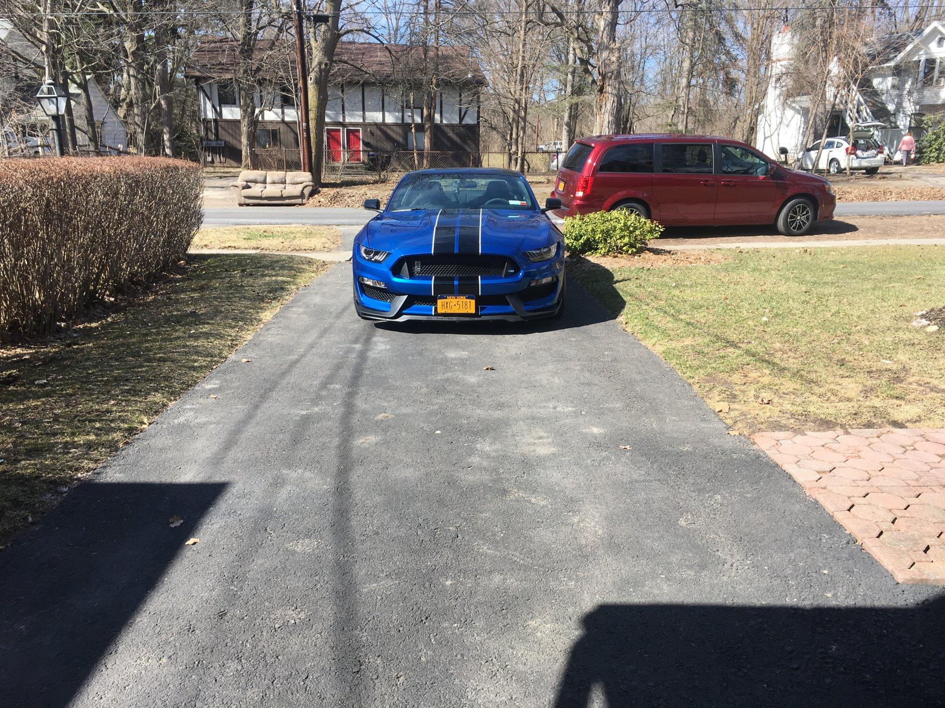

I saw from another forum member that he used “Magic Sliders” to protect his front splitter. They are 1 inch discs that you place on the feet of your chairs to protect your floor. I went ahead and cleaned the underside of the splitter with IPA and stuck them on. I did not paint them because I did not want to spend the time doing so until I was certain that they would stay. As odd as this may seem, the little bit of white that is showing is growing on me. Eventually I probably will color them black.

How much does the guy want for the couch ?:facepalm:
The disadvantages of living across the street from rental property. When they move out they leave piles of shit. The shit I already cleaned up and threw away and it’s not even my property.

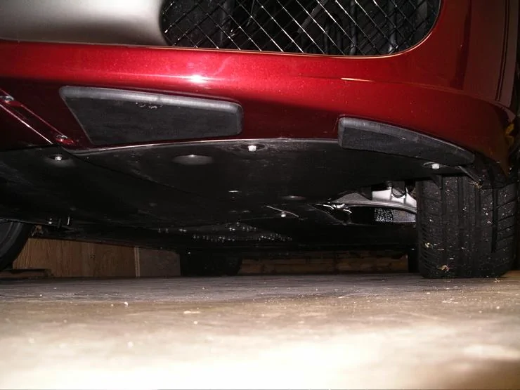

I lied. Thanks to a great search function on another forum I found photos. Here is one:

Ahh, those are HUGE. Didn't think of trying to use anything that big. Very interesting.
Where'd you source the material? How'd you cut them? Used 3M auto tape?
i use the magic sliders. got 8 of them under the front splitter. painted them black but they've taken a beating. still sticking real good. good $8 spent.
These are what I used that disintegrated in 1 session at COTA :cwl: I think they would work well on the street, tho.
Where'd you source the material? How'd you cut them? Used 3M auto tape?.
I looked up plastics suppliers and found more industrial oriented places that were happy to sell me part of a sheet. It is expensive (I recall like $50 for a 4' x 4' piece) but that makes a lot of plates. The key to this material is its very high lubricity (it is functionally slippery) and high impact tolerance. It also can be shaped somewhat by heat. Those pictured plates are flat, but for other cars I'd cut the plate, then used a floor jack, some plywood, and a ziplock bag filled with sand and would heat the plate in the oven, rush it to the garage, and press it against the undersurface of the bumper. The problem is the material "springs back" a bit but a heat gun and some hand forming solved that. My next evolution was using two part epoxy modeling clay--I'd press that into the bumper with a floor jack (with some plastic wrap between them) to create a reverse mold--I'd then drill and tap that, and screw a skid plate to the mold, stick it in the oven, and gradually tighten the screws to draw it into the mold. Worked great.
The material cuts easily with wood cutting tools (jig, circular, band, or table saw). It also machines well, so I used a router and a round over bit. 3M may have changed the name of the tape, but it used to be "automotive attachment tape". It is used by OEMs to attach spoilers, flares, etc. It is super super tough, but it has a thin foam core so to remove something attached with it you can used something like 50 pound monofilament fishing line to "saw" through the foam core. Then the tape bit can be rolled off of the surface.
