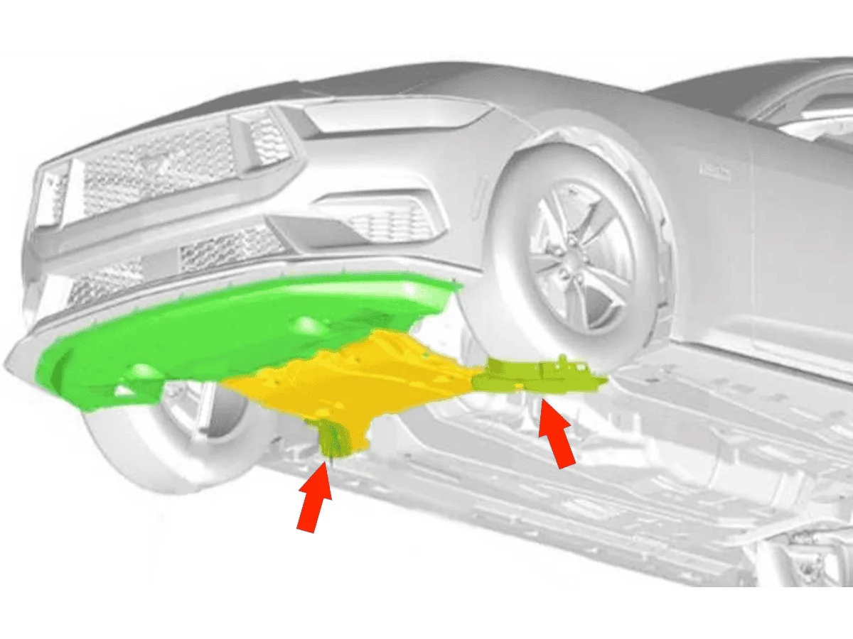

I haven't seen these on an S550 yet. I wasn't sure where they attached but found this pic on Levittown's site:
There’s a video that Steeda did for the install. Looks pretty simple.

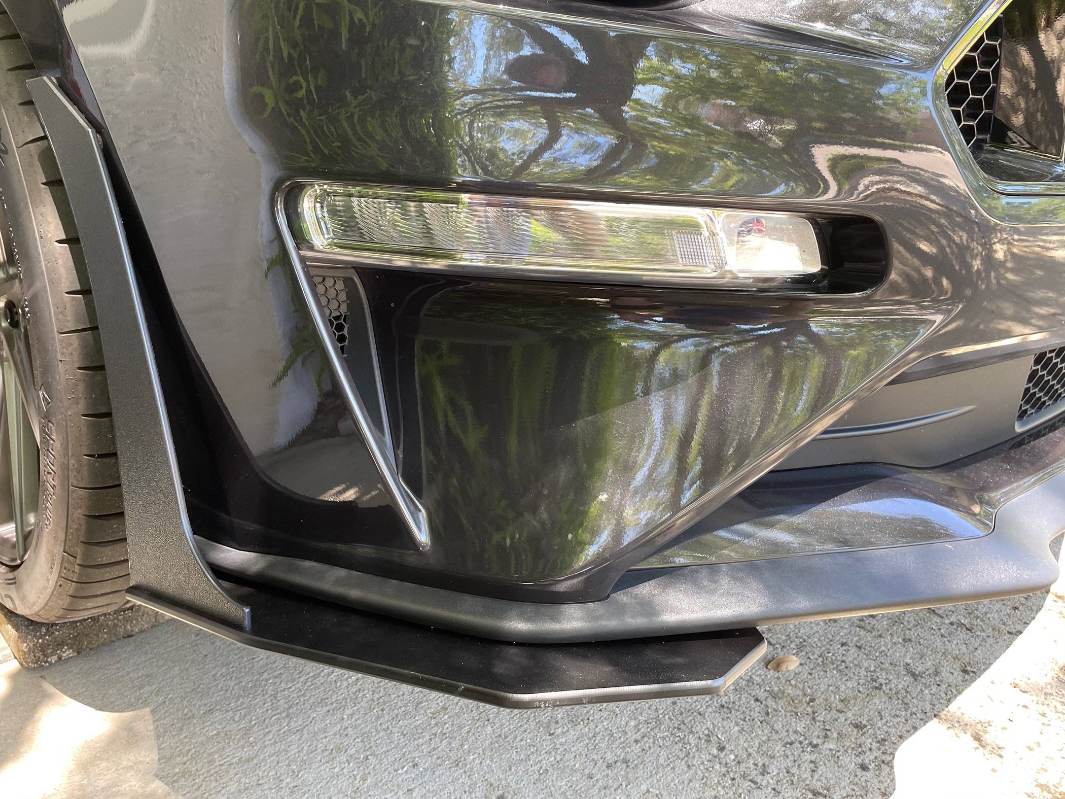

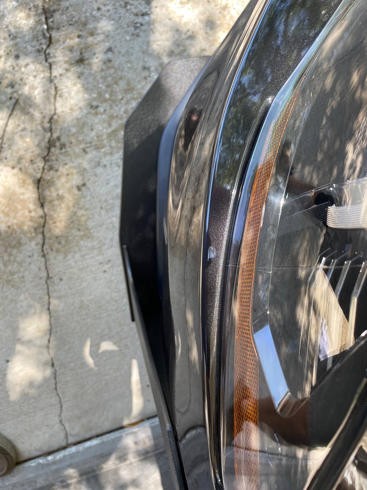

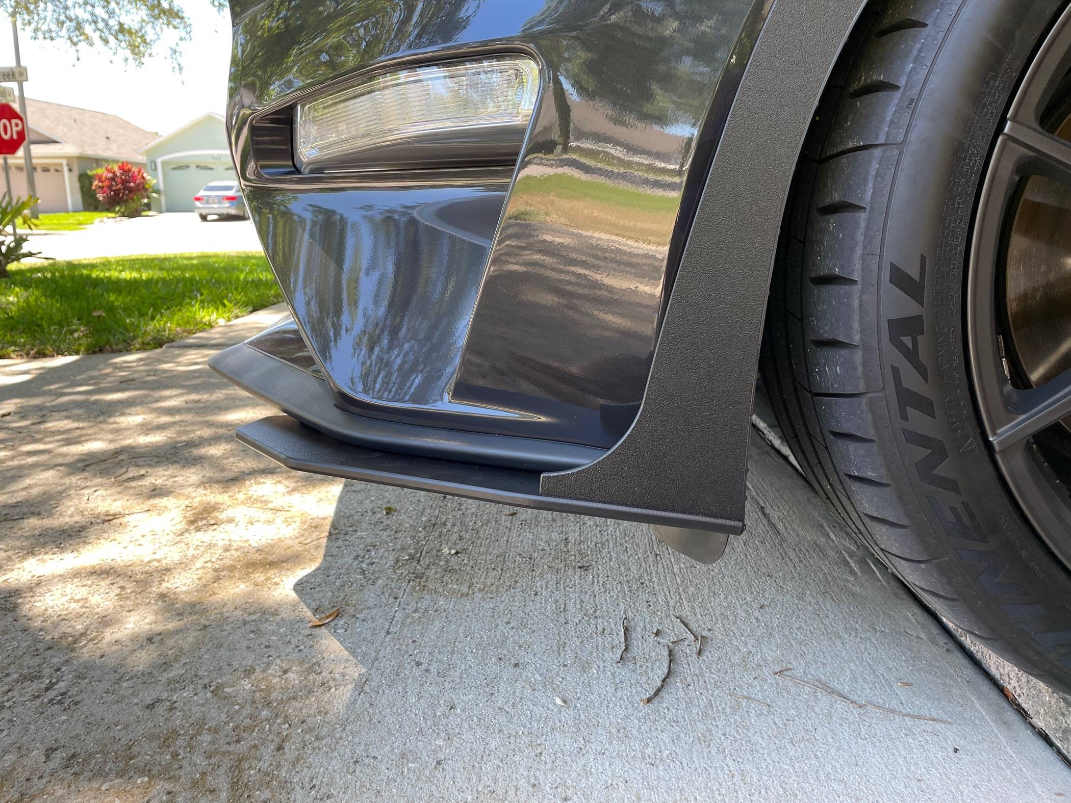

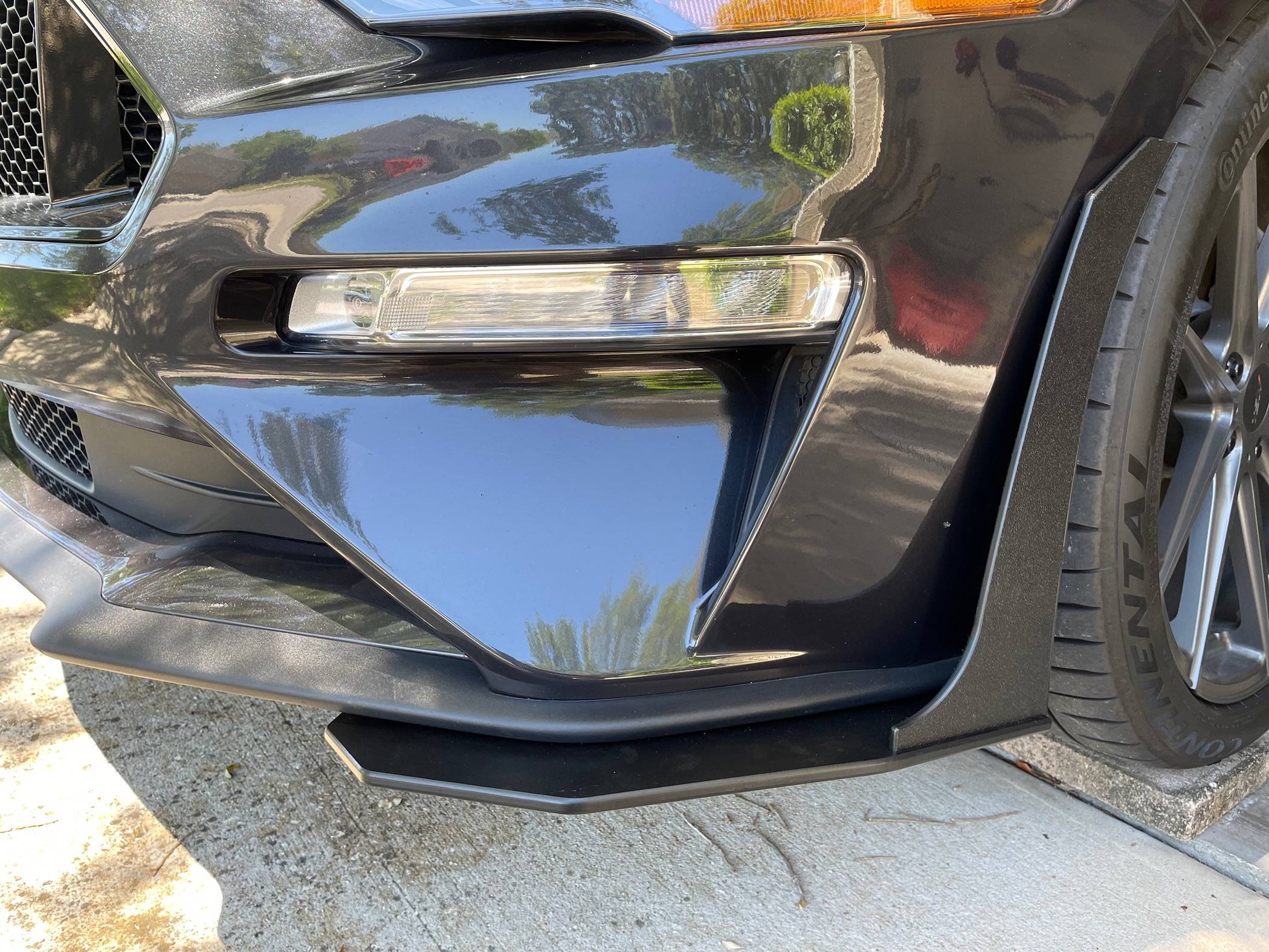

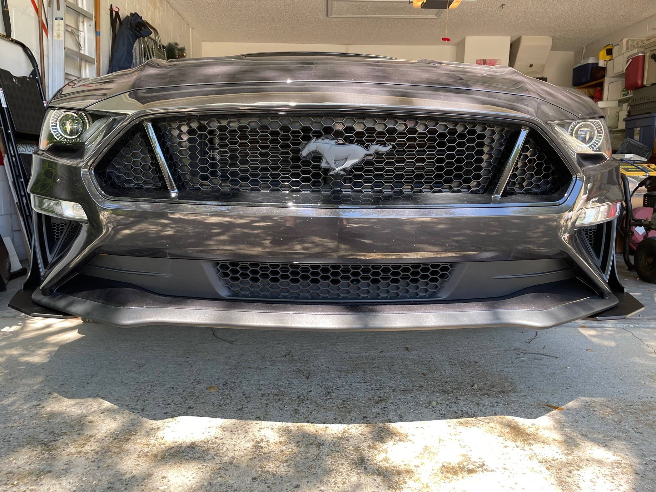

Thank you, if you can share the pictures of end result once you have them installed, that would be awesome. They don't have good pictures there.
