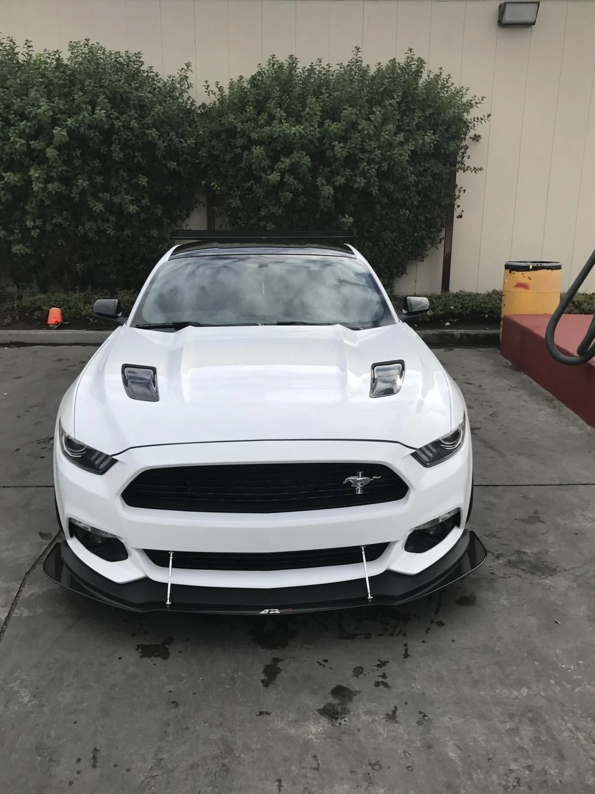

Has a really similar look to the GT350 splitter by APR. And yes, you are correct, since the APR extends all the way under the belly pan it does end up having a very slight upward angle at the front. Not a huge deal if you have a bit of a rake in your car's stance I'd imagine. This is the APR gt350 splitter on my car.
