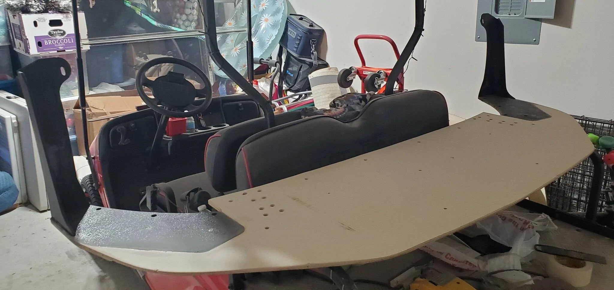

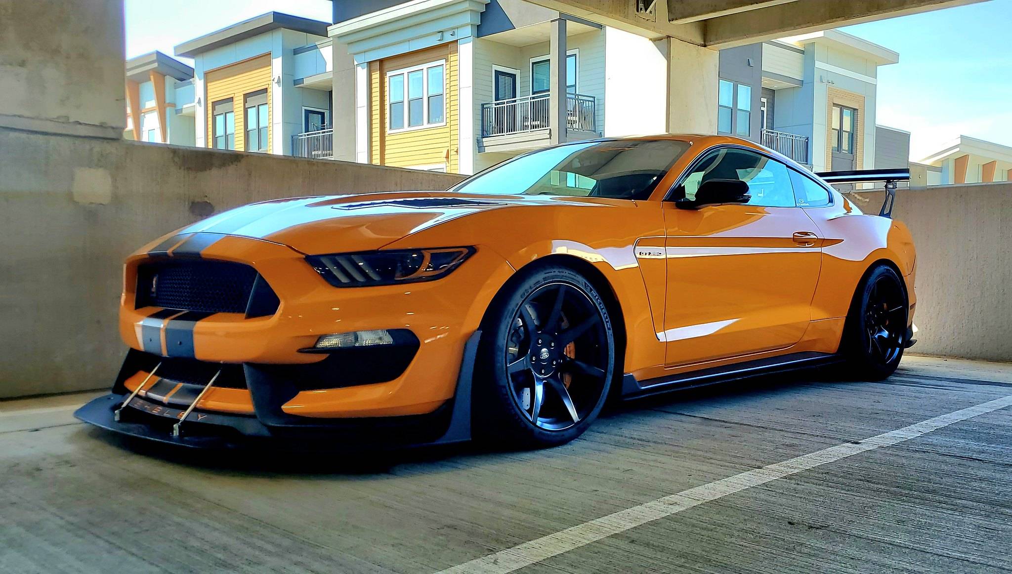

Splitter fences in general work well but are a drag heavy option compared to other alternatives. I actually recessed the ZL1 Addons splitter fences into my custom front splitter.
