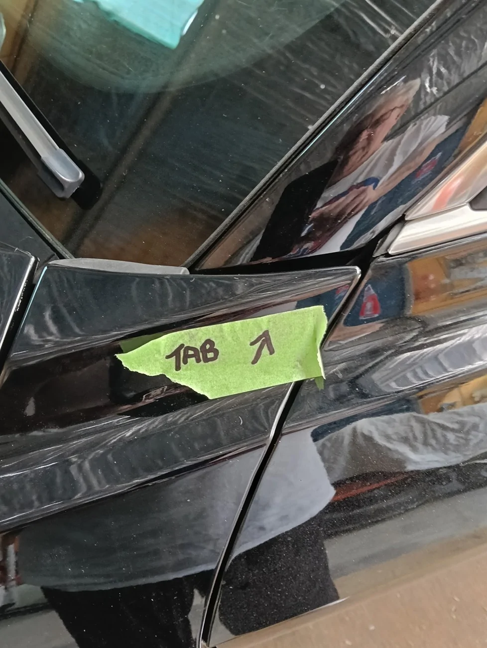

its back part of guard at a pillar before mirror in pic thats the a pillar above arrow
there is a small tab you can see inside when the door is open
most rear part of guard
sorry if its not clear enough small tab with 8mm bolt

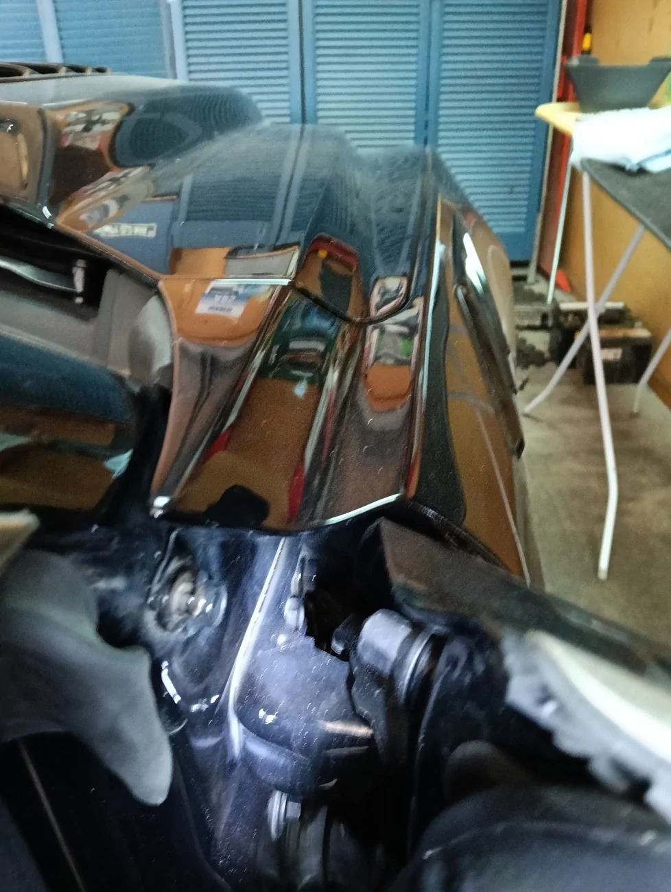

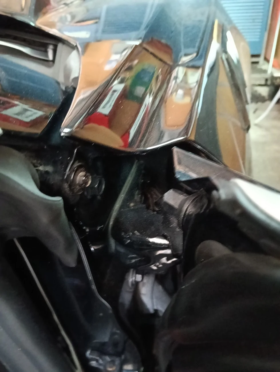

ok im sorting it out myself all good heres pics {lousy i know} looking from drivers seat {right side}towards front guard is attached by small tab with 8mm bolt
i thought someone on here may have adjusted it same as im doing
There is a small bolt hidden under the rubber piece just forward of the A-post as well. Not sure if that will help, but just wanted to be aware of it. I had to loosen/adjust it to get my vertical alignment when I installed my new hood.
