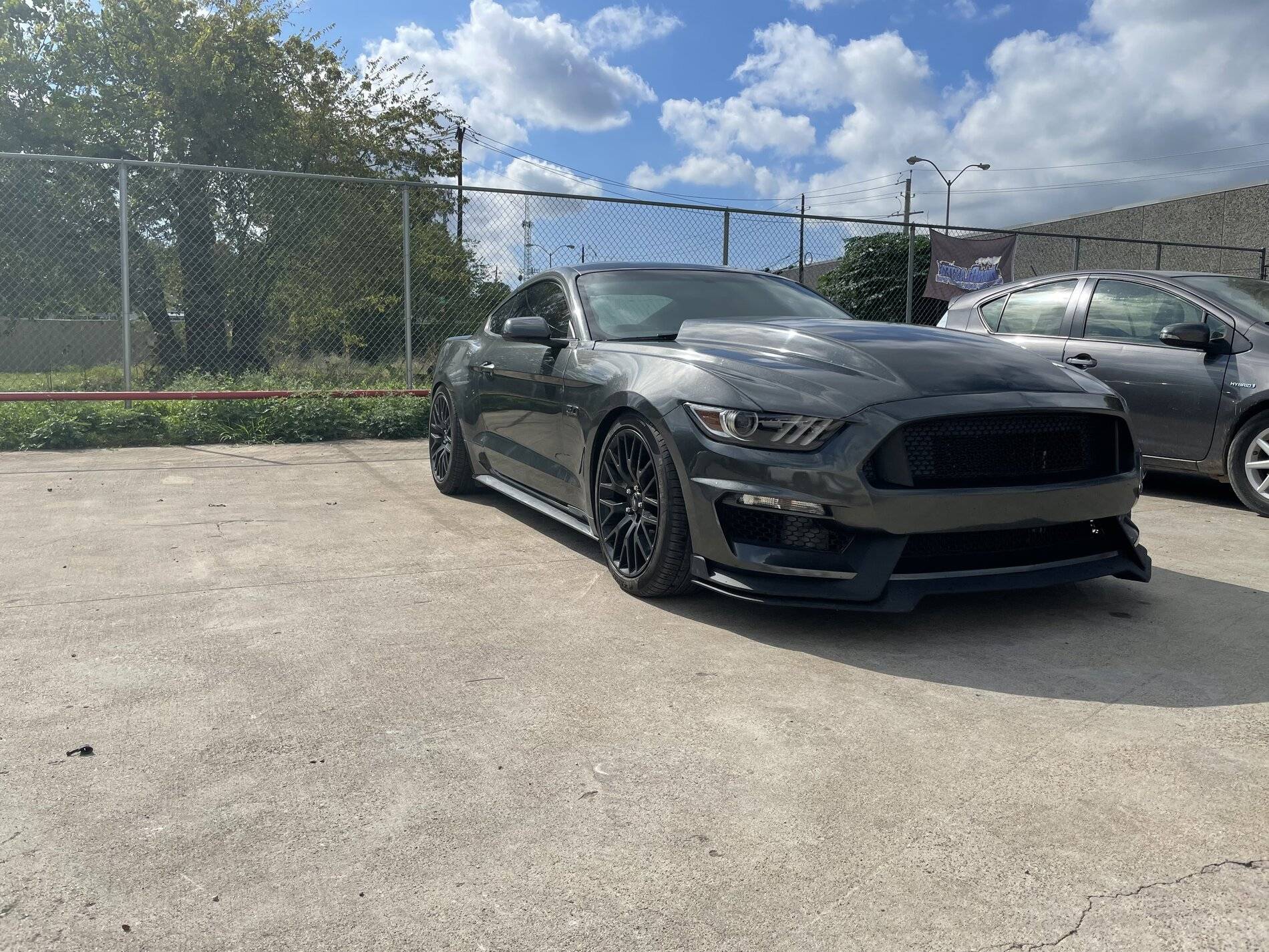

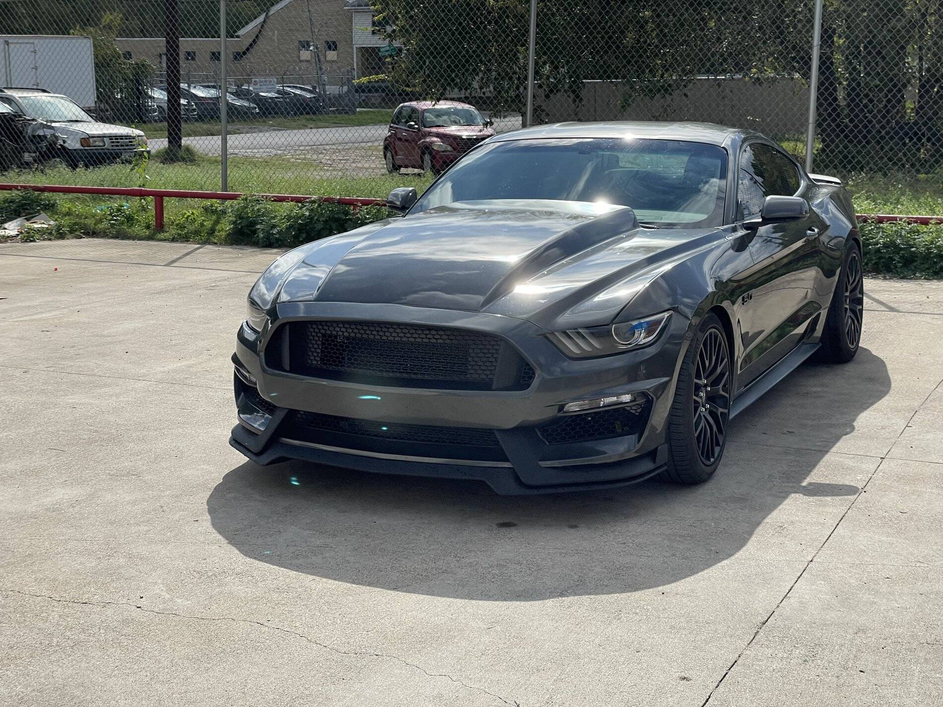

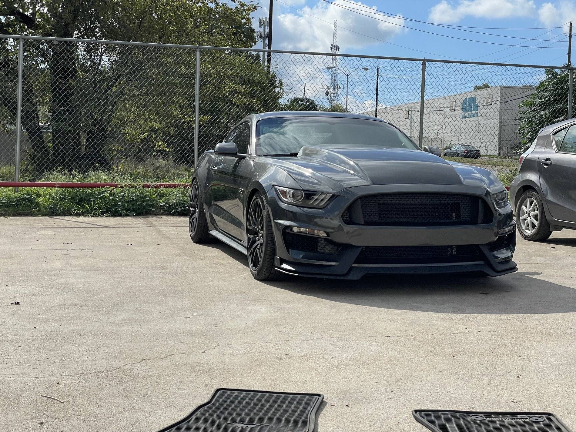

Im noticing the front wheels look like they have a bit of camber. I recently put 1 inch hub centric spacers in the front and rear which I do think made a difference but i’m still wondering if there’s any way to eliminate that camber or just have the wheels sit more flush with the fenders. Is there any way to adjust that on the factory pp suspension?

No, you’d need camber plates or maybe crash bolts or wider spacers.
most of us run more aggressive aftermarket wheels.
removing all the camber is bad for handling. Stock camber spec is 1.5, and I wouldn’t go less than that… so more aggressive wheels would be my recommendation.

From the pics, it looks like your camber is still more or less at its desired stock setting. If your camber was too negative you'd want to go ahead and get yourself adjustable front camber bolts from BMR, Maximum Motorsports etc. Anything beyond the added adjustability of the bolts would require the front camber plates.
