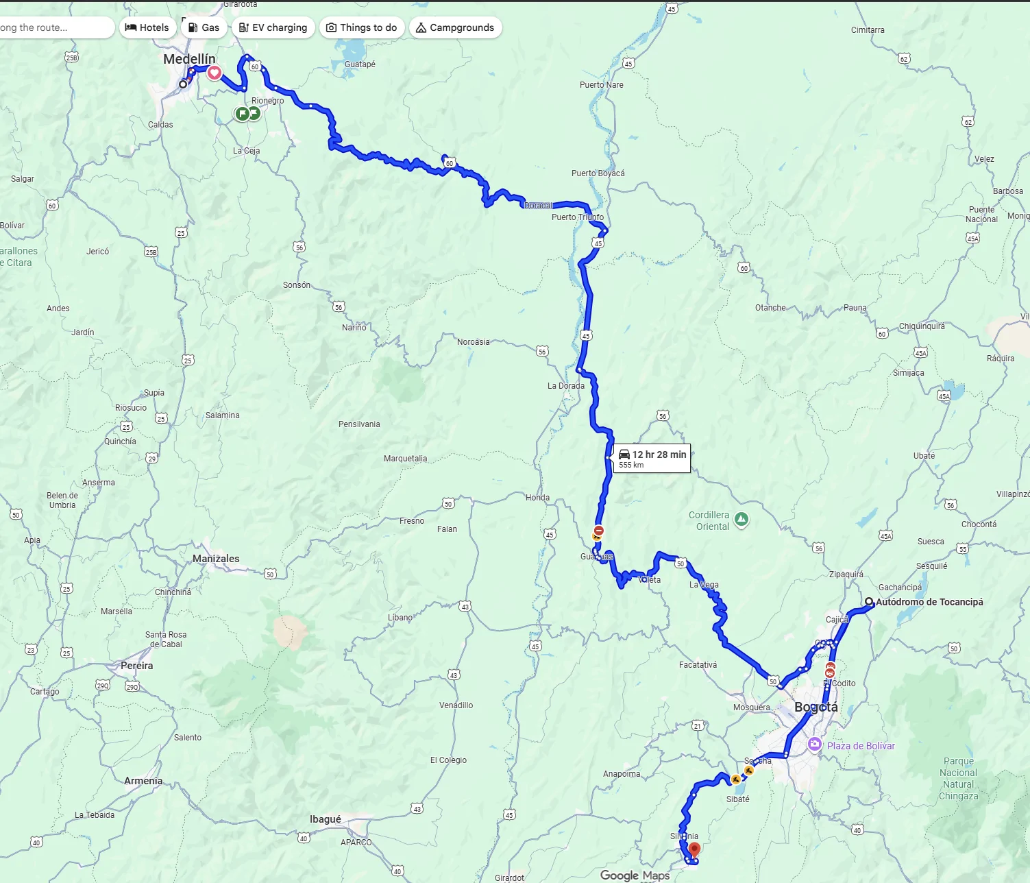

It's a long way to the track. Like 50% of it curvy mountain roads. Then go to the town where my gf grew up. 345 miles round trip. Would a -2 camber wear down the tires badly? My tires are TW300 falken fk510 285/35r19
