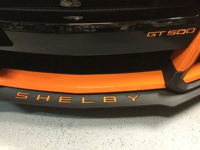

I am going to chime in here. The silicone method that I used was on the SHELBY domed letters on the front splitter. It is because, like Kent, mine would not stick on the rough plastic of the splitter and after several washes they blew off.
DocGT is talking about the GT500 stickers for the front bumper and I DID use the wet method. At first I tried to stick them on dry and what a pain that was. I went through two sets and never got them on correctly. After meeting with Terrance to pick up my rotors, I saw his perfectly fit GT500 sticker plus his colorized cobra emblems and he told me to used the wet method because it was much easier. It is basically like window tinting. The side of the tint film that is sticky gets wetted down and so does the window and you apply the tint so that it matches the window perfectly then squeegee the excess water out. The adhesive on the tint film will still stick to the window when dry and same goes for the GT500 sticker on the bumper.
I want to say, while I know they can be installed using the dry method, I guess I did not have the patience to do it that way and I actually do have a lot of patience but not for this. My hands do not work like they use to and I have arthritis so the wet method just was easier.

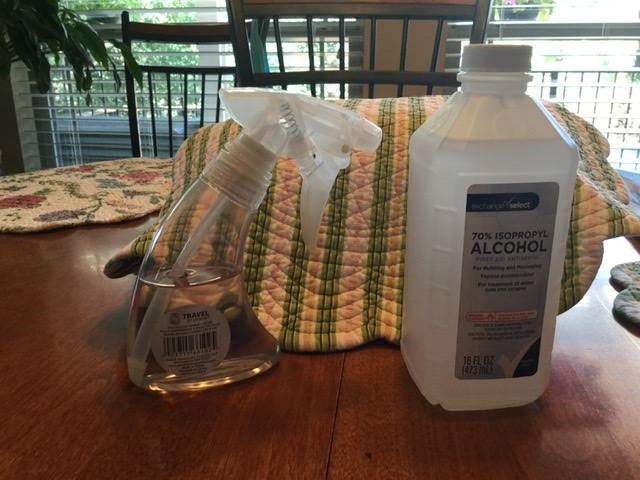

I have always used the wet method for these sort of applications. I have a small spray bottle full of 70% alcohol. Use it to clean the surface first; then wet the surface and the sticky side. Use a microfiber towel to press into place and dry.
Haven’t lost anything yet!
