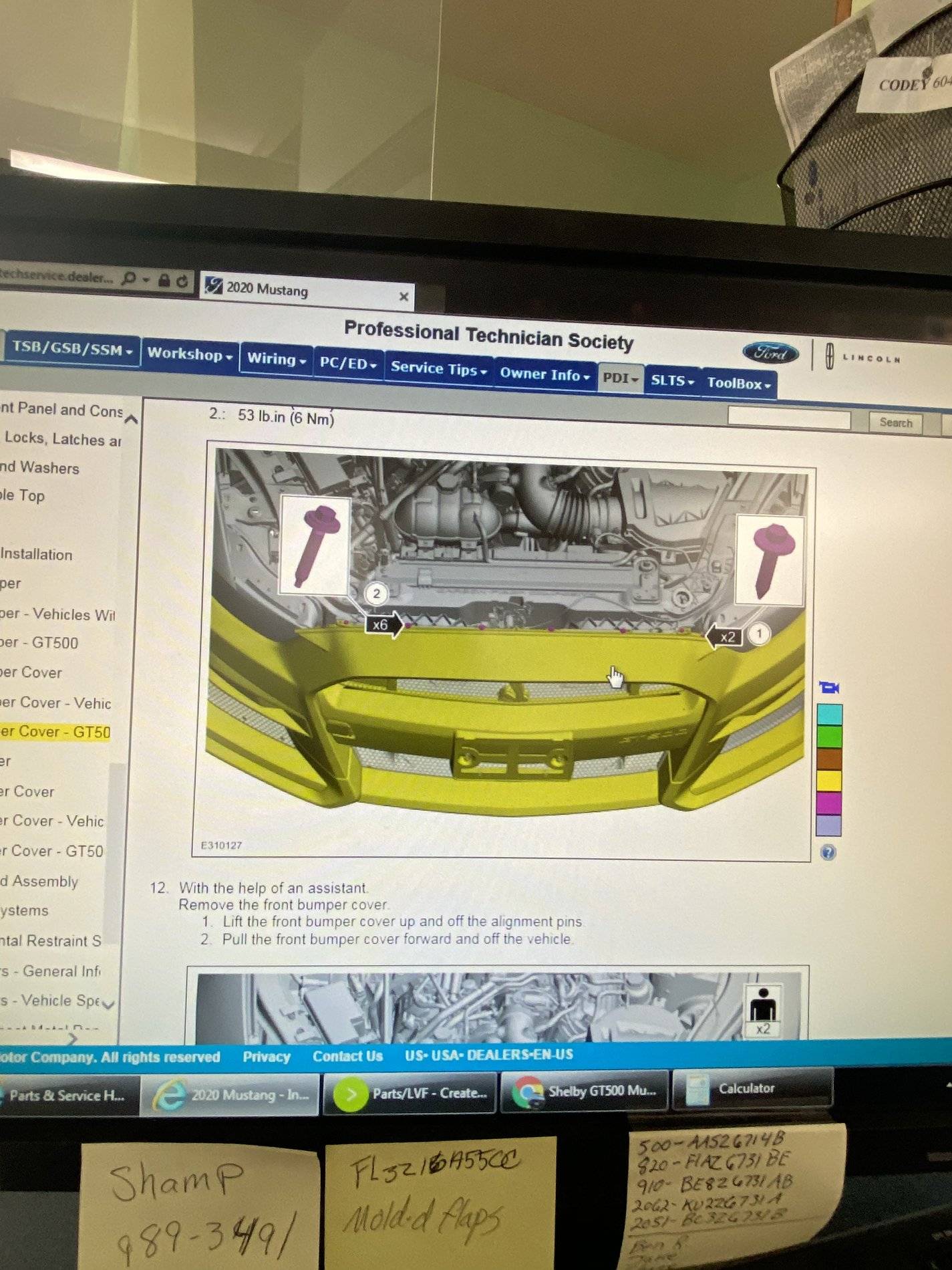

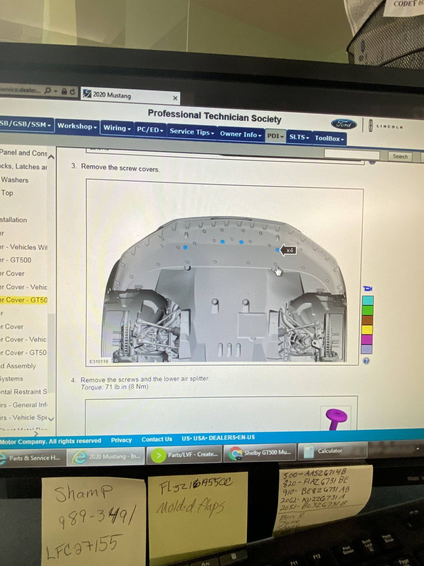

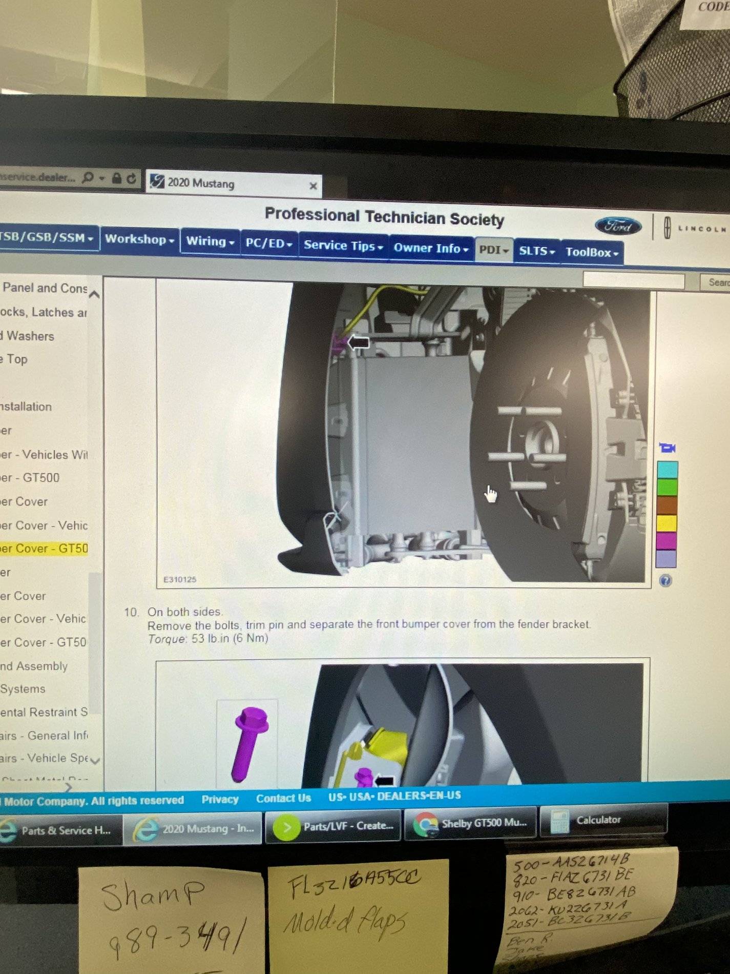

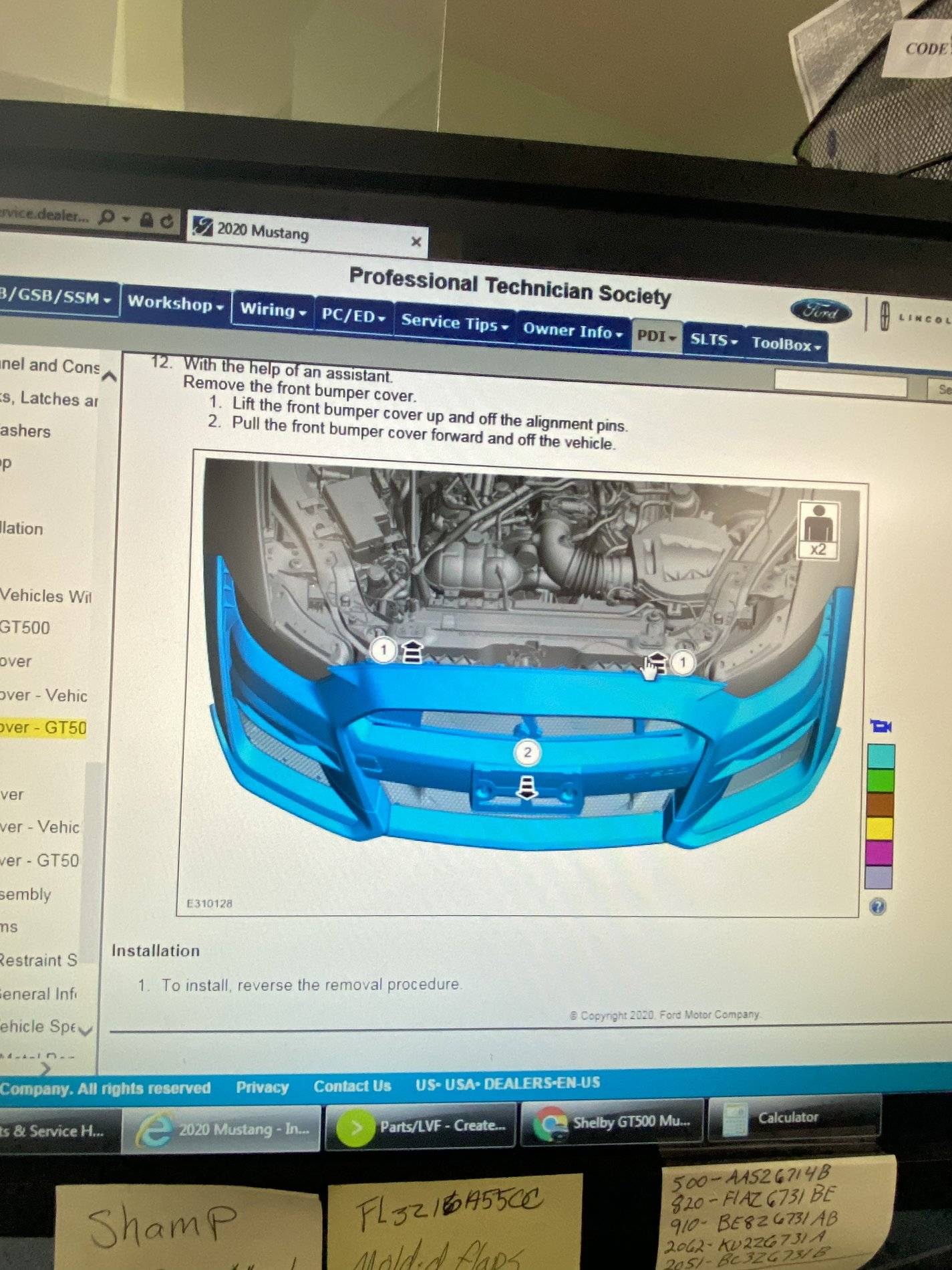

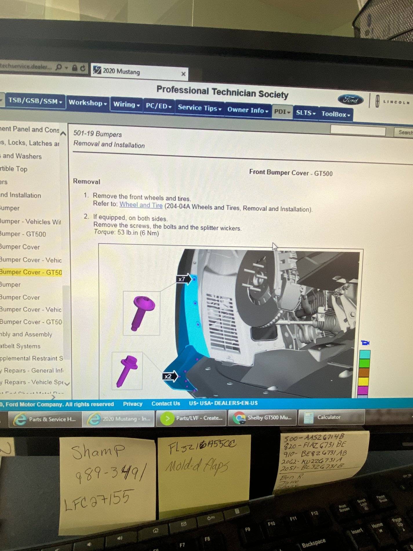

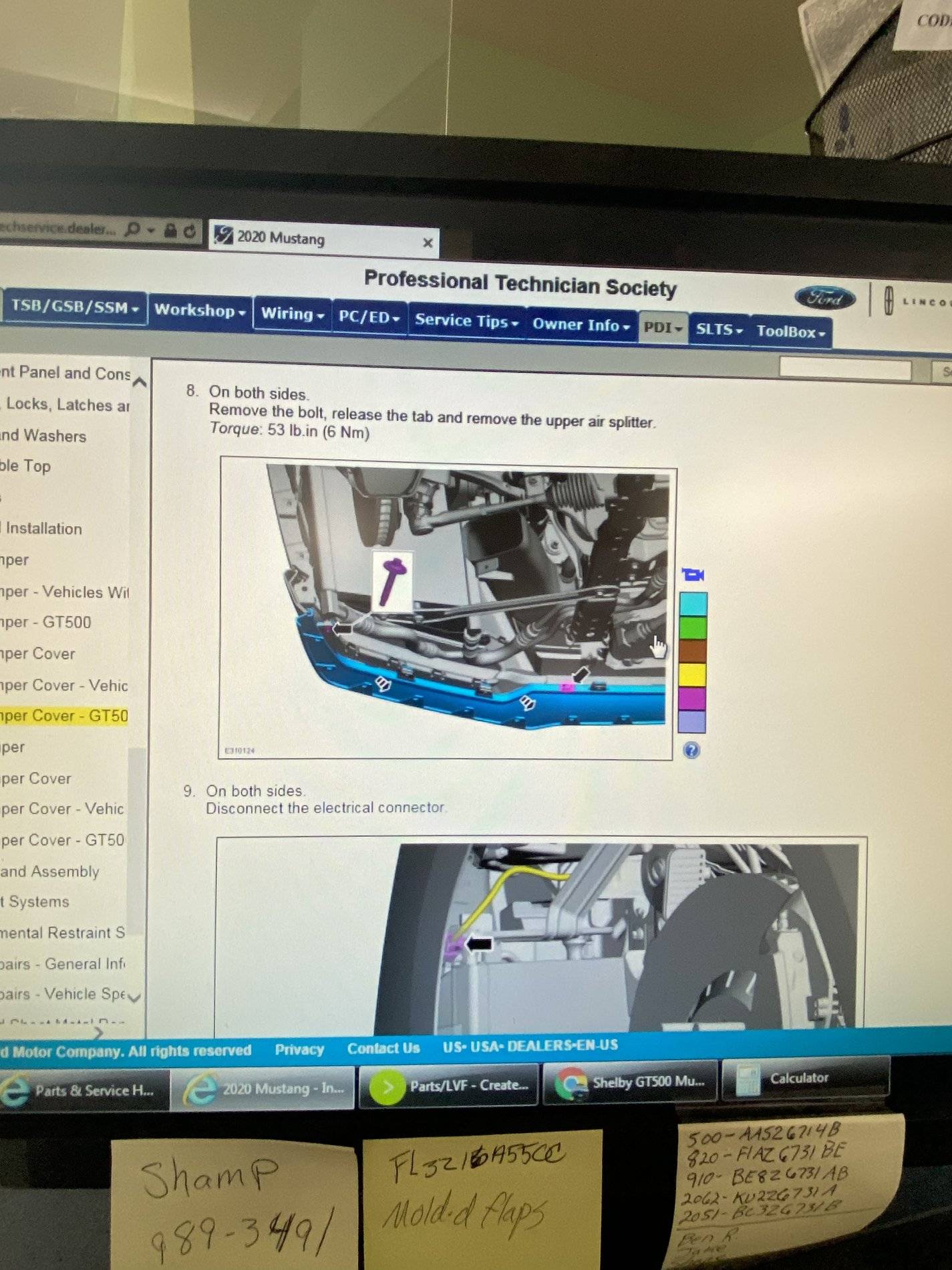

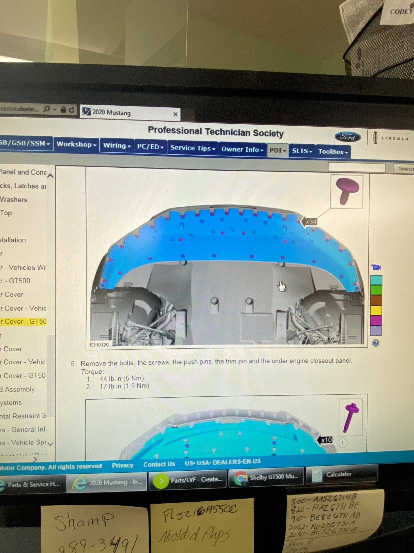

Does anyone know the procedure or a how to link for removing the front bumper cover on the 2020 GT500?

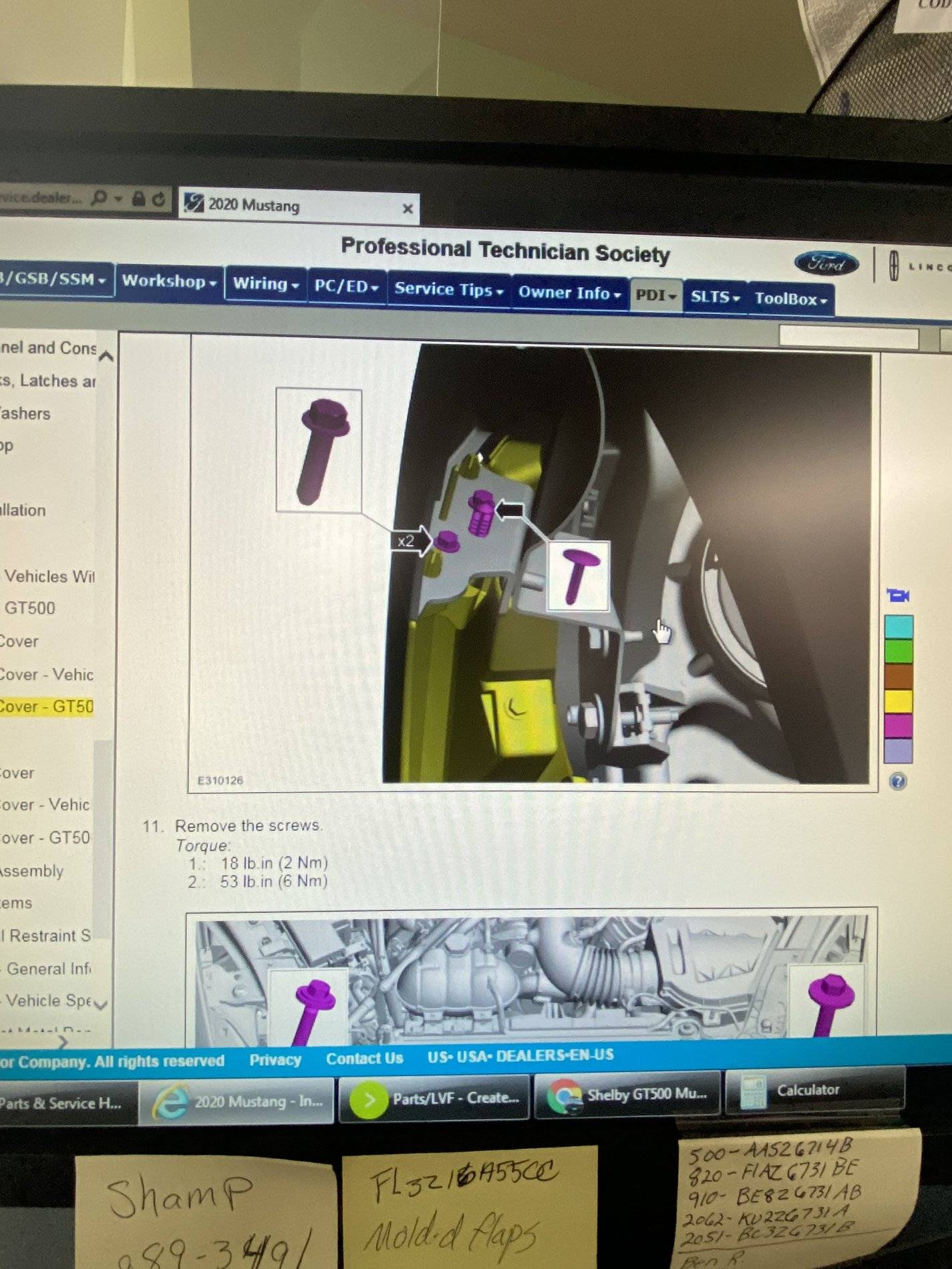

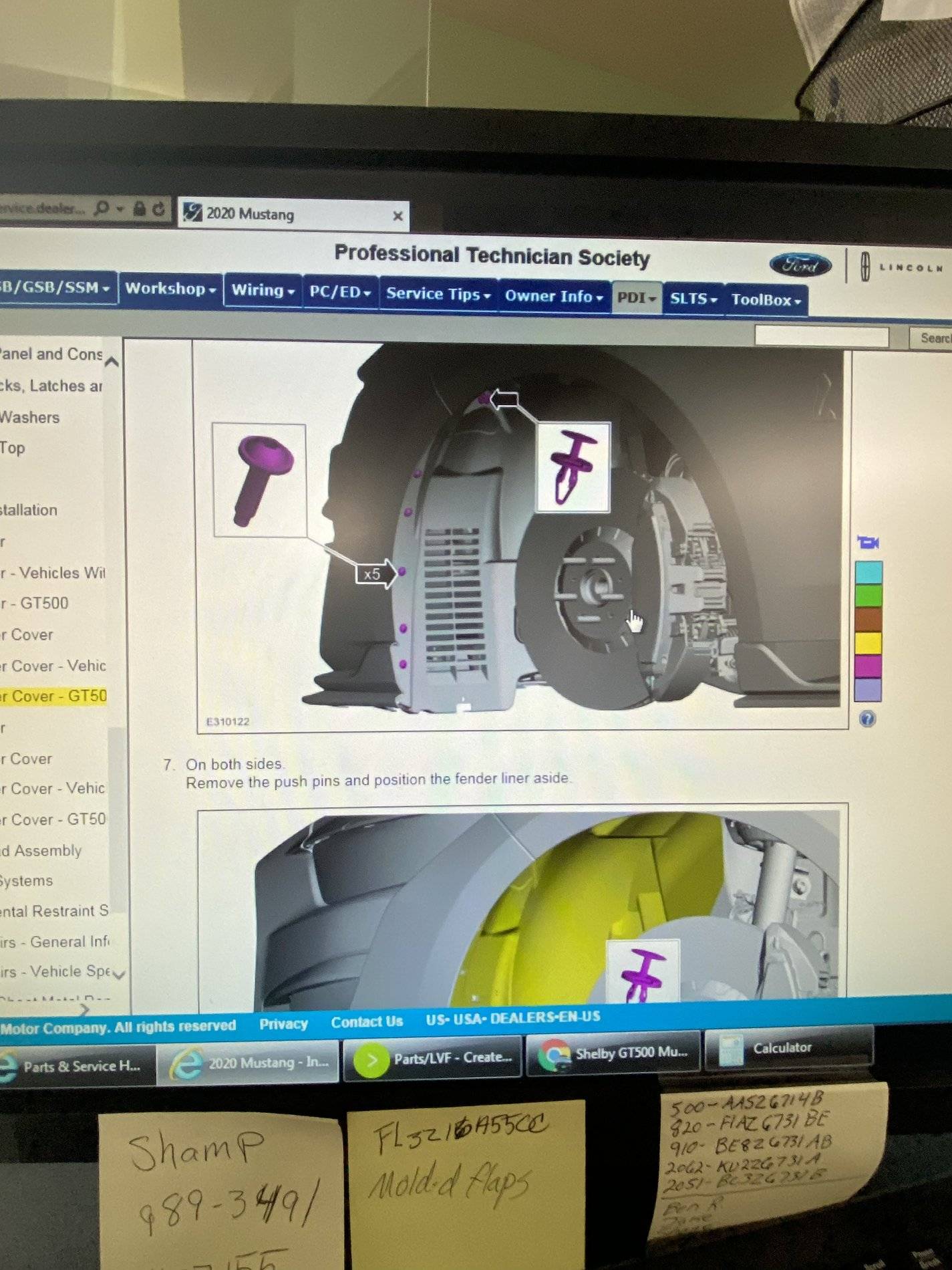

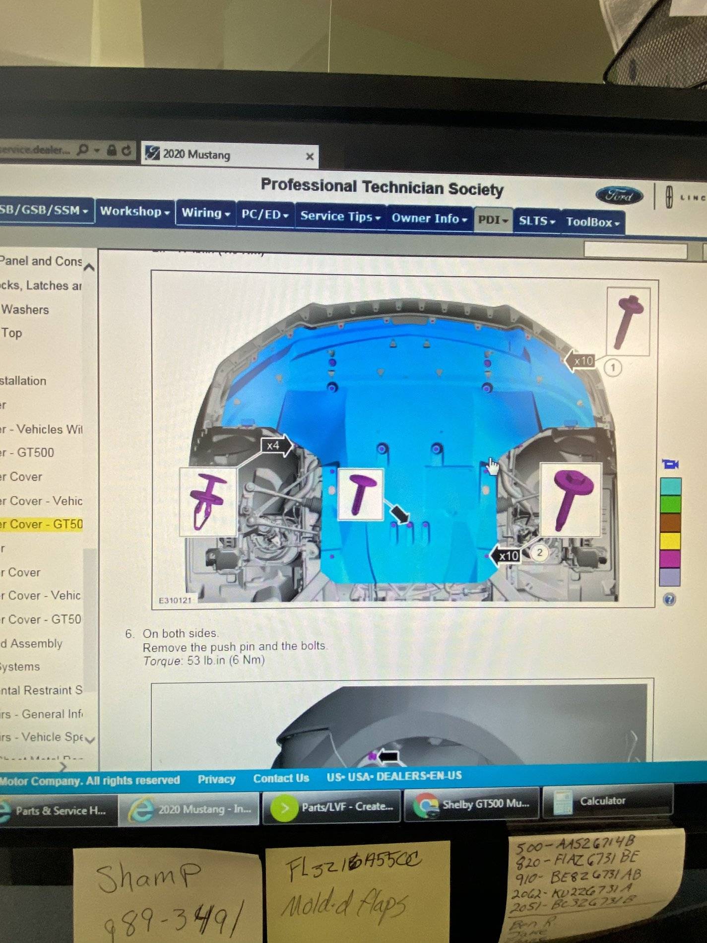

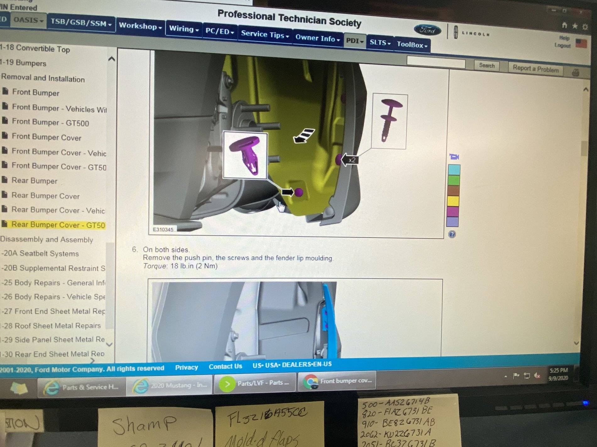

Please see the following. I think the admins need to make this a sticky.

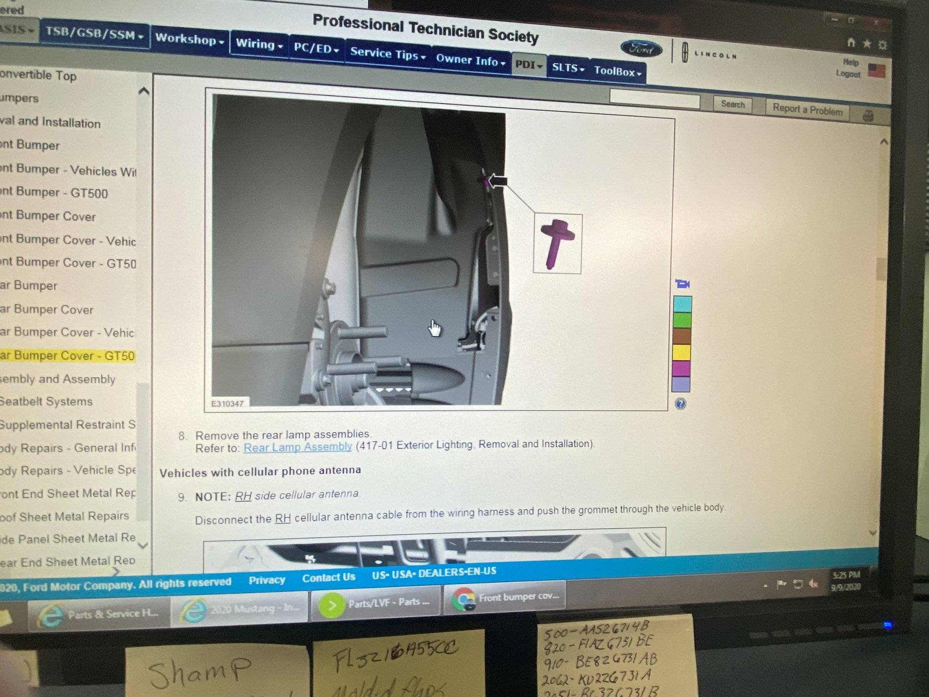

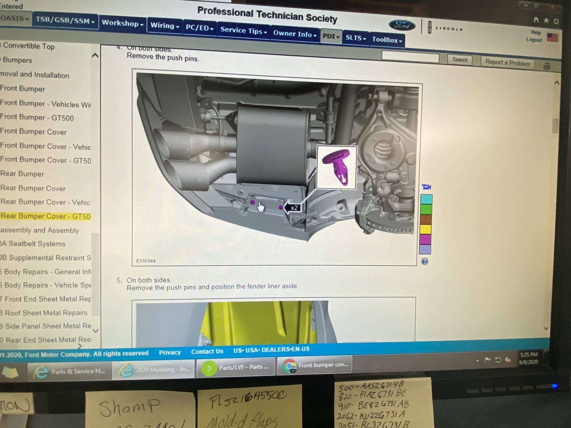

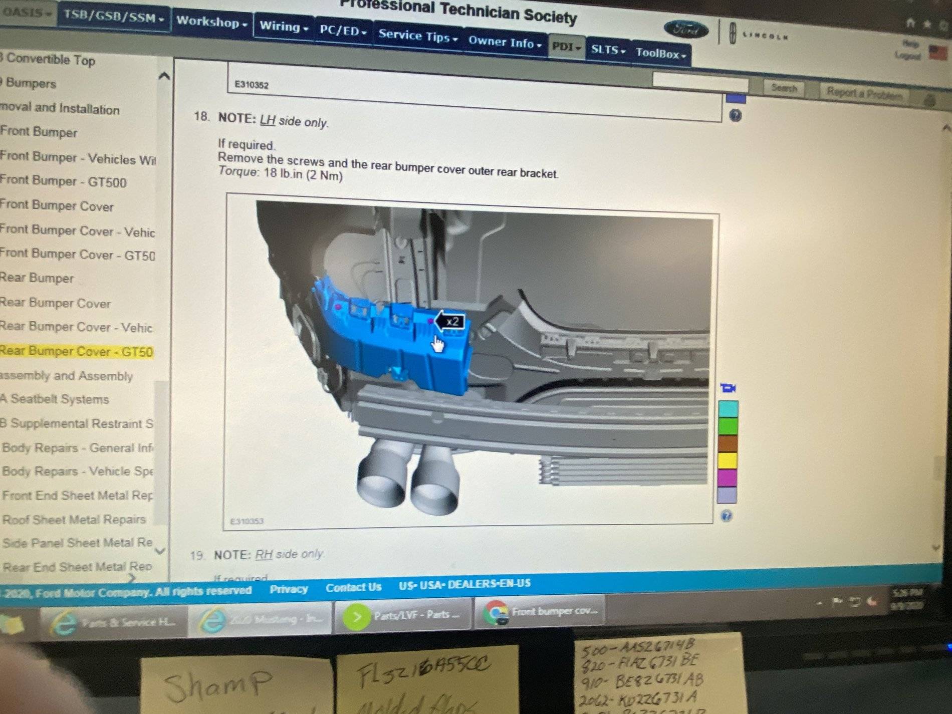

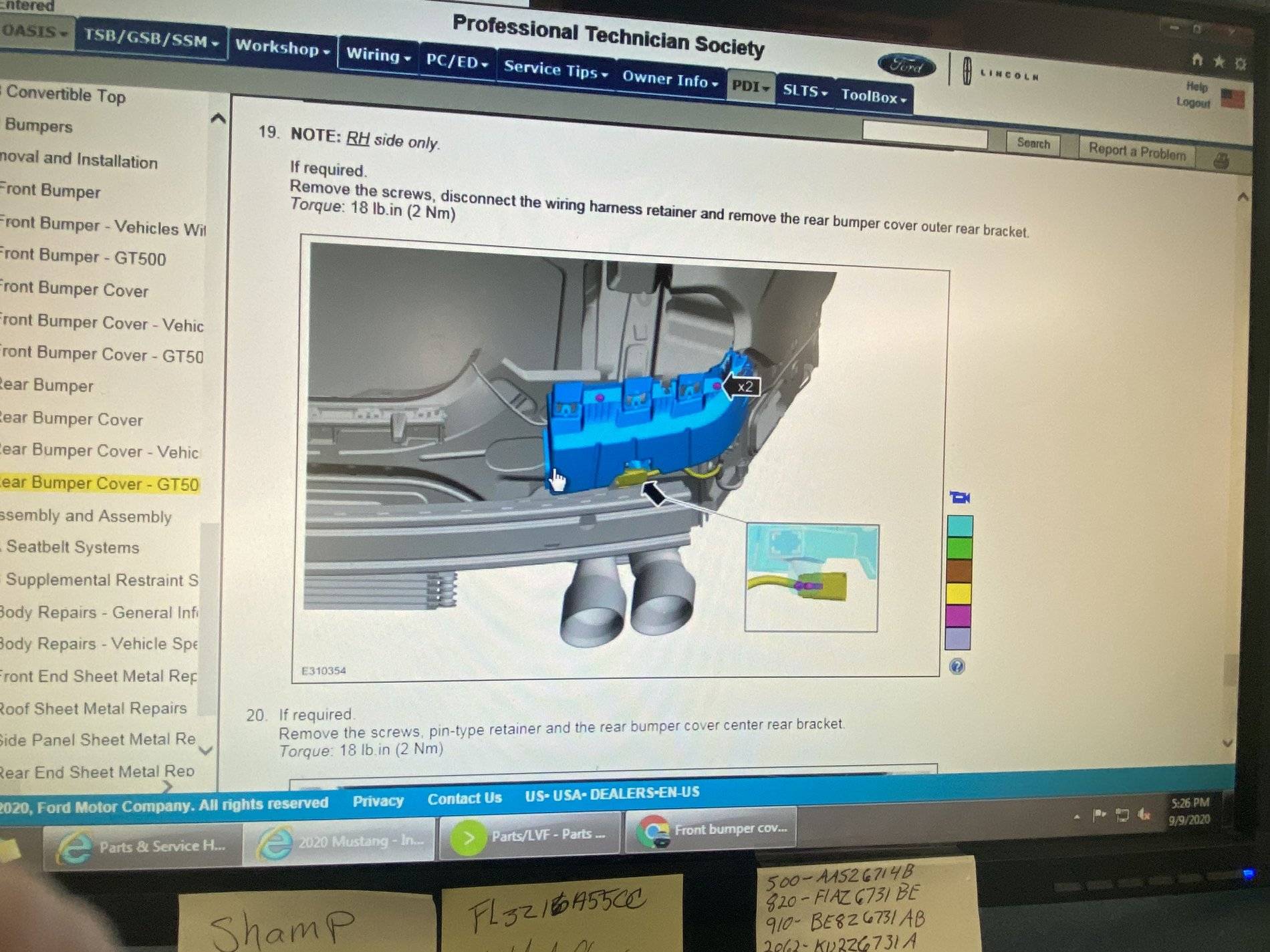

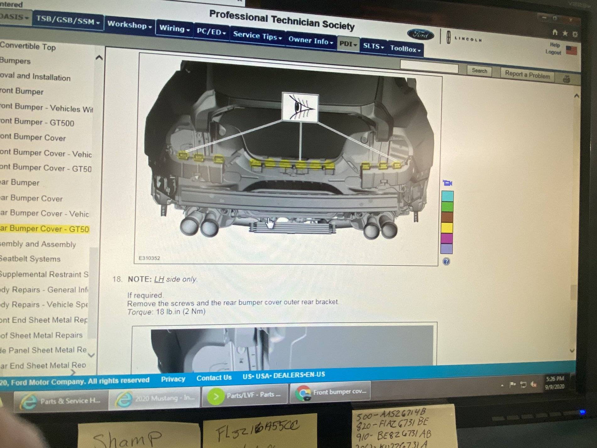

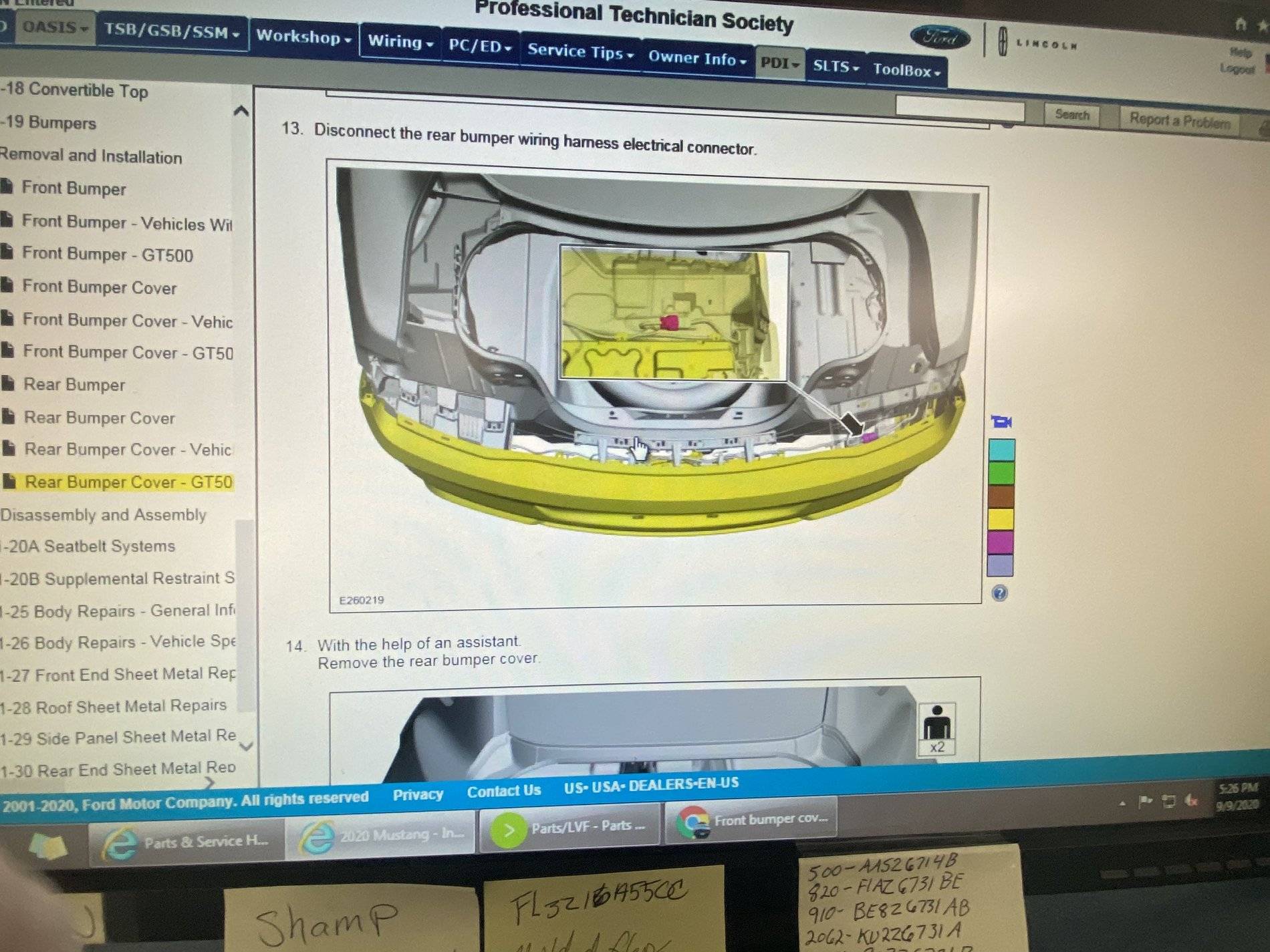

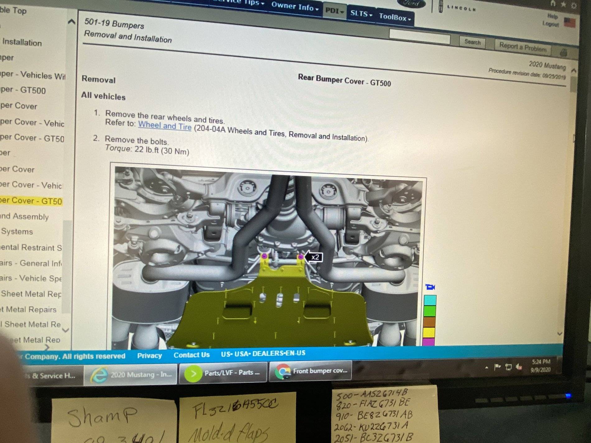

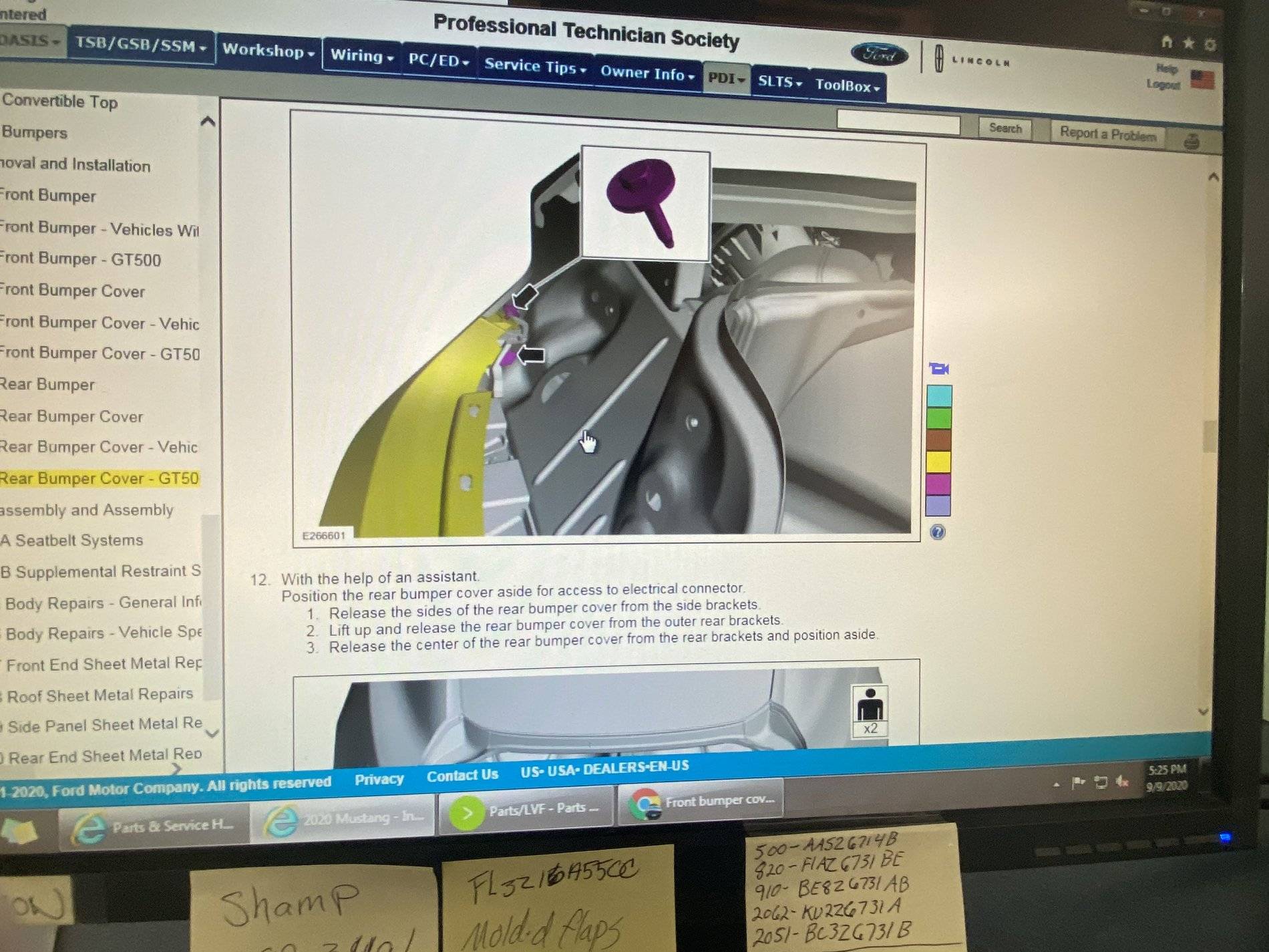

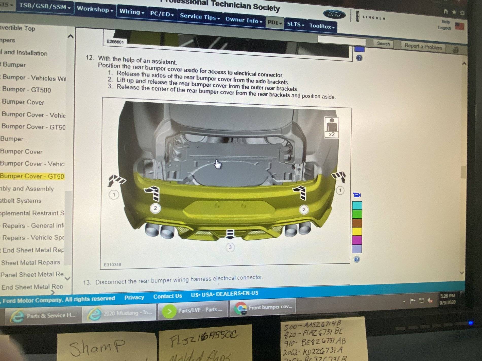

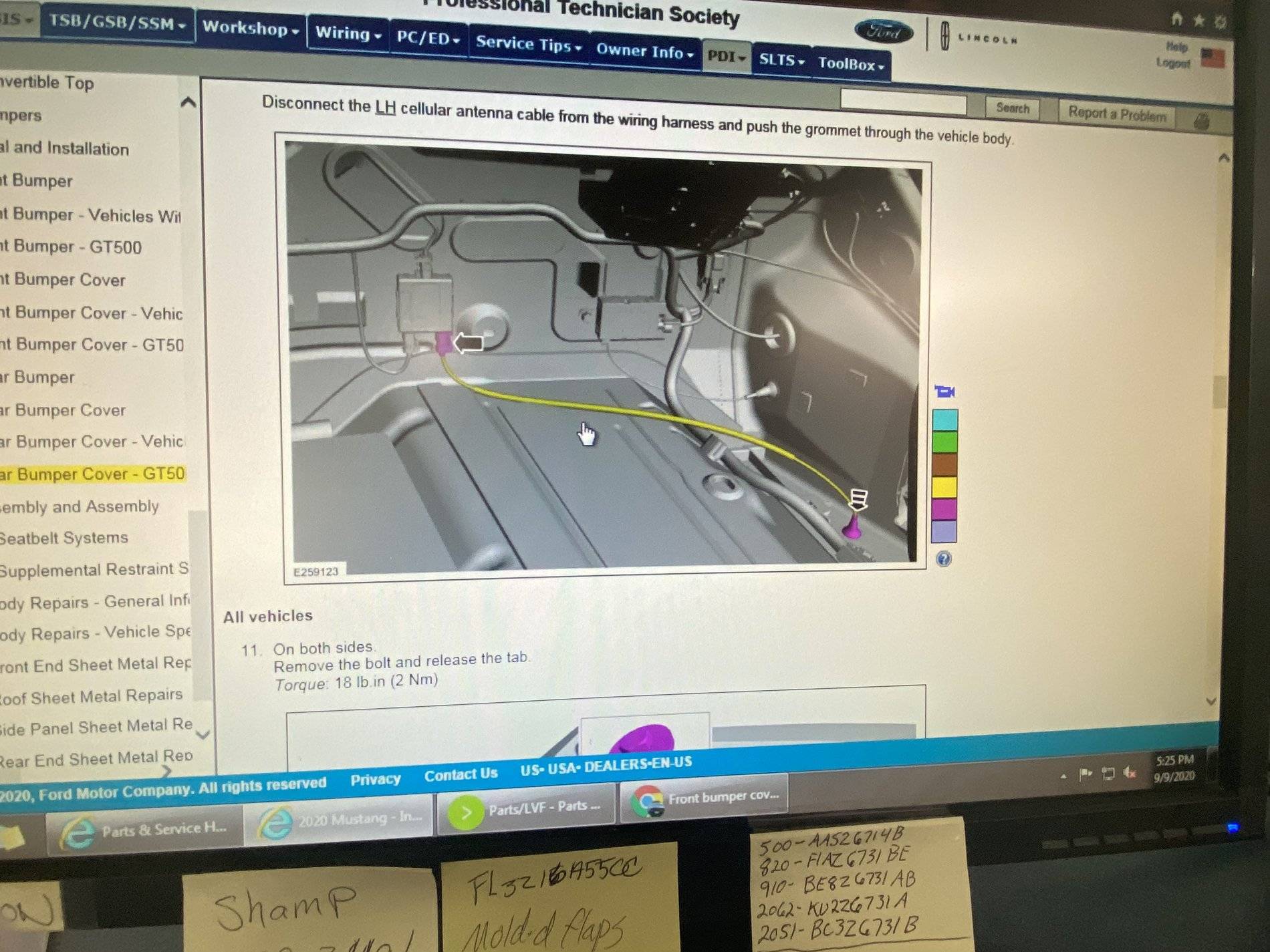

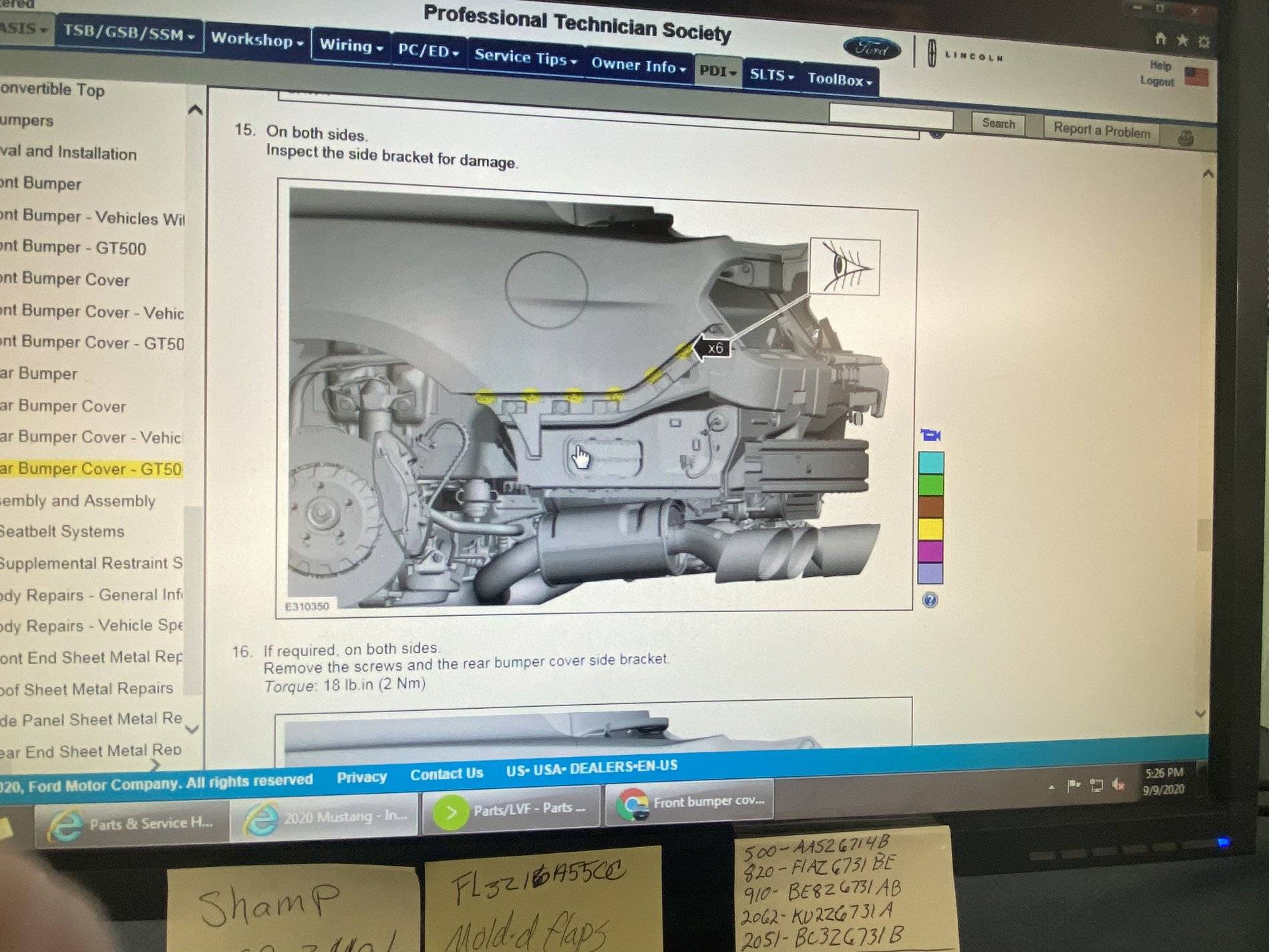

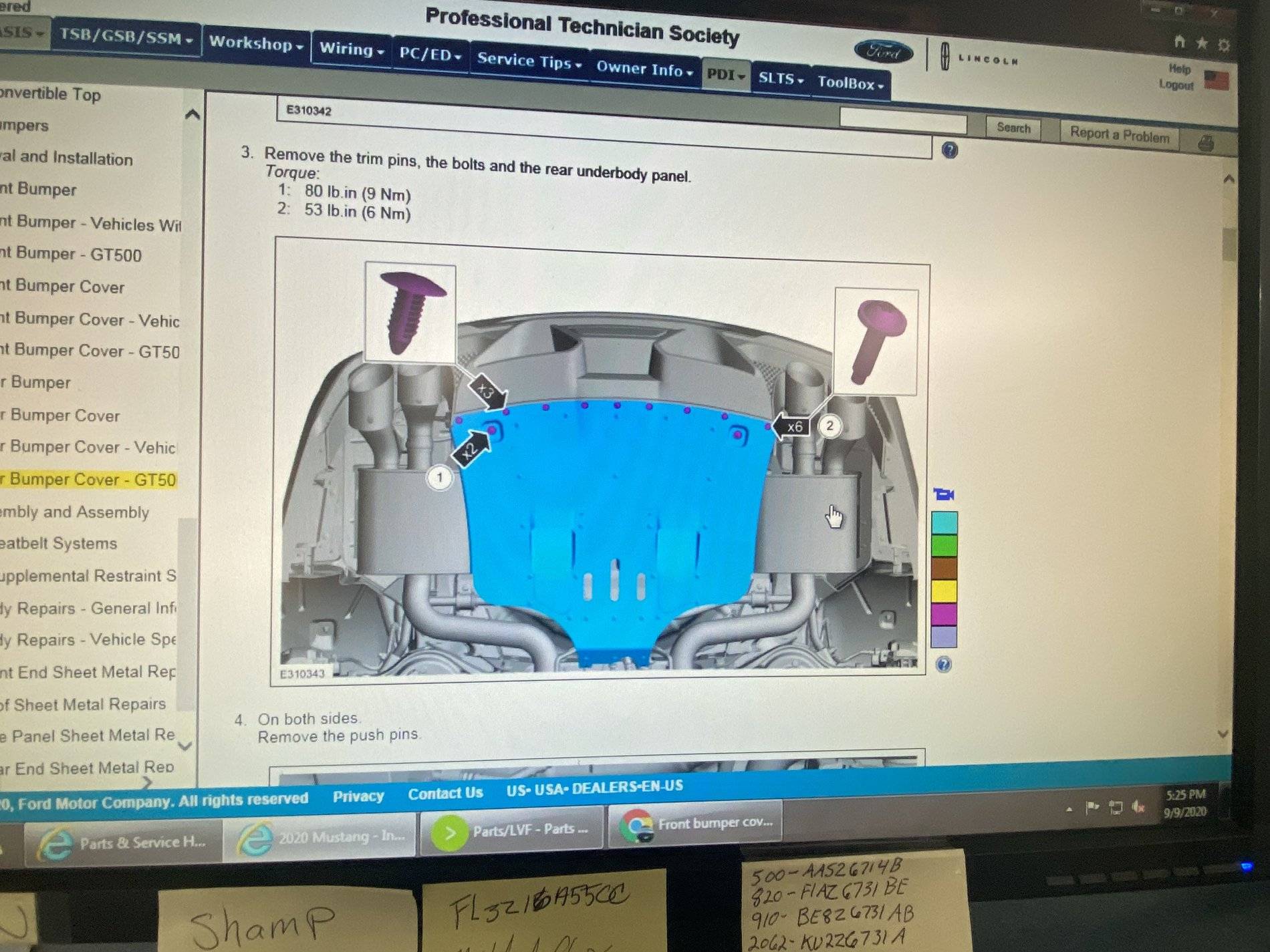

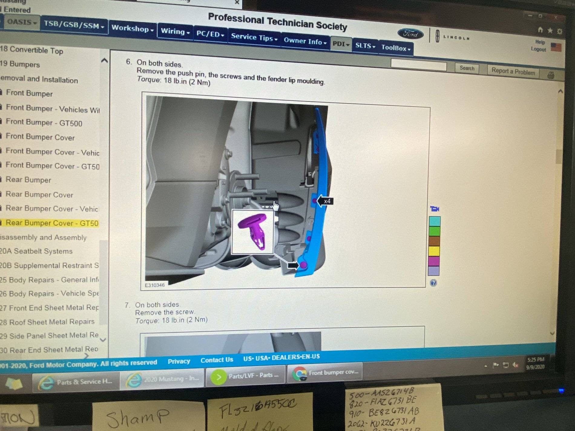

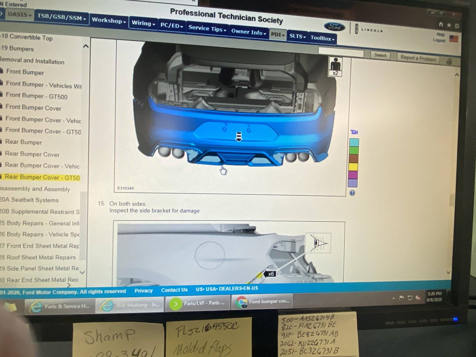

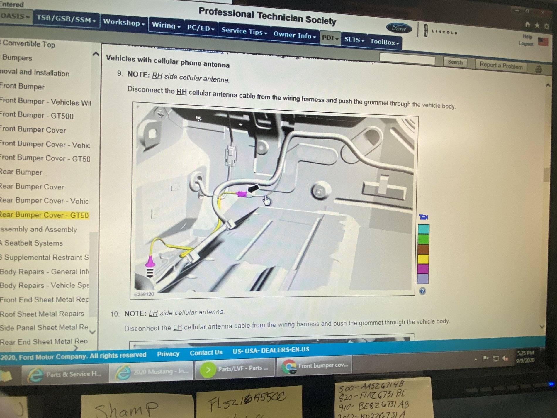

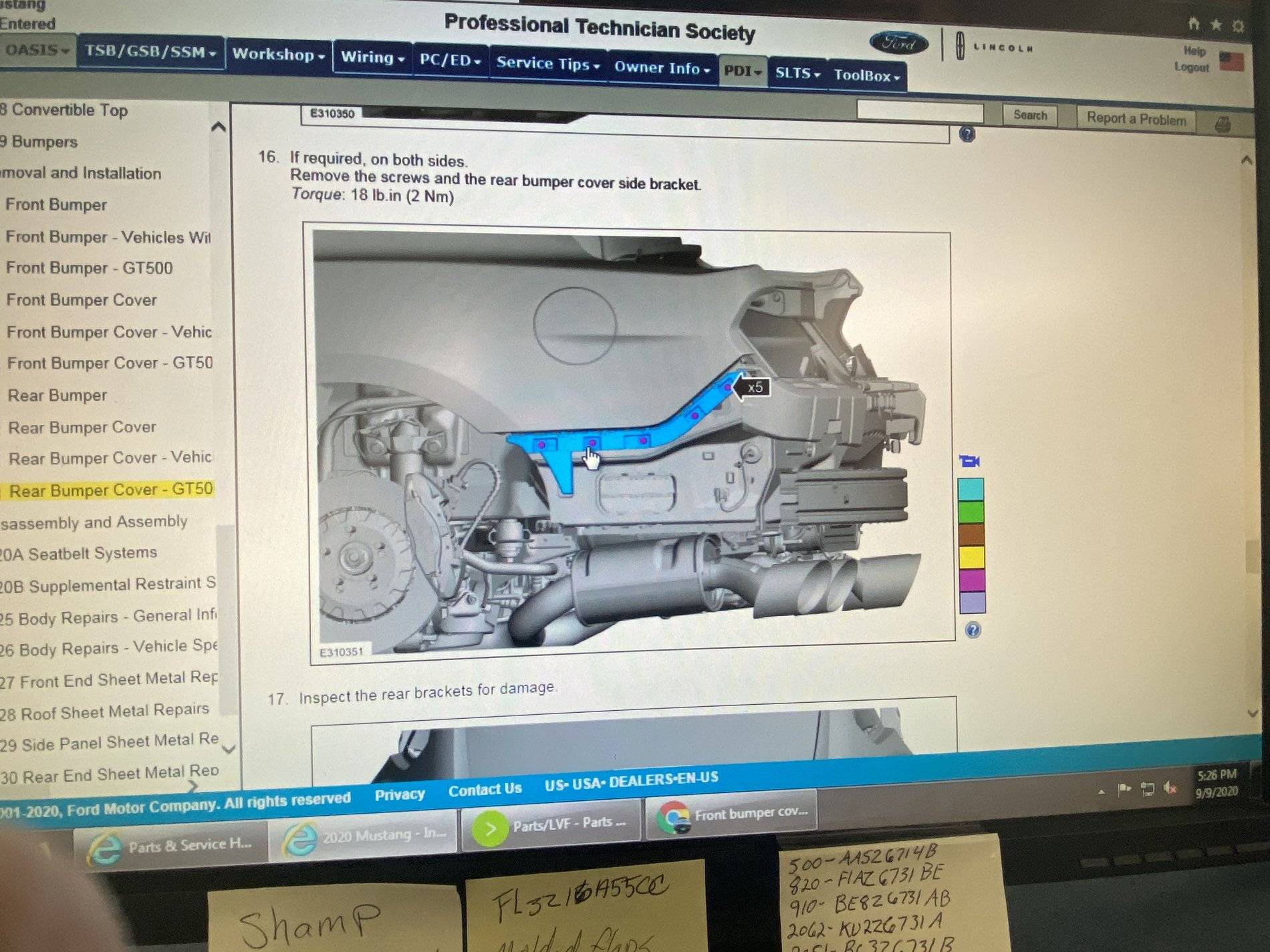

Thank you so much. Can you post one for the rear bumper cover as well?

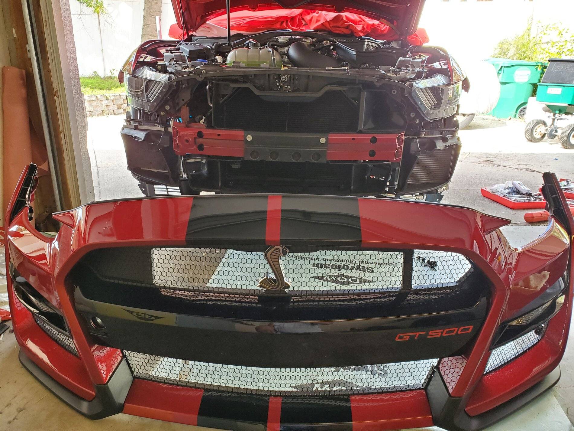

Other than the million screws holding the splitter and belly pan on its pretty simple. The 2 bolts holding the front bumper to the fender are kinda tricky but if you have battery powdered 1/4 ratchet its easy.

its the same as the GT350. The workshop manual is pretty clear on the process. Remove the belly pan, splitter, and then the fascia. Its a pain but not difficult.
