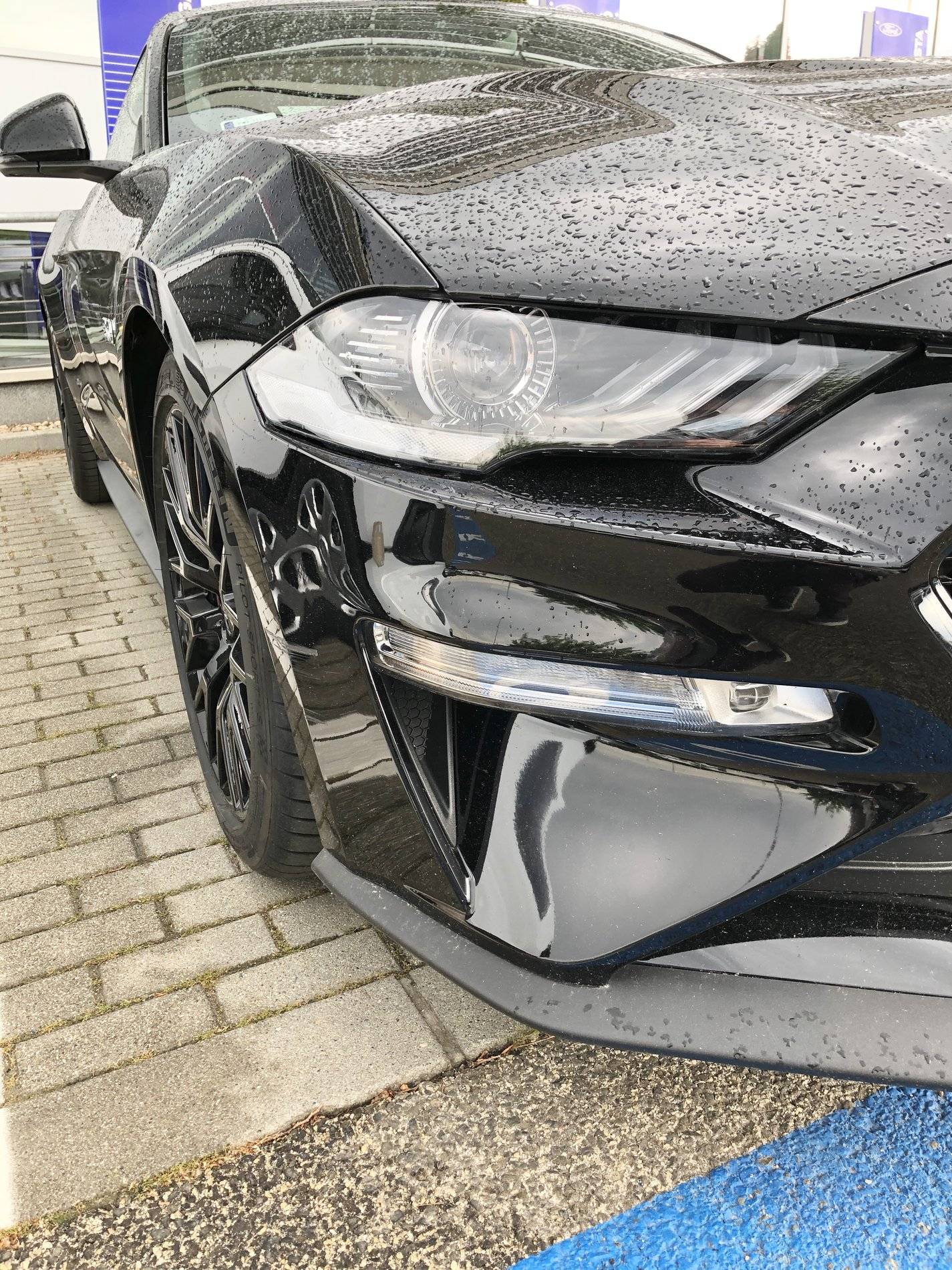

Took a shot at another MY19 Stang I saw today at the dealership, it has the gap as well.
I used your photo today to show the stealership your bumper. If you read my post you will see they could not give 2 shits. I will be posting my experience on every mustang site.

Lmao and i tought i was crazy to notify this on my own car, i come across this topic. My 2018 have the same gap

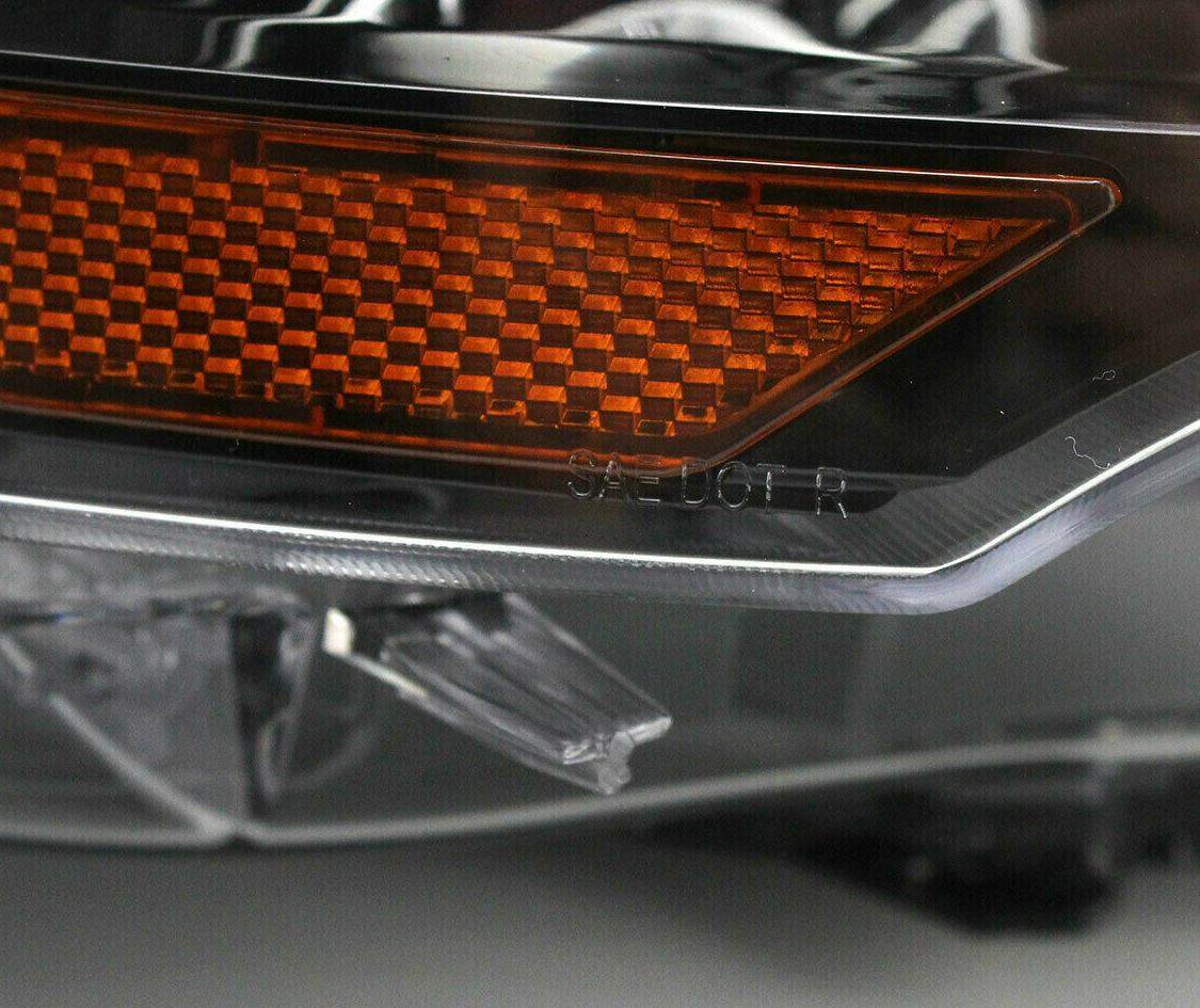

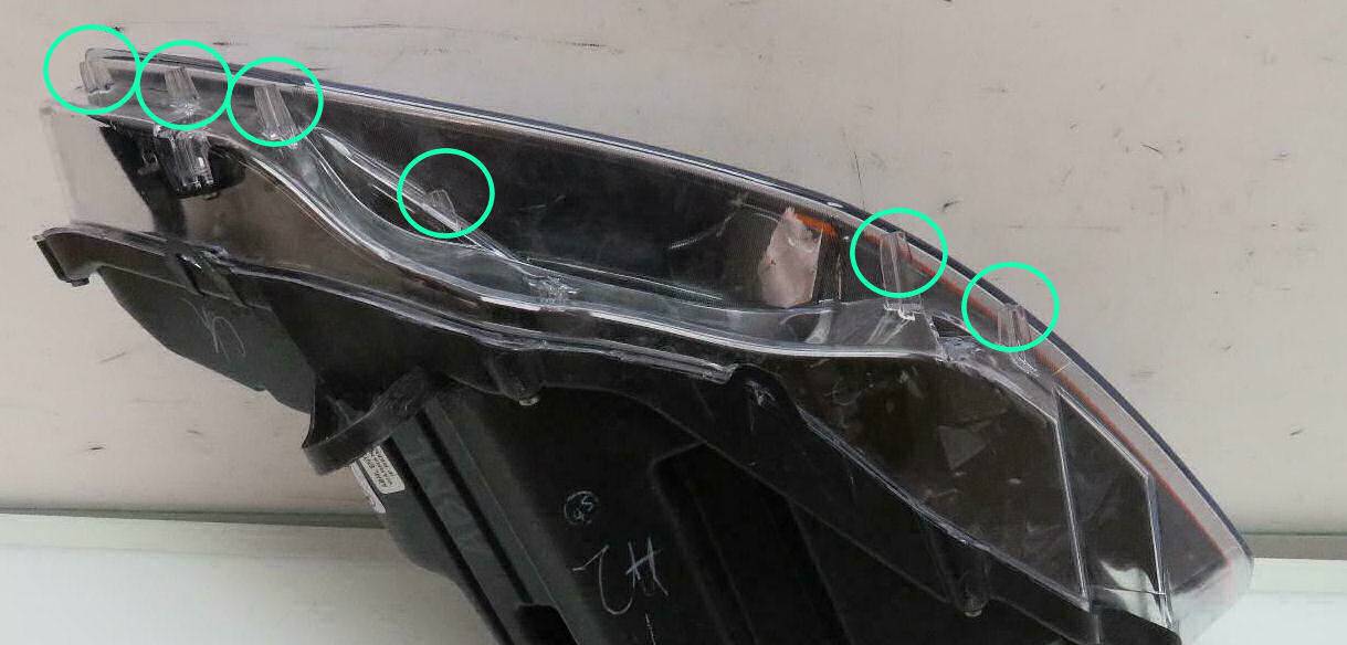

I went under the bumper again and I noticed that the lens has some support brackets and they are intact and holding up the bumper area by headlight designed to avoid droop or gaps, but maybe for some, the edge might need to be filed shorter if its actually pushing out the bumper away? Or some might have broken/missing support tabs?
Good investigative work!
So even if the bumper cover edge is properly secured into the lower edge of the headlight, due to weather conditions the urethane bumper covers (not front and rear) expand and contract due to temperature. There’s always going to be unevenness where the bumper covers meet either sheet metal edges or other plastics.
The above insight as to the headlight assembly having the tabs is good to know, it will close the gap to a point, but if the cover expands/contracts due to temps I think there’s always going to be a gap of sorts.
Plus if the bottom of the headlight assembly is in constant contact with the top surface of the bumper cover - it’s going to wear through the painted layer due to vibrations caused by driving and wind sheer...

In my case my (aftermarket) pax side area is little warped a bit over the headlight brackets, luckily the fwd part near the headlight is warped up so it presses up to close the gap more. I am thinking its all in the mold of the bumper as well and how it forms even over each guide pin on the headlight surface?

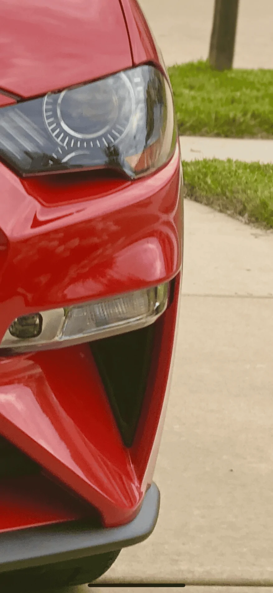

I hope you can make them to get it fixed. This is actually not my car, just a random one I saw at the dealership, so I went closer to check the area and it had the same gap as on my yellow car. A week before I checked the brand new model standing in the middle of their showroom, and it also had this gap. However, you can see models with almost no gap there. Not sure if this is a design flaw, or a QC issue at Flat Rock, but if the latter, the dealer should fix it. I was told that they could “fix” the gap, but not under warranty, and it’s likely to move back over time. It’s sad that Steeda’s aftermarket bumper has a better fitment than the OEM one.

My Bullitt doesn't have the glaring gap visible from above that some other cars have, but there's a gap on both sides that shouldn't be there. The good news is you can only see it if you lower your head. I'm sure if the headlight tabs are ground a little, the bumper would fit deeper into the headlights, for a better fit. But some bumpers just seem to have been cut short in that area IMO.
