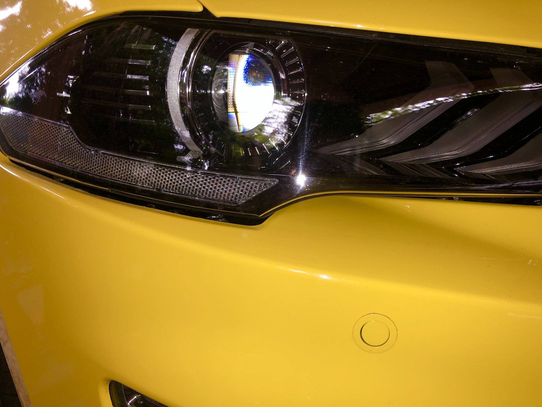

anyone have dealers fix this issue?? just curious if they would do something if I took it in

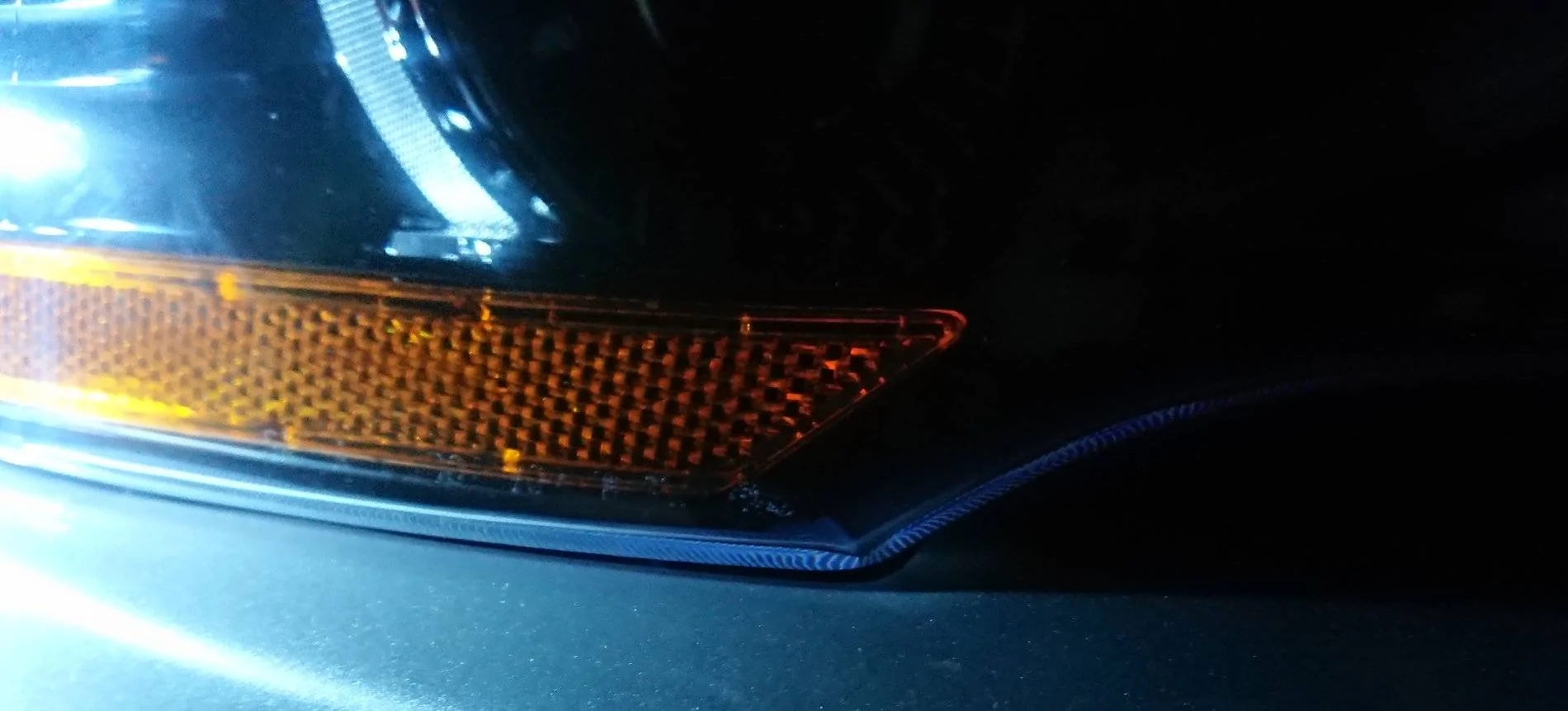

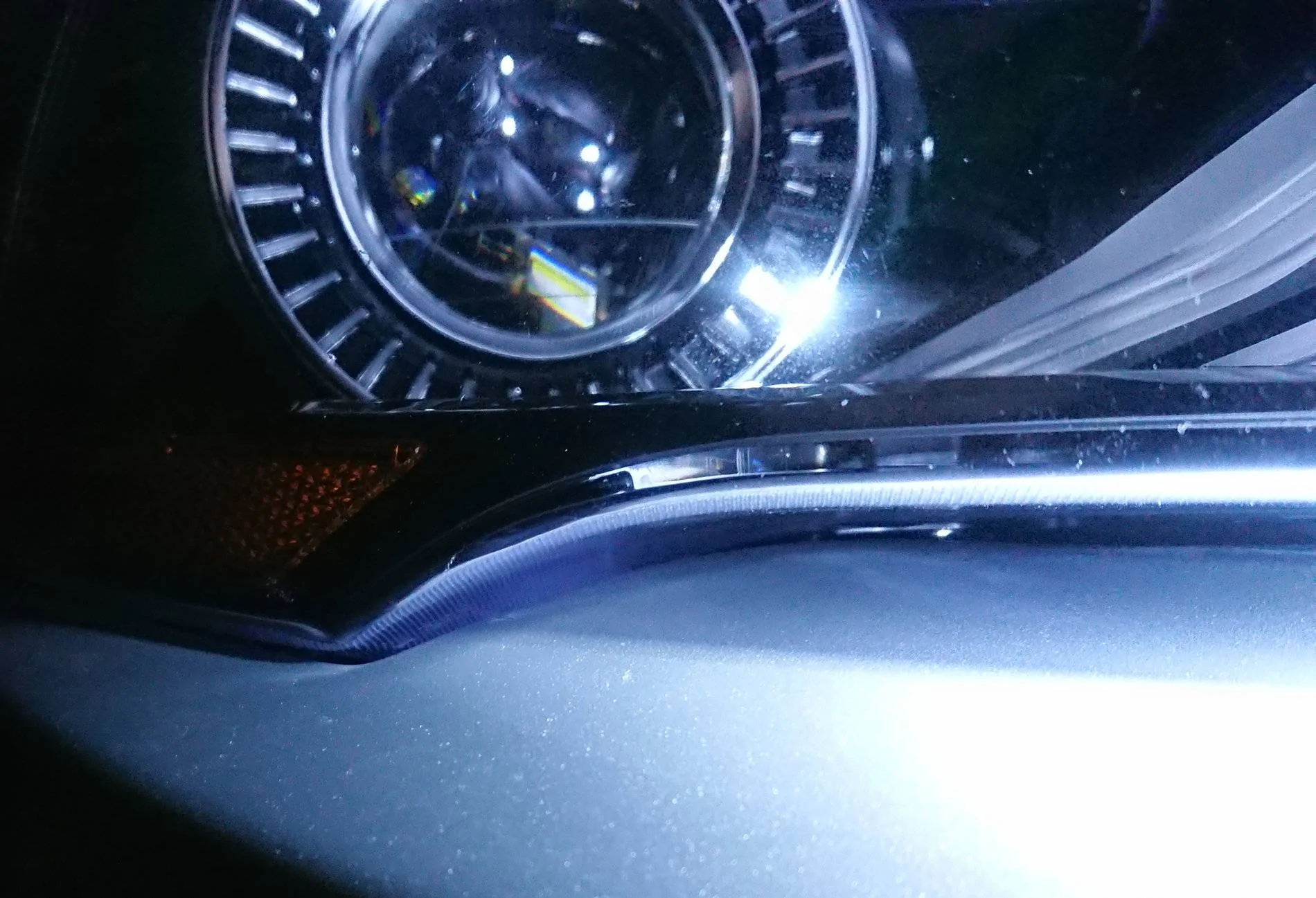

Too bad no warranty on my 19+ front bumper, I have the Steeda Q Front Fascia and actually If I really look hard, can see it only from the front edge and yes it is the pax side only as others have with factory bumpers. but its all tucked in below the headlight on the side. I do not want to mess with it to see if corner under lamp might move further up, but I noticed that what possibly could make it worse over time for some is when you wash the car or touch it, try to avoid the area that tucks in under the headlight. because that if pressed down or bent down over time, it possibly could make gap worse, I do see how the gap can be possibly eliminated is to try to get some foam piece support under that area that presses it up from the turn lamps to the surface under the headlight? Well for sure have to remove the entire bumper to get back to that area. I have actually got my hand into the engine bay and touched that area, there is a support bracket on the headlight that gives the bumper under the corner some support, but it all has to do with how good the molded pieces are perhaps?
I sure hope high speed driving does not affect it as it does for some aftermarket lower bumper pieces.
Mustangpursuit
Jan 17, 2017
57
1,570
629
California
Mustang GT/CS 2019
I went under the bumper again and I noticed that the lens has some support brackets and they are intact and holding up the bumper area by headlight designed to avoid droop or gaps, but maybe for some, the edge might need to be filed shorter if its actually pushing out the bumper away? Or some might have broken/missing support tabs?
