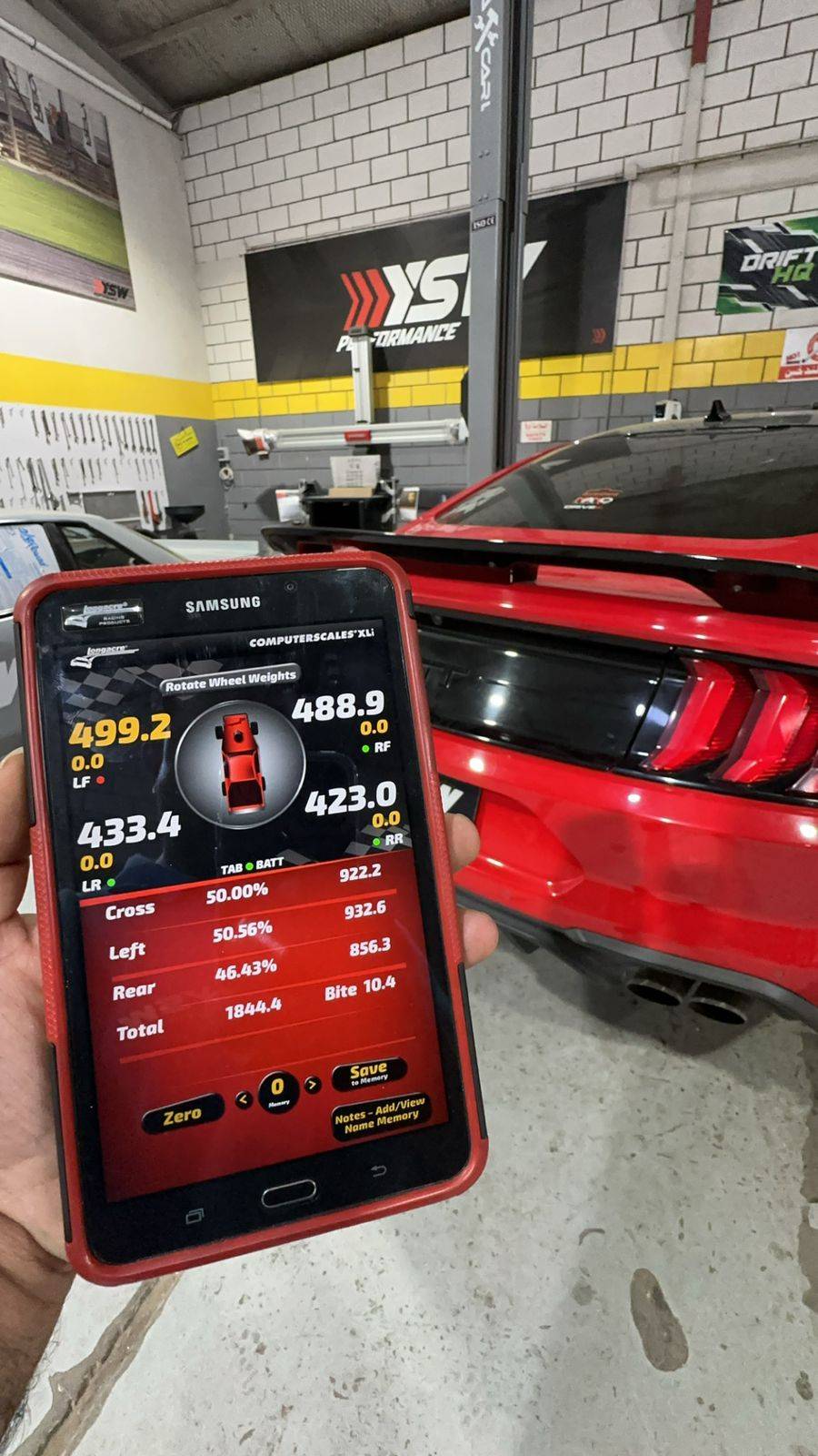

Hello guys so let me start with small intro to the matter, i bought a FA500 and installed it in my car 14k back 9 k front had a shop install them and even competed on the local time attack and missed the podium by a fraction over all was happy with the result.
The issue is i sent the car for corner balancing which the shop did an awesome job getting me 50% cross and almost 50% left, during the process he:
1-change the preload as to his comment one the front was very loose and wobbling
2-tightened the front steeda sway bar by one point due to the endlinks length was touching the body
Since i got the car back the softer setting feels like the hardest of 24 i can feel every bump every imperfection no matter how small and its breaking my back. Anyone have any idea what might be the cause or any recommendations cause now its not fun to daily anymore.

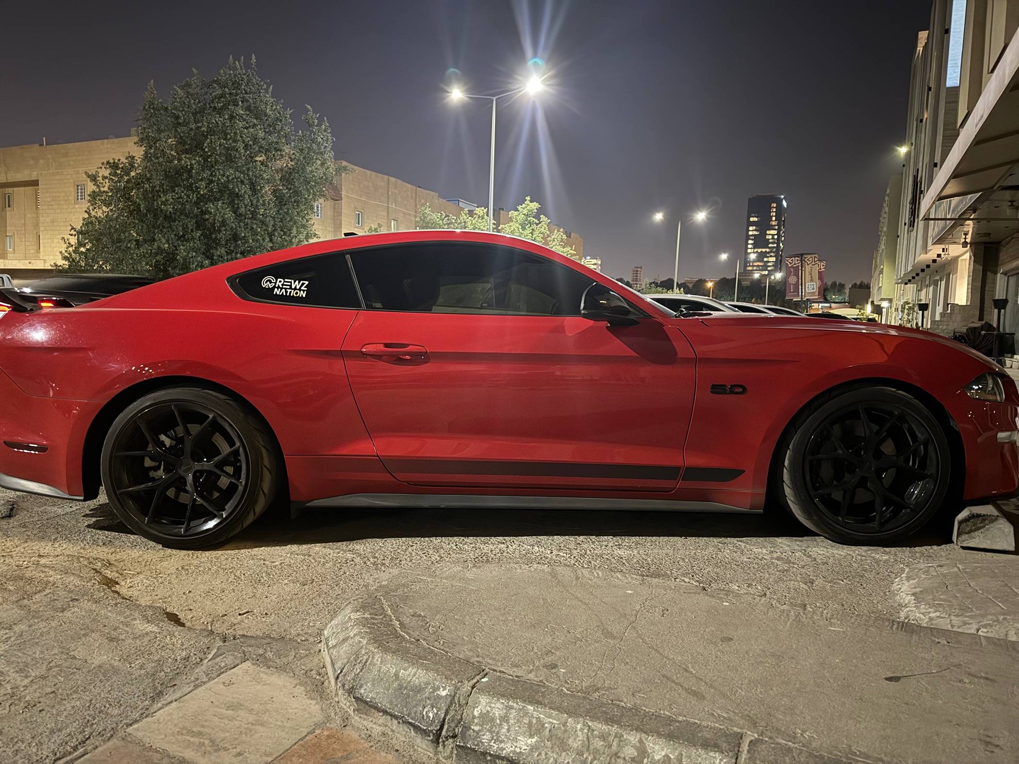

You described it best on high bumps the car bottom up on the front on the way down on the front even though i can sense it has more travel left on it and the harshness is more evident on low speed
I talked to the shop he said if i adjust the preload i will loose the balancing and i dont want to tbh so how do i adjust the prech? Also the shocks is at -24 back and front or fully soft setting
The reason i went with the 500 cause the car is daily first and track second car
Also here is the pic of car i just took its not that low
