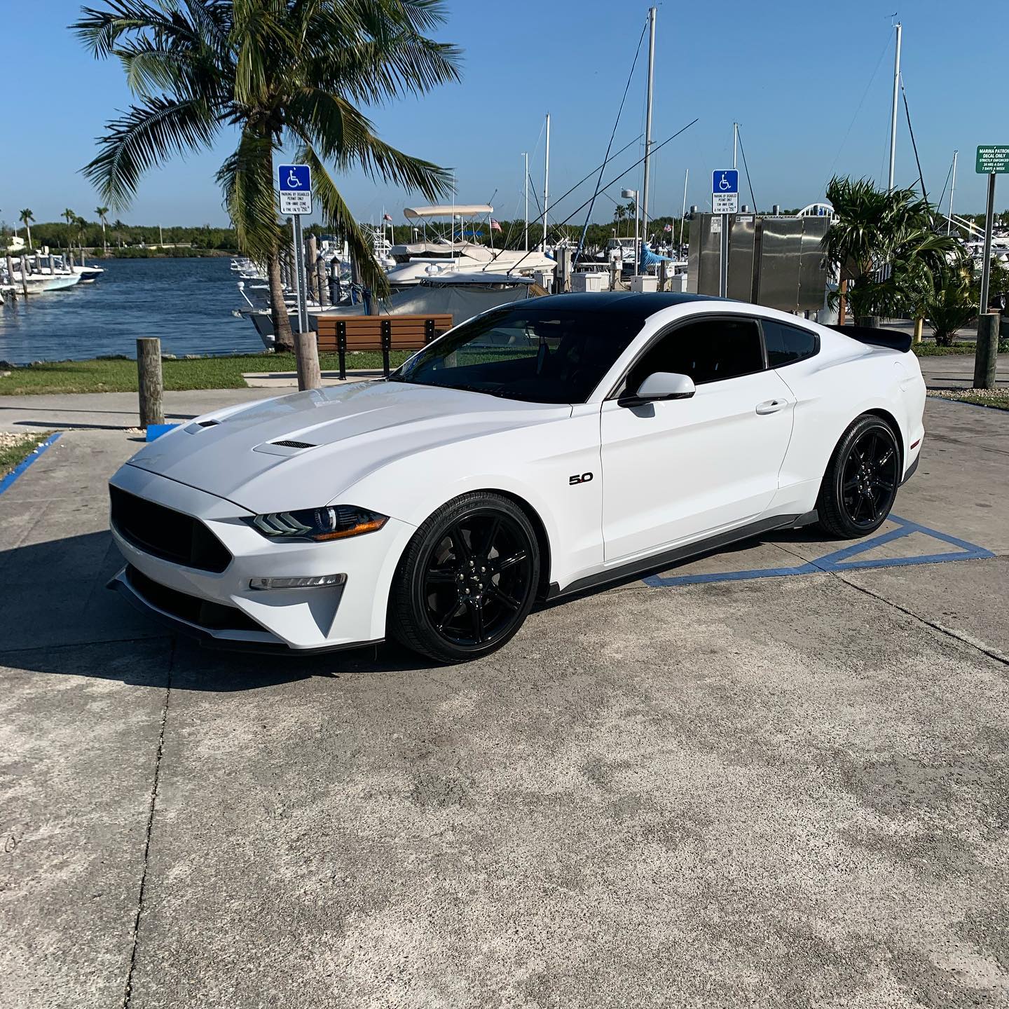

I have the same springs paired with non pp shocks as well and I would say we have the same ride height. The rear on mine sits high just like yours. It definitely gives it a rake look. It sits a bit weird but again I would say that your car is about the same as mine. Here's a pic, not the best angle but gives you an idea
Thanks for sharing a pic. Yes, definitely looks the same. Glad to know that it is close to where it needs to be after I have them make the minor adjustments above.
Here's another pic when the car had different wheels. I plan on getting rid of these and going steeda progressive.
