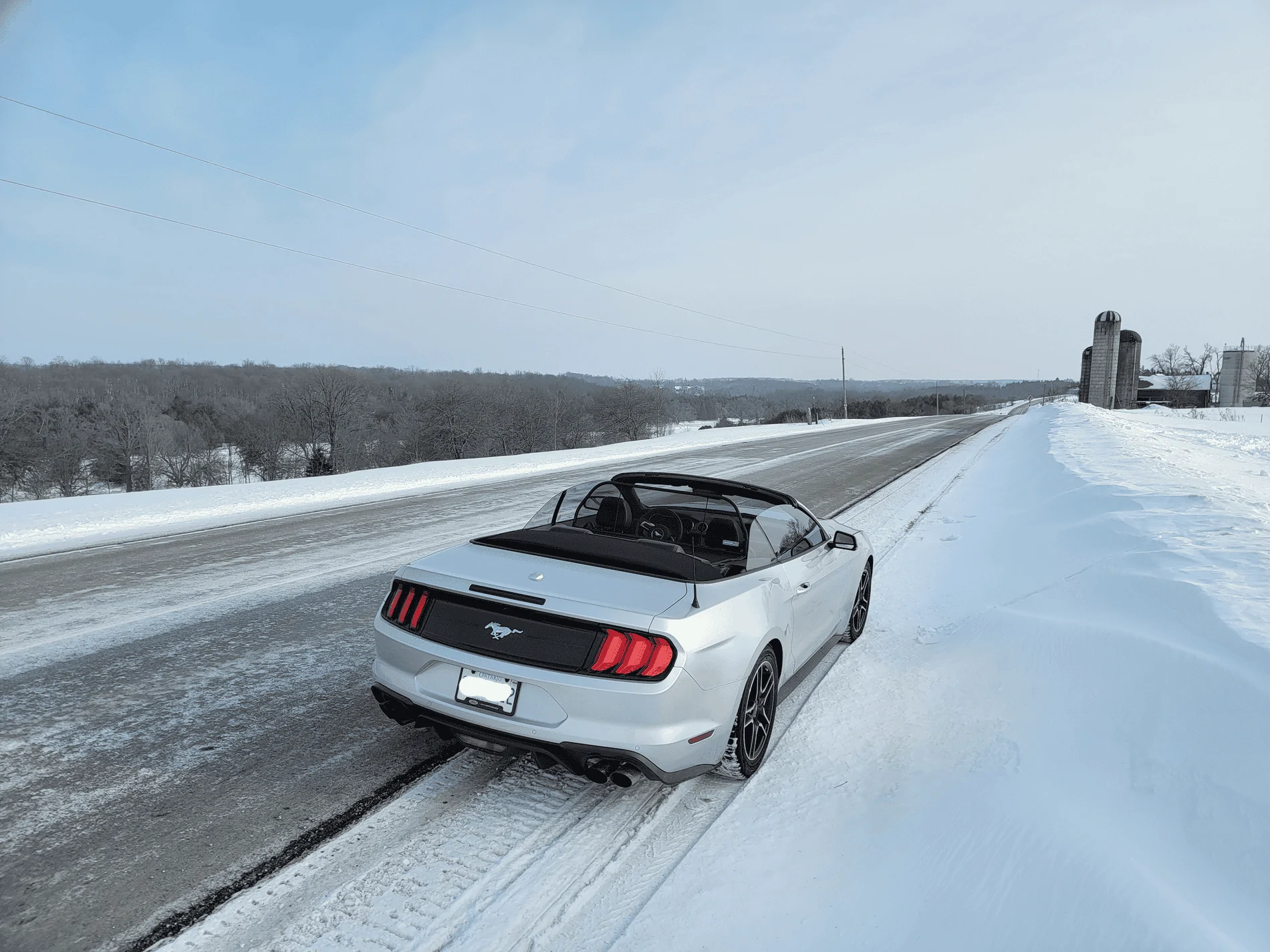

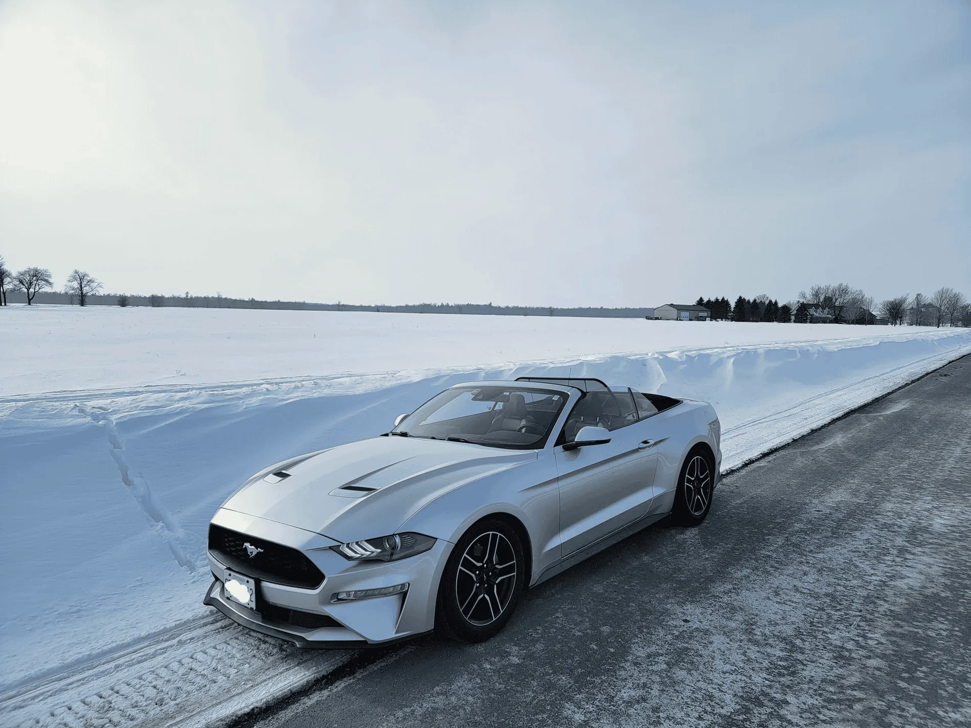

My impressions of the Ford Performance Track Handling Pack have been rather positive on my Convertible. I think I drove over 500km with it since I installed early January. Mostly backroads/highway and some city driving.
Also added the FP control front arm and the GT350 strut tower brace. Now it handles as a sports car should. I'm still driving with the 18's and winter tires... I expect even better handling once I swap to the Pirelis PS4 and the PP 19's next weekend =)
Some more details here:
https://www.mustangecoboost.net/thr...-ford-performance-upgrades.23100/#post-249000
Edit: Notice the gentle drop with the OEM 18's from the Premium package. (A backroad in southern Ontario - Jan/2021)
