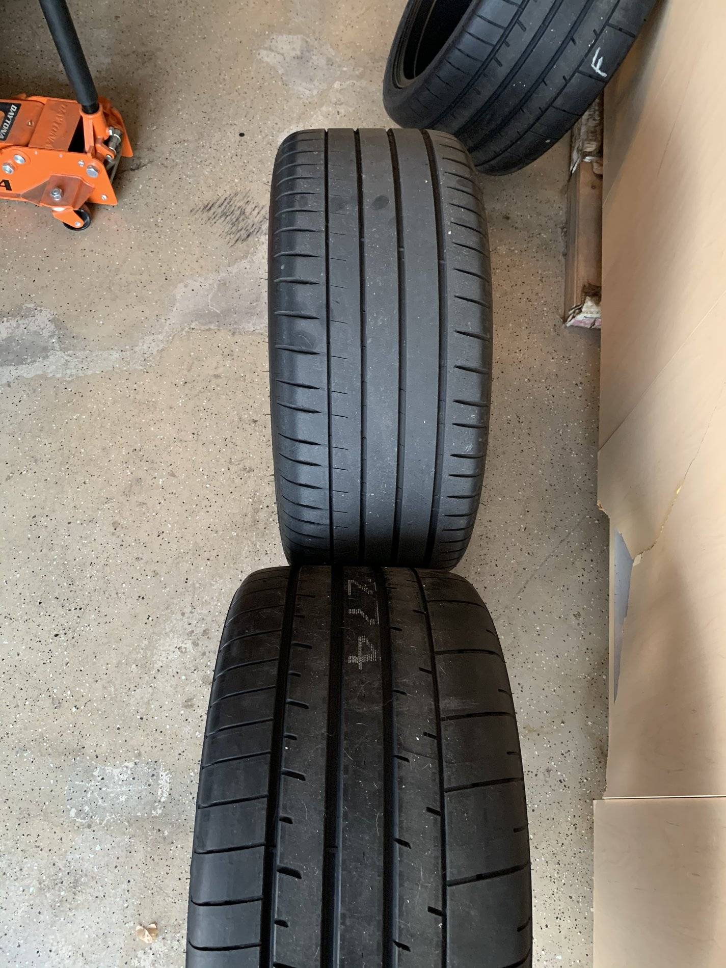

Interested in a set of the PP2 replicas for a GT premium used as a daily driver. Considering 9.5" in the front with 265/40, and 11.0" in the rear with 305/35--probably PSSS, so front and rears would all be 27.4". Would this work OK without spacers, rubbing, or any other issues? 10's in the rear would be fine but I want to avoid tire bulge with 305.

That should fit without issue. The 265/40 up front is barely larger than the stock 255/40 tire and the backspacing on the replica 9.5 should have even slightly more clearance than the OEM wheels. On the back there is plenty of space to run the 11” wheel with those tires.
However by going with those tires you are going to have the “look” of a square setup without having the square setup. Seems like you would be better off just going square.

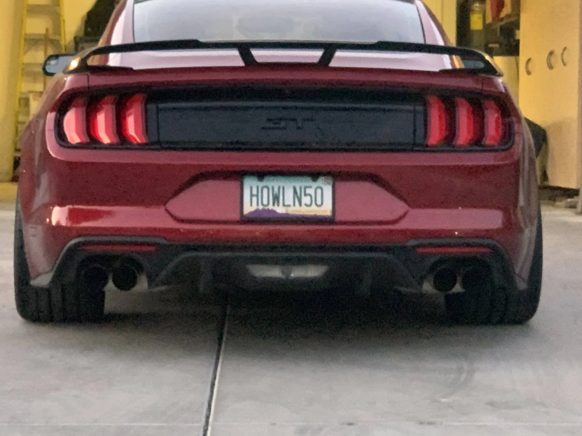

Just test fitted these wheels last night and went for a spirited test drive as this will be my track set. No contact or rubbing under a variety of braking and turning maneuvers. Currently on M-18000-F FRPP Shocks with BMR Handling Springs and -1.8 Camber in all 4 corners. Also have Steeda Roll Center Correction Lateral Links, Bump Steer Kit and Control Arms with spherical bearings for reference. Here are some pics on car and a width comparison of my PP1 Wheels and the PP2 rear wheels. I got the 10.5 inch wide up front and 11 inch wide in rear and 305/30/19 Goodyear F1 Supercar 3 tires. Purchased from our forum sponsor Levittown Ford. Shipping was also fast from PA to AZ. Excellent service from Benny and Levittown Ford. Bought the complete package including TPMS and tool to calibrate to car. Car seemed to recognize wheels and tire pressure without using tool. Hope this answer most question as I know I had a lot before I purchased. Thanks to Brian@BVMK for answering my questions on fitment. Wheels are a swap out for track day use. No spacers and no extended bolts for this application, but also no rotation unless you have a hook up to have tires dismounted from rims to rotate.

Those look real good, the drop from those springs work well with the 30-series tires. I think I would prefer a slightly taller tire... 305/35 would be perfect but either way looks great. Seeing your car is making me regret I didn't just go with a square setup like everyone was recommending! Oh well... I like mine too. How about a pick showing the front "poke"? Did you need any spacers?
I am with @MRGTX , the poke doesnt bother me, I actually kinda like it. Gives the car more of a muscled up stance especially when lowered a bit.

No spacers and I will get a pic next time wheels are on for a track day.
