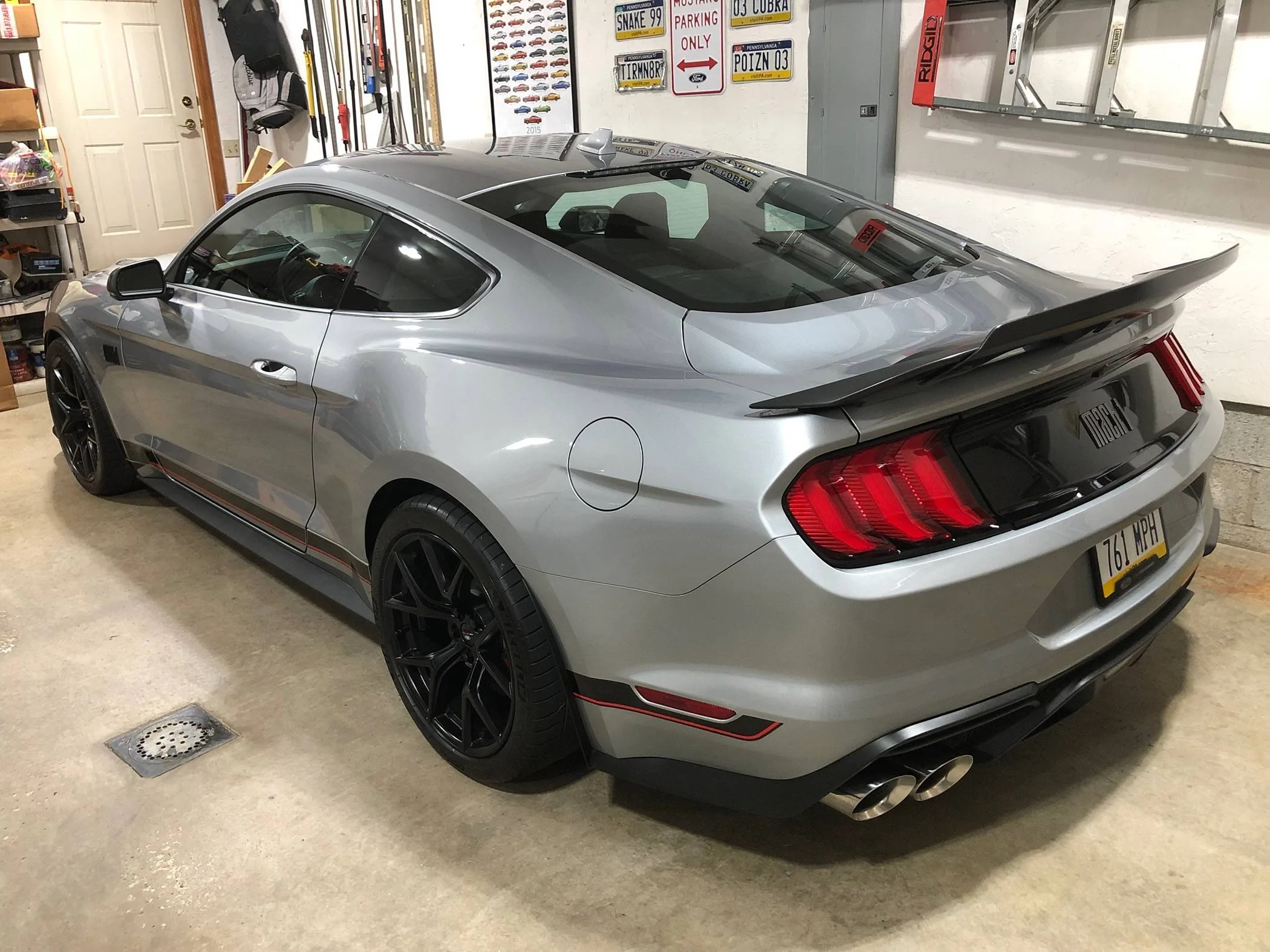

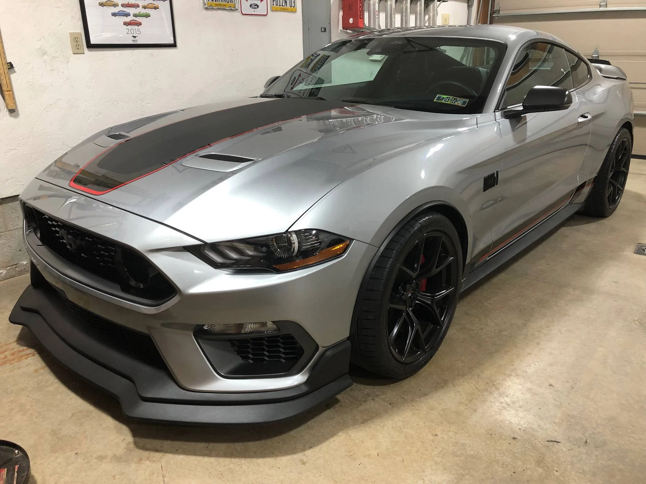

Ok i can't decide what i want to do here, I'm looking for a staggered setup on the HP Performance rims, 2019 Mustang GT, Roush supercharged, Peddlers extreme coil overs all around
Pretty sure i want to run 305 in the back, 275 / 285 up front. who has these rims and is running a good setup. This is a weekend sunny day fun car, no tracks just pure fun, roads aren't perfect around here so nervous going to 305/ 30 /19 catching a pothole tire choices are scarce at 305/35/19 too....

I’m running them in the 10.5 front / 11 rear setup with 305/30 and 315/30…
sweet, i'm looking for setups with 9.5 / 10 style i'm also lowered so just looking for someone who has a setup they like with those ford rims

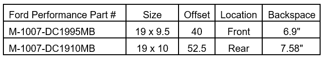

But if you just gotta, I have a set of the optional mach1 y-spoke wheels with rather less than 1000 miles on them. Pretty sure they are the 9.5/10 combo
