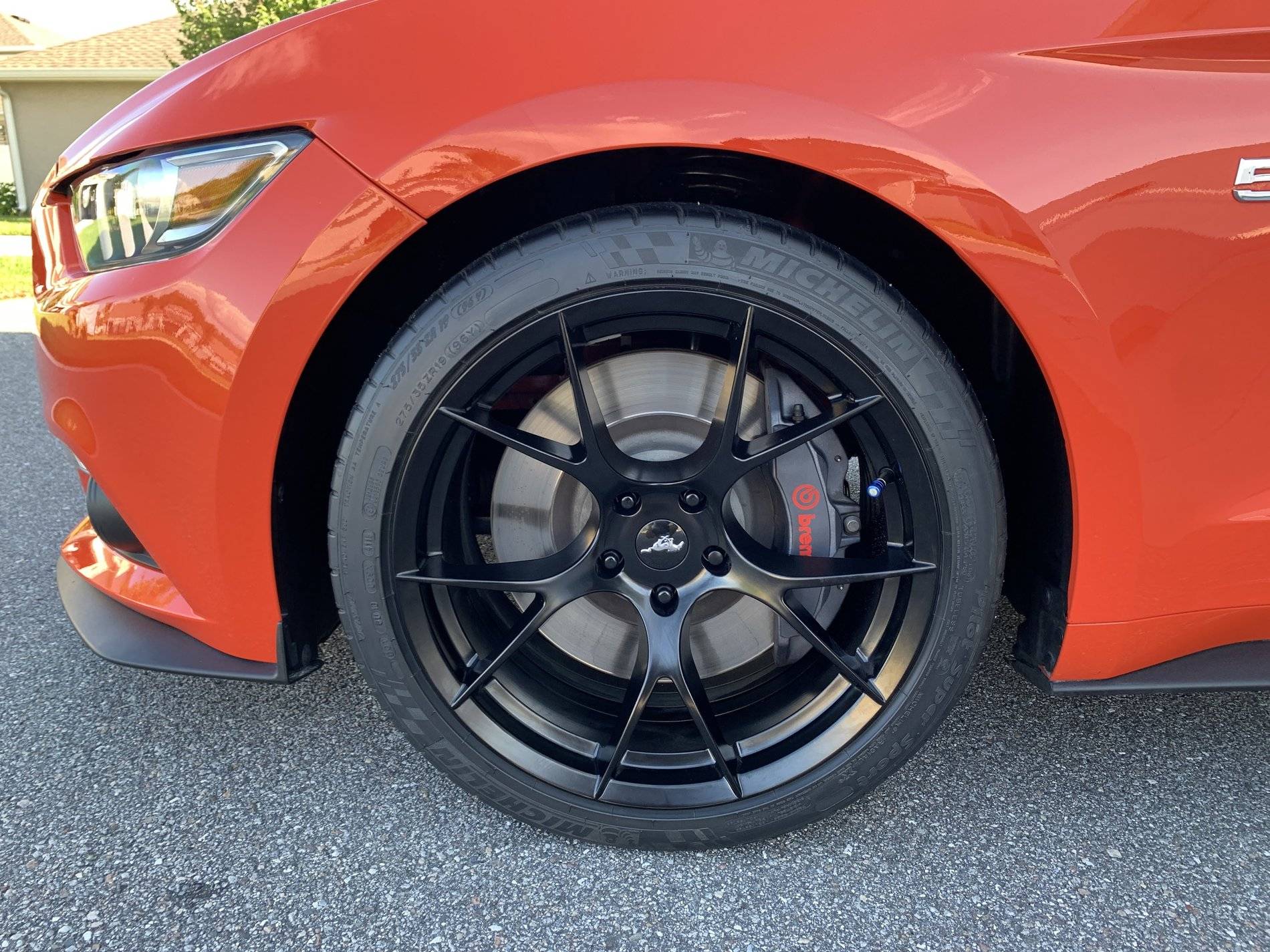

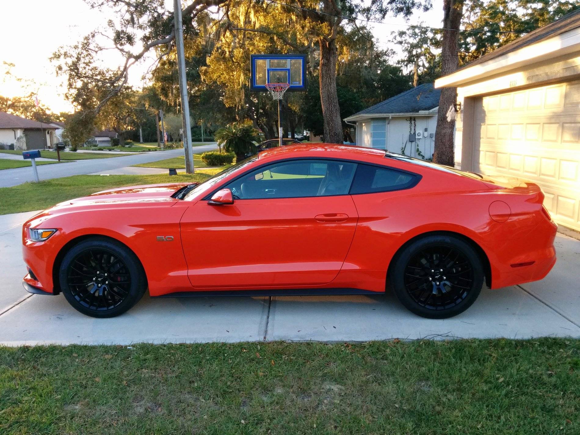

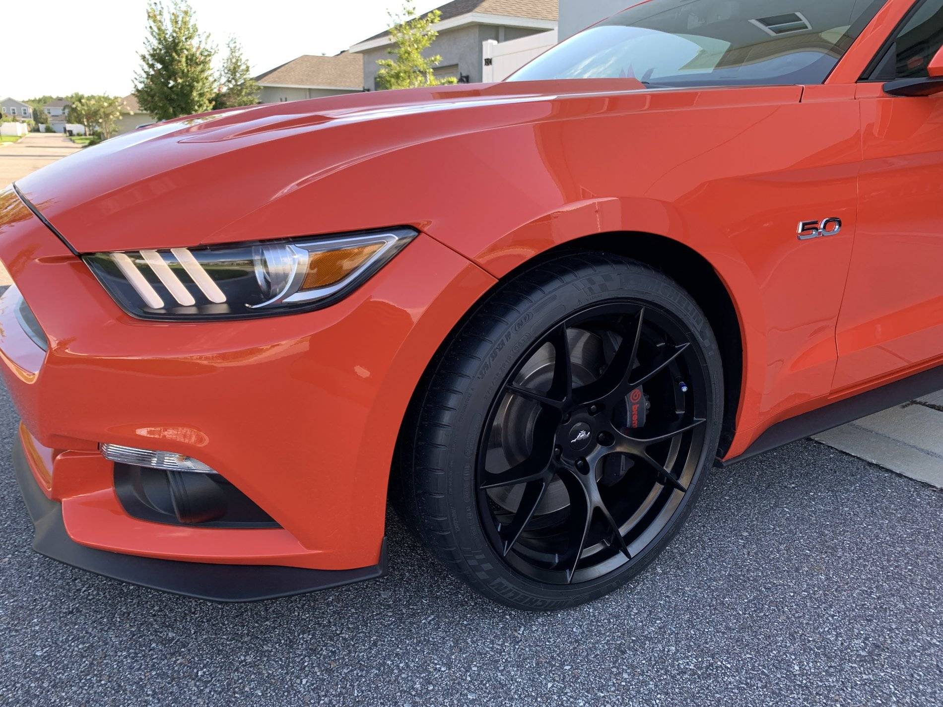

According to the tire specs, the stock Pirellis are 27.1" front and 27.8" rear. The new Super Sports are 26.6"/27.4"... so its about 1/2" in front and less than that in back. They also poke a bit more than stock... but I had spacers on the stock wheels so that wasnt a dramatic change, ended up about the same. Plus my original tires were worn a lot, especially in front.
So its probably more of an optical illusion than reality, but as soon as I got them on the car I saw there was just a bit too much wheel gap in front than there should be. And I am definitely not one of those guys that thinks any wheel gap is wrong. I really don't like lowered cars and I was very happy with the look of the stock tires (with the spacers anyway). So if I think there is too much gap, then there is really too much gap. I am looking at getting the minimal drop Steeda springs to drop it a half inch. Then I might get the Steeda spacers to raise the back back to close to stock, because I think the backs look good now, just the fronts really have the issue. Going to see how they look before making that decision.
Stock wheels and tires:
New wheels:
That number doesn't sound right, what size front tires did you get? Using your numbers though, it's still only 0.25" front and 0.20 difference in the back. You're looking at the diameter, half the difference is at the top of the tire and the other half is at the bottom, the bottom half doesn't change the clearance at the fender so divide the difference in diameter by 2.
Excellent point yes! As I said, it’s probably an optical illusion more than anything.
I have 275/35 on front, so the sidewall height should be 96.2mm vs 102mm for the stock tires. So 1/4” as you said. It’s even closer on the back. It’s also why I chose these tire sizes specifically, to go wider while maintaining the sidewall ratio front to rear and be as close to stock as I could get. Norm helped a lot with advice a few months back! I put a ton of research into this... I have a spreadsheet with basically every tire that fits our cars and these are the closest you can get. I did this so I wouldn’t have to lower the car.
I haven’t purchased the springs yet... still deciding if I want to just do springs or go for new struts at the same time. Maybe it will settle in or maybe I will just get used to the look. A lot of guys think the stock car is too high anyway so maybe that 1/4” just made it noticeable to me!
