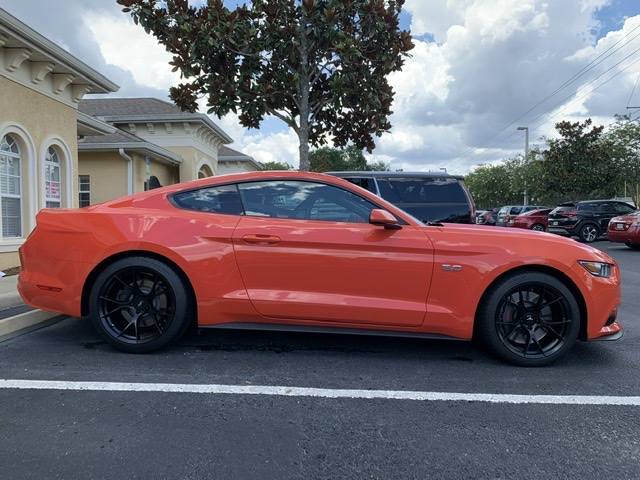

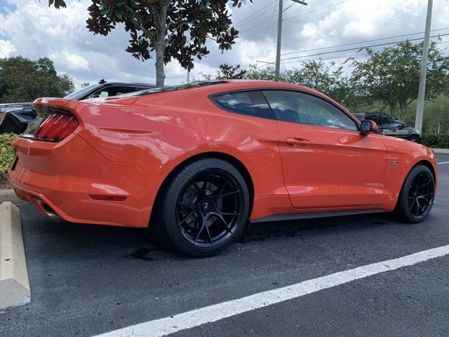

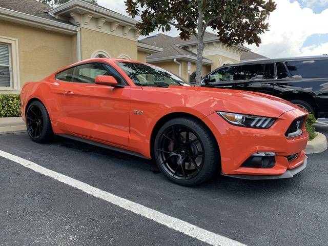

So has anyone ran the 19x10.5's and 19x11 wheels on a 2015 thru 2017 car? I have noticed one person in this thread did, but he was running 305/30 tires, I was planning on running GT350 tire sizes, 295/35 and 305/35. (Would rather have the extra sidewall and tire height) There is a member on here that is running those tire sizes on a 2018 with OEM PP2 wheels, but not sure how different the front fenders/inner liners are between 2018 and newer and 2015 thru 2017's. I have a 2017 that is lowered one inch. My mustang is street driven and I do plan on adding some additional front camber, but don't want to get to crazy, planning on 1.5 to 1.75 degrees at the most. I don't think i will have any issues with the 305/35 rears with a 48 mm offset, but concerned about the 295/35's on the front with a 24mm offset. Just curious if anyone has any input with a 295/35 tire, 24 mm offset on the front of a 2017 GT.

I am running 19x10/19x11 wheels with 275/35 and 305/35 tires. I wanted the extra sidewall height too. Not exactly what you were looking for but close...
I didn’t want to lower the car before but now I think it needs a slight drop to fill out the wheel wells.
I almost wish I had gotten 19x9.5/19x10 and stuck with tire sizes the same as stock PP1 tires with 40 series sidewalls. They fit the wheel wells perfectly without lowering and they are still plenty wide. And I wouldn’t have had to spend more money on lowering.
