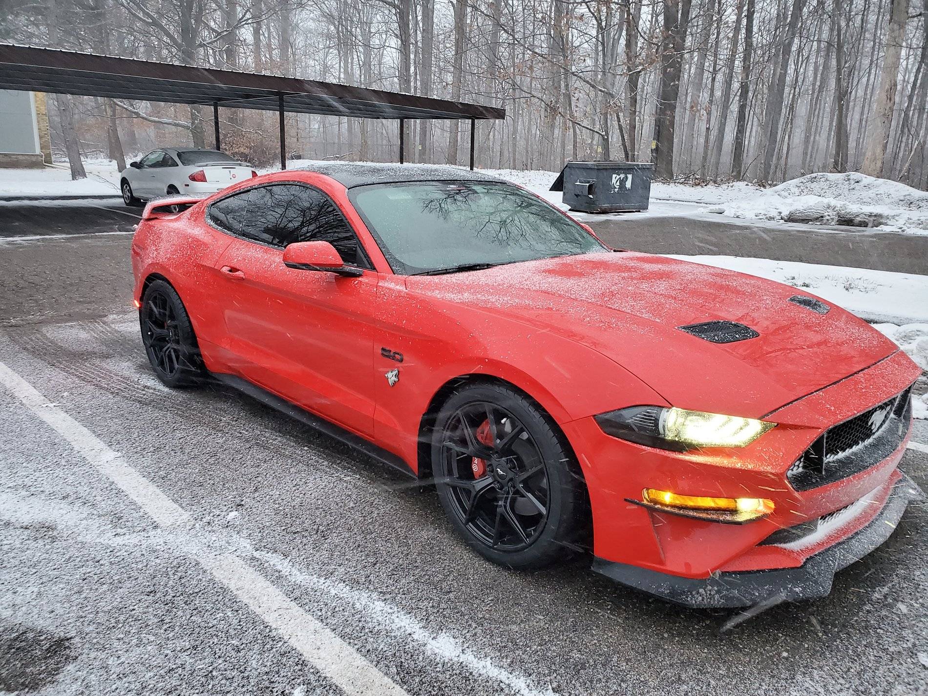

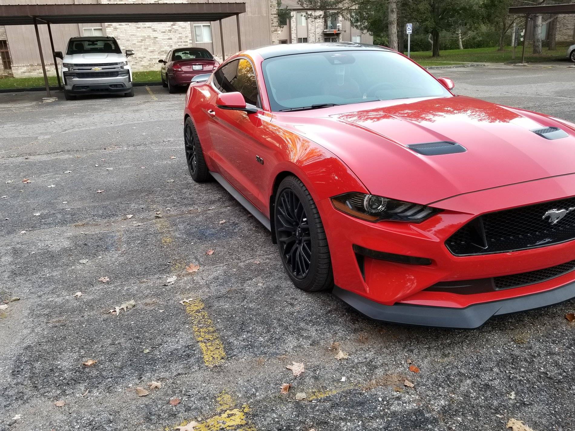

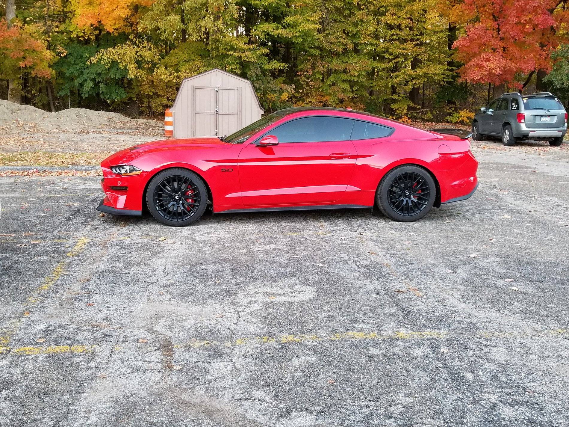

For reference, here is mine 19x10 squared setup offset +35 running Goodyear Exhilarate A/S 285/35/19. I'm lowered 1" on FP Track springs
My previous setup was OEM PP wheels with 25 and 20 mm spacers. (last 2 pics)

There's more wheel gap with the new setup but it's worth the trade off. There are lot of options in 285/35 size. And I could really feel the difference reducing around 35 lbs of unsprung weight with these lighter wheels. With the squared setup, car feels more nimble and improved steering response

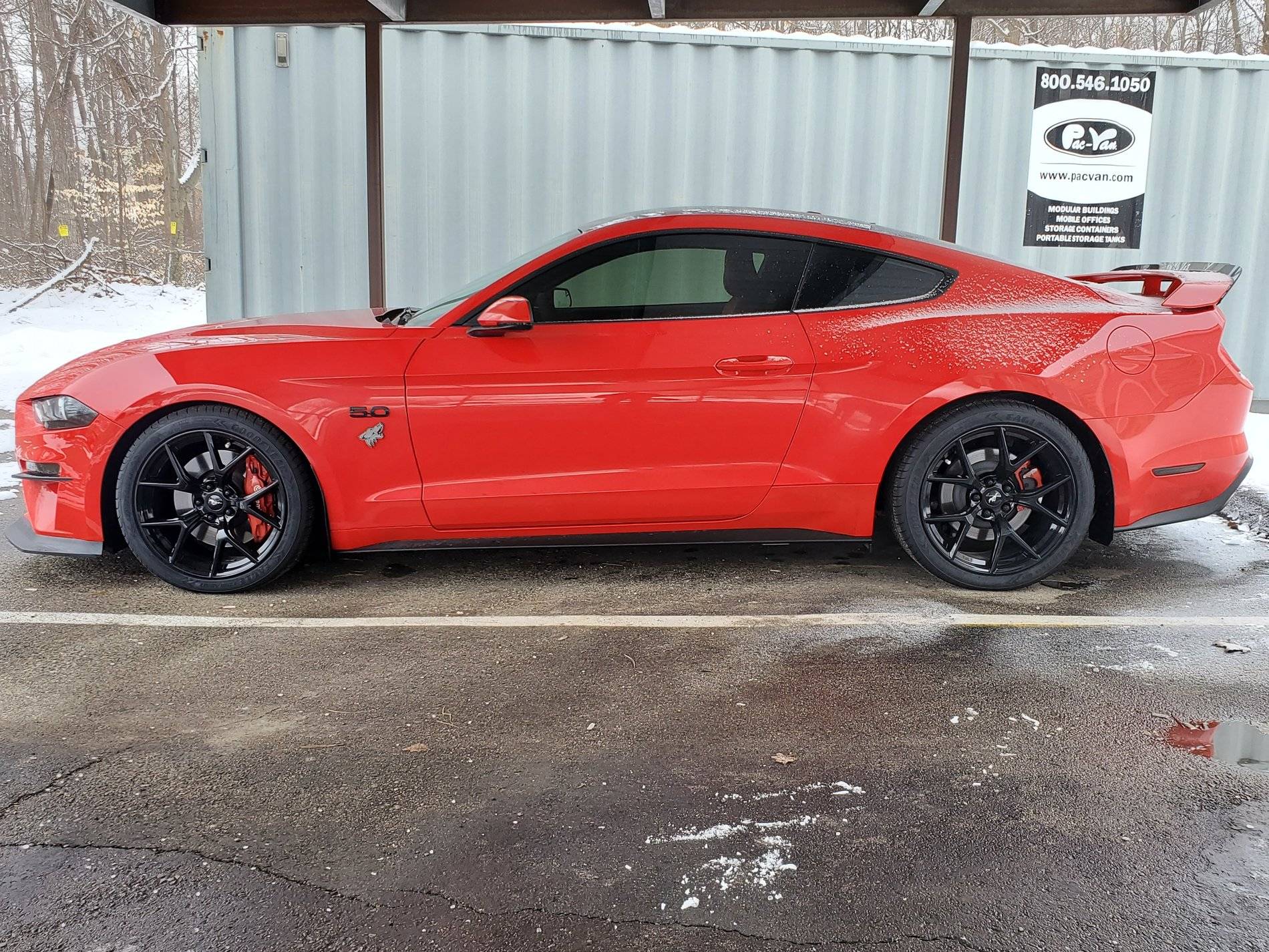

I'm running these Ford Performance wheels in the PP2 sizes. 10.5 and 11 wide with 305/30 sport cup 2's.
-Tony
Nice. Do you have a front/rear pic to show off the poke? It looks more flush than the 18+ pp2.
