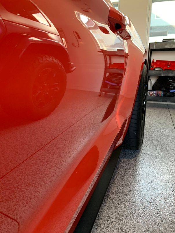

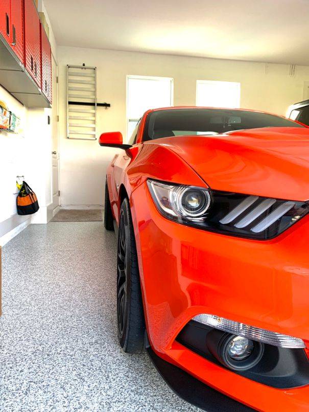

do you mind posting some pics of your setup?? I was planning to drop to a 35 profile but maybe that’s a mistake.
I have been playing around with the offset calculators and I guess I already have an “aggressive” fitment. My stock wheels with 25mm spacers sit out farther than the SVE 10/11 setup and I like how it looks now. It’s hard to find a set of wider wheels that will sit the same way without some creative use of spacers. I think I can run rear wheels on the front with the spacers and end up with the same flushness.

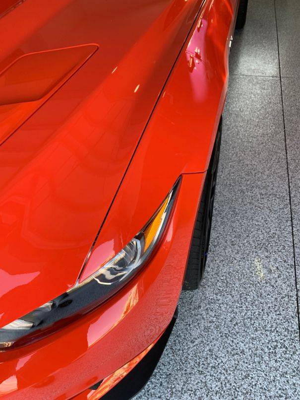

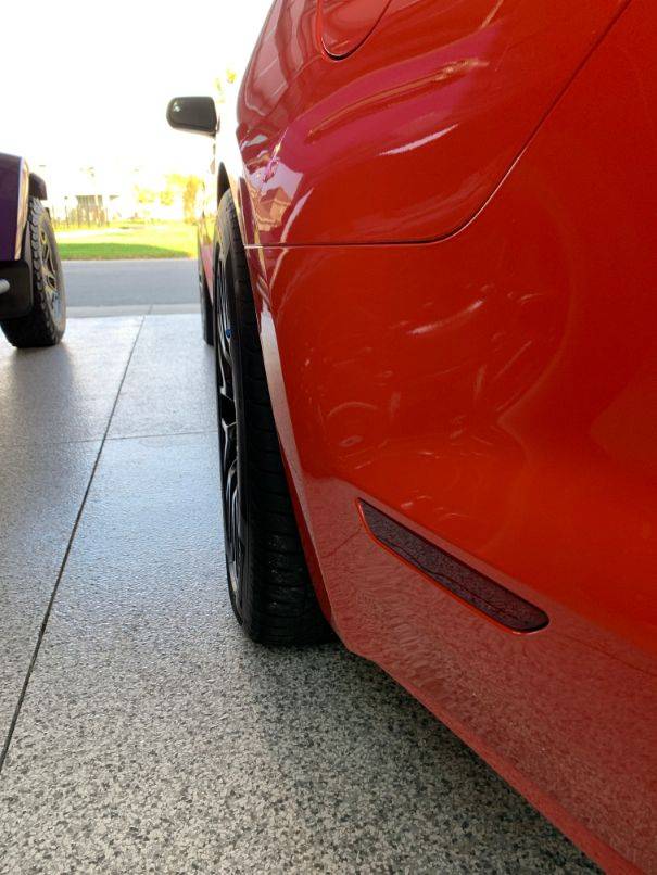

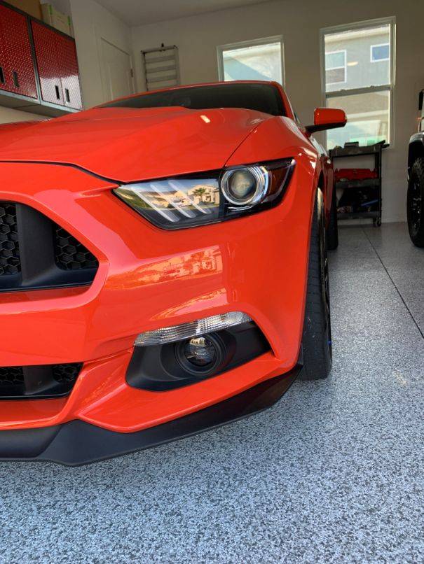

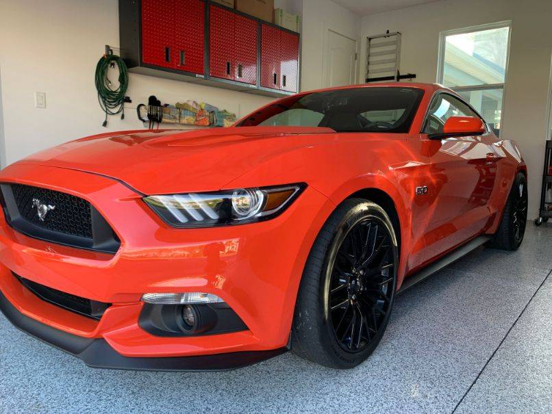

Pics of my current setup...
I made a typo on my previous post. I have 285/35/19 tires. The wheels have a similar stance to your car, but since my car is black, it's hard to see the poke, but I'll try to post some pics along with a side pic.
