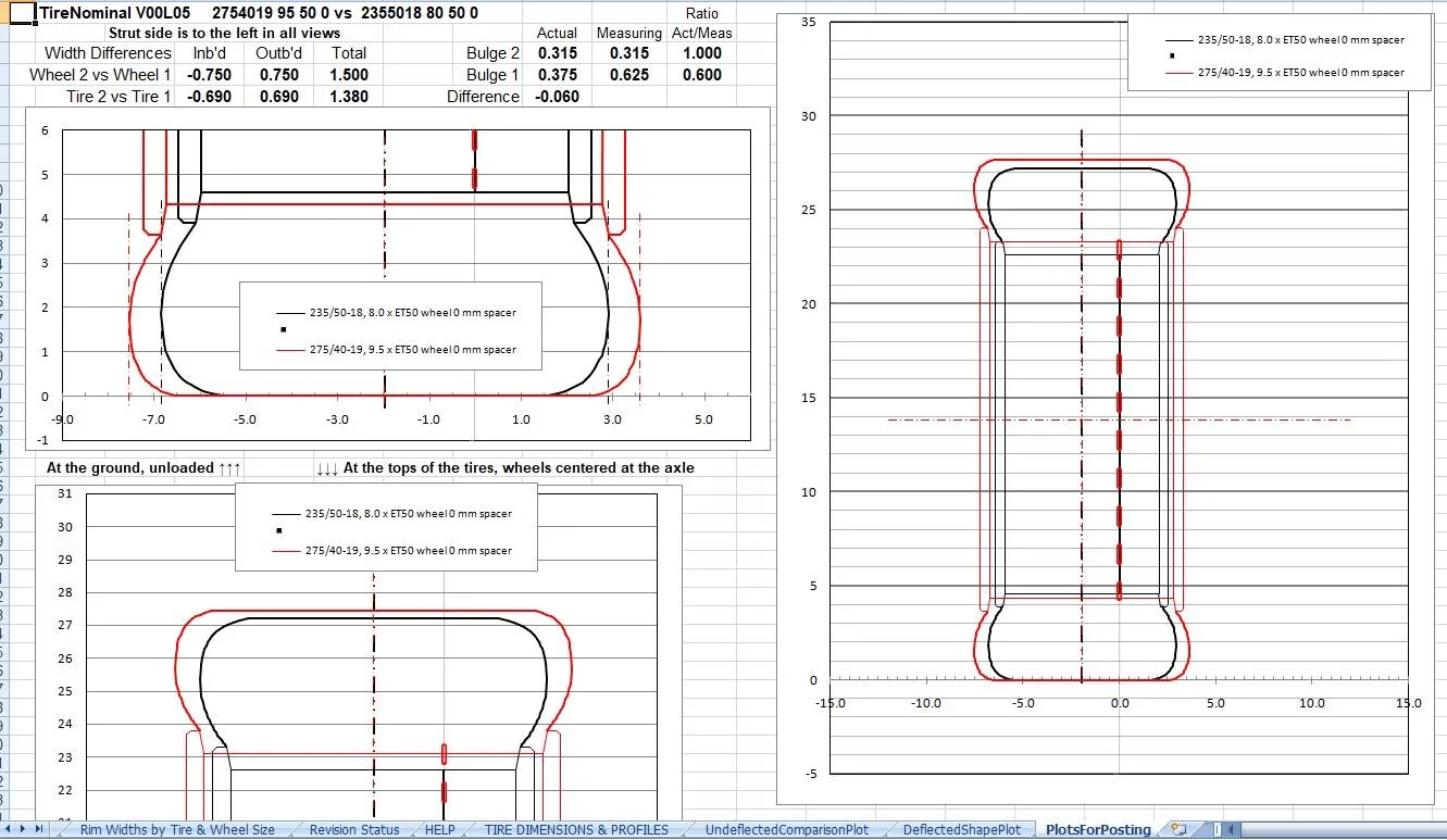

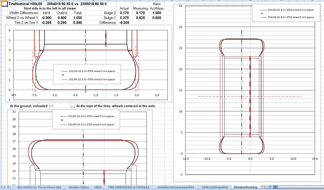

For what you're describing, I'd look for 275 tires on wheels either 9.5" or 10" wide. For full rotation, you may need to consider running spacers on the front, with wheel offsets chosen to suit the rear. 255/xx on 9" wheels may not give you as much change in appearance as you're looking for.

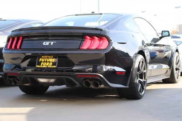

I found these on the internet. Looks like these new wheels. Can someone tell me if these are the the 9.5 / 10 inch staggered combo? What size tires do these look like?
It definitely looks like the 9.5 / 10 inch staggered combo. The rear looks like a 295 tire. I'll see if I can find out the wheel/tire specs.

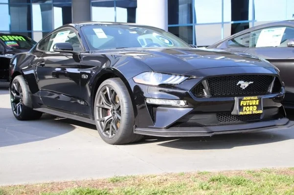

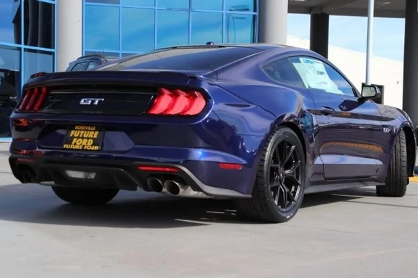

Here's a PP2 for comparison from that same dealer's webpage. You can tell the PP2 has larger wheels:
https://www.futureford.com/new-Roseville-2020-Ford-Mustang-GT+Premium-1FA6P8CF6L5118409

Cool, I think I might be interested in the 9.5 / 10 inch setup. I like the finish of the wheels and don't like poke of the 10.5 / 11 inch PP2 setup. You might be able to run the PP1 tire setup too with the 255/40 and 275/40 sizes. Although I'd probably go 265/40 in the front because of the 9.5 inch wheel.
Those look like nittos g2 and bulge quite a bit in the rear. Probably 285 front, 305 rear
