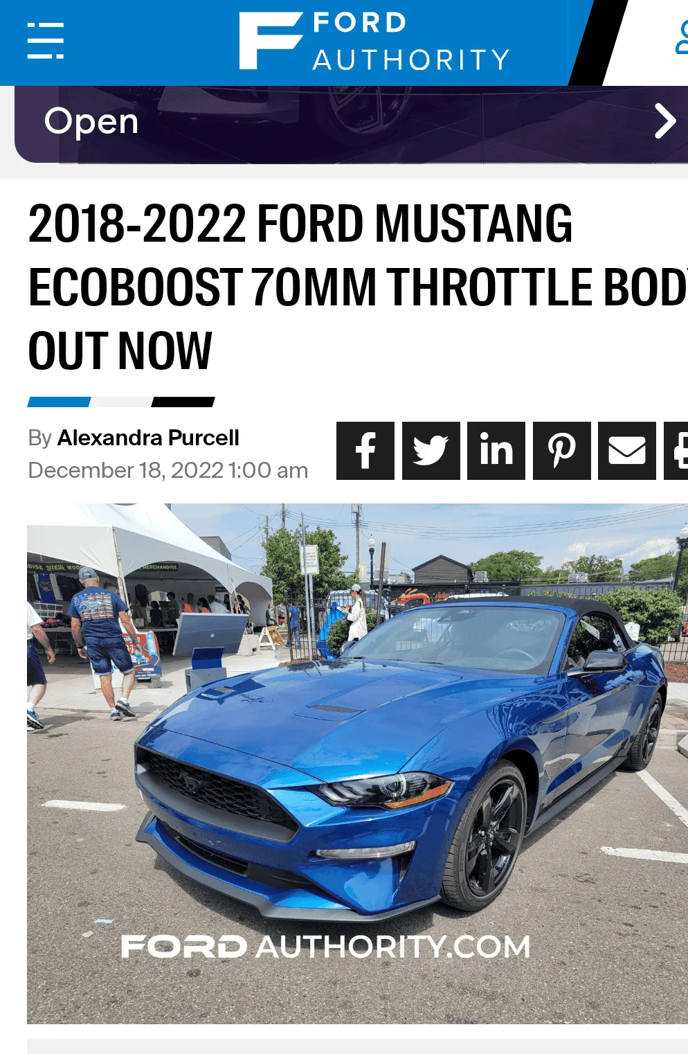

No part number shown in the ford authority article so have no specs on what actual gains you will get for 790.00 bucks. It is nice that they say plug and play but call me a skeptic since my issue with the FP tune, I had installed on my eco. I have no faith in FP anymore. It also states the new throttle body may not be street legal in some areas.
Just found this part number but no dyno numbers. This is likely not the same as the throttle body listed in the article since it states for 2015-17 models. I have measured my stock throttle body and intake inlet diameters and can say the throttle body is 60mm before the throttle blade and then has a taper after it up to 63mm and the intake plenum inlet is 70mm, so the new throttle body will be the same diameter as the intakes opening which should allow for more airflow.
2.3L ECOBOOST 70MM BILLET THROTTLE BODY| Part Details for M-9926-M2370 | Ford Performance Parts

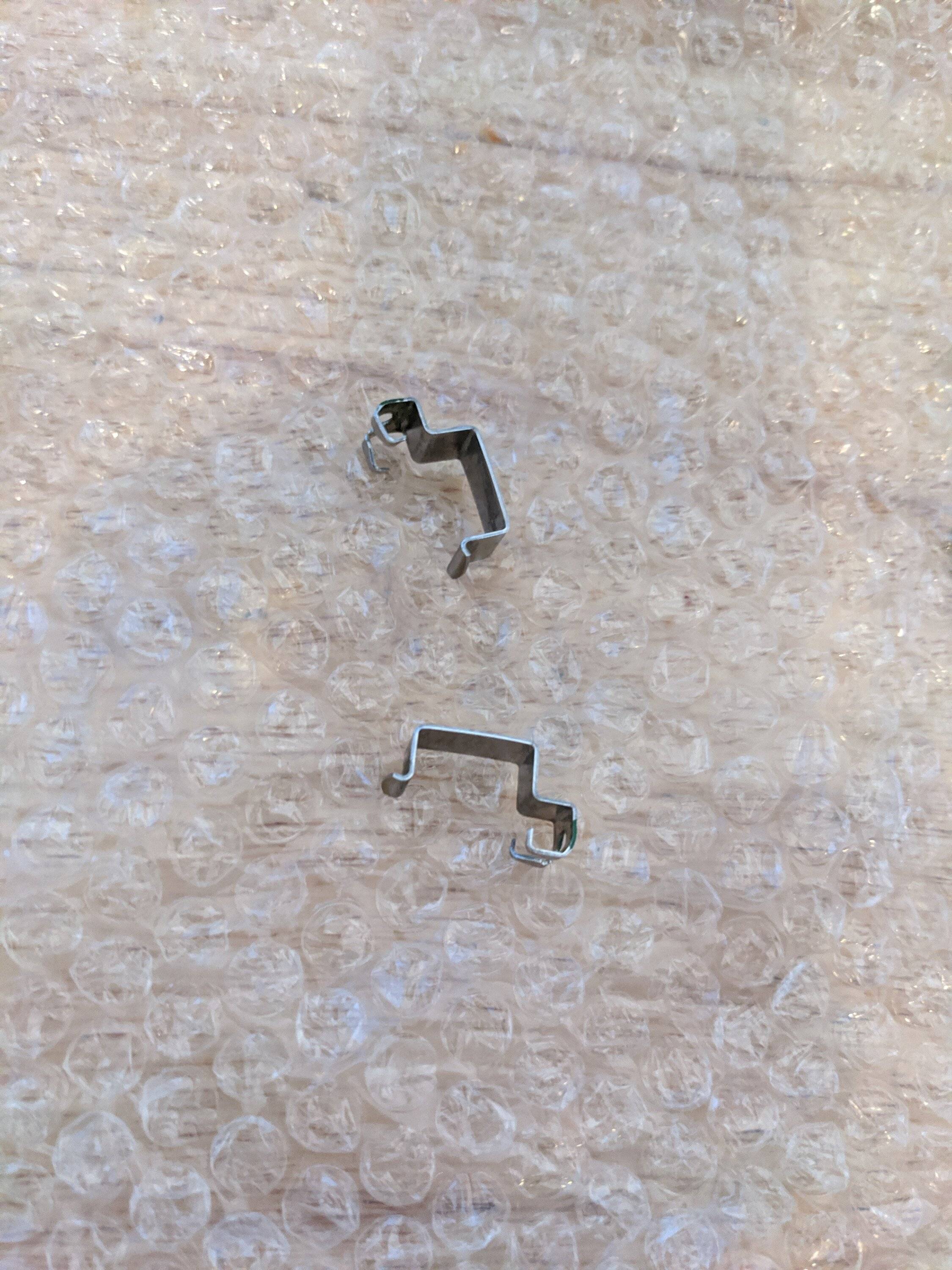

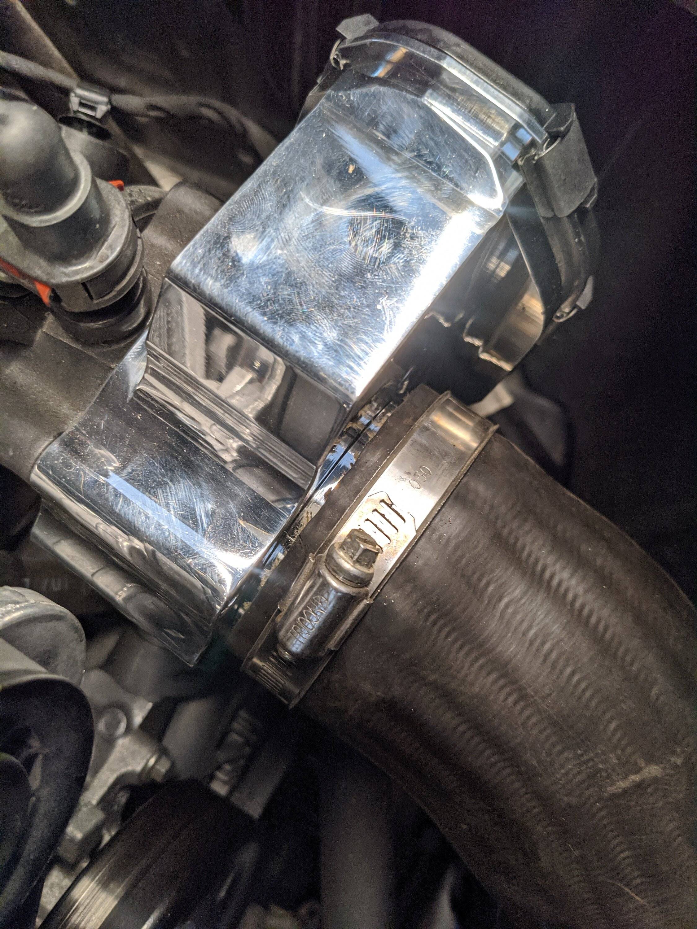

Installed the new throttle body yesterday. Looks beautiful. I have noticed a very minor increase in throttle response. The engine feels like it builds power more smoothly and has a slightly different note. The biggest thing I felt was when the car gets into overdrive - it feels like the car bogs down less.
Removing and mounting the new part was super easy. The hardest part was attaching the hose to the face of the new body. That was absolutely awful. Why Ford designed the clips the way they did I have no idea. So, I removed 2/3 of them. If I didn't - I doubt I would have been able to get the hose back on (I currently have a pretty bad elbow injury making this install worse)
Had to remove these little monsters. If I kept them inplace - there was no way I was ever going to be able to get the hose on.
Install is stupidly easy. Instead of forcing the cold side pipe onto the TB after installing the TB, loosely install the pipe onto the TB BEFORE you mount the TB. Makes the process so much easier. Took me about 15 minutes start to finish (including the airbox) once I figured out that trick.
I should have checked here first. This might have saved some cursing :crackup:
