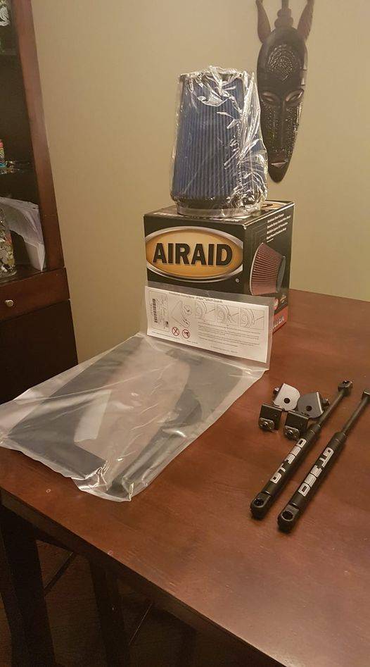

Put the Ford Perf struts on my '16 GT within months of getting her - no issues at all and still going strong almost 5yrs in
