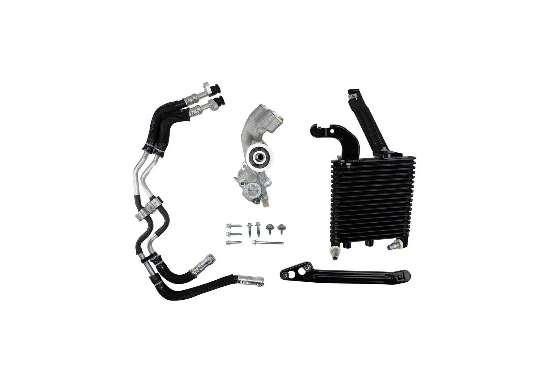

Seeing as how it's mainly for a 24+, I doubt very many people on here actually installed it. You may want to check on the 7G website. Although I'm sure it can be made to fit, I imagine most people go with some sort of aftermarket unit if they are going to have to fiddle with it.

The underbelly pan on the S650 needed a little trimming to account for the backet. I don't think an S550 would have it that issue. As part of the install, I cut holes in the fender liner to allow air flow through the cooler. I tried an aftermarket fender liner, because the OEM PP lines weren't available, but that wasn't great in quality and it tore from tire contact.
I have measured temps of 148F vs 183F on the hoses coming out of the filter housing. So, it's working. I typically see about a 25-30 degree drop across the cooler tubes, from one side to the other. Since our oil temp is inferred, and not measured directly, there's no way update the algorithm, yet. But, it does factor in head temps and pressure, which are measured.
I do see an idle oil pressure change. Before it would idle in the lower 20s, now it's in the upper 20s, for daily driving. That make sense if the temps are cooler, IMO.

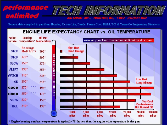

So you believe a charts created by people that sell coolers???
Lot of wrong info in it
175 and 195 temperatures equal long engine life????

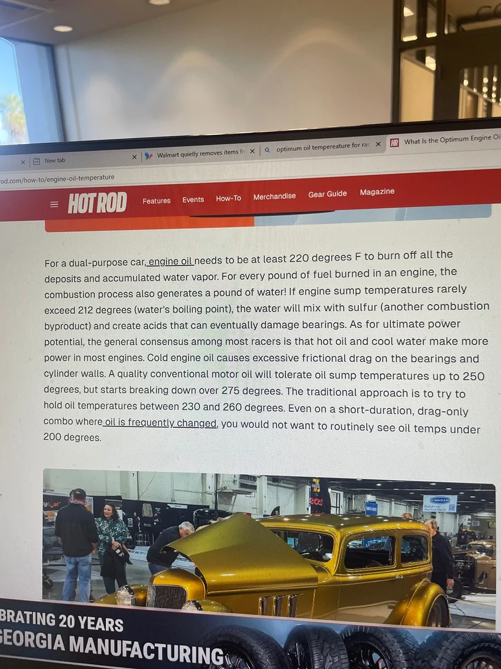

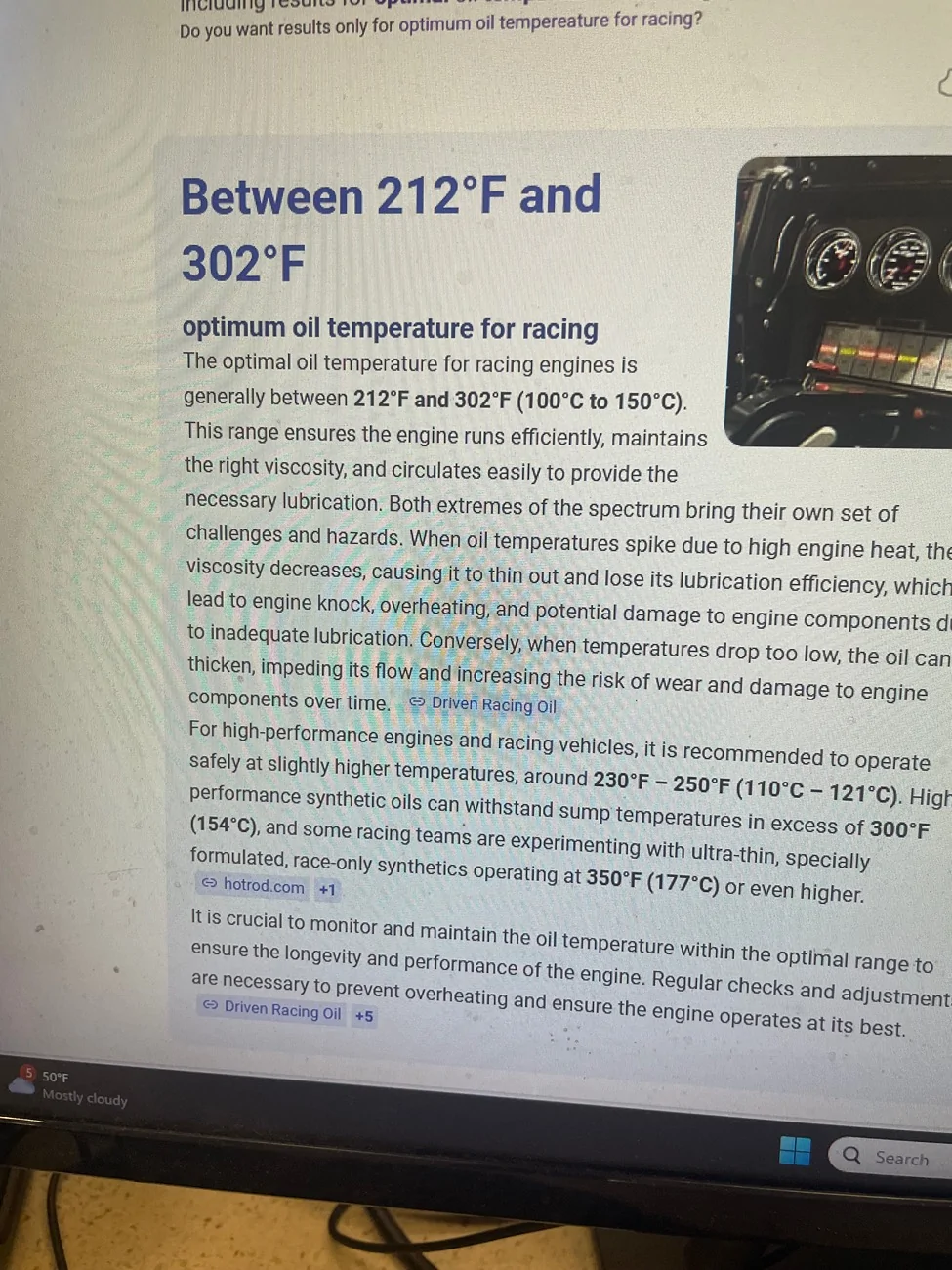

Please provide any contrarian datapoints.
Pan Temp or Bearing/Ring/Etc temp?
Easy, pan
Engine only last 6k miles at 255*
and 12k miles at 235 *
100% bs
