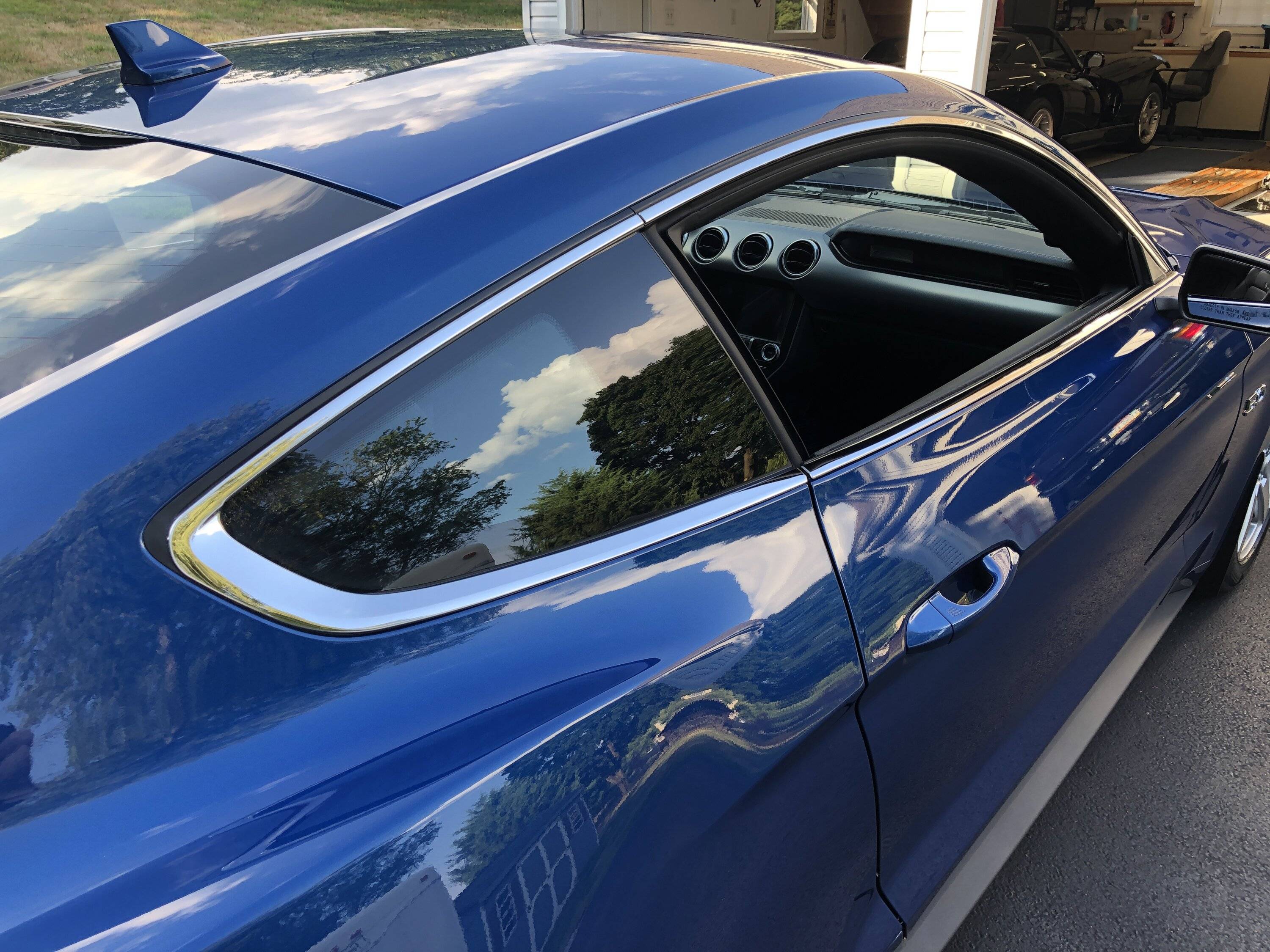

I accepted “help of sticky”and smeared a very thin layer of it on before sticking it.
Before all that though, I held the pieces up and stuck them in place with painters tape to get a feel for the gap between sections. That’s the only trick to it. Temporarily hold the pieces in place. You’ll see what I mean.
Thanks...I guess a good cleaning with alcohol first.
Did you put "help of sticky" on the car or on the tape?
I've always placed the parts and then pulled the backing tape off as I went.

Thanks for the advice. Mine are on. I used the "help for sticky" on the rear pieces and one of the over the window pieces before I ran out. I used 3M stuff on the rest.
On the corner pieces, I found they were slightly touching the paint at the very end by the doors, so I put a small bit of PPF underneath. One bit of advice to those doing these. I found it helpful to use the 3M Adhesion Promoter on the door pieces. This way, I could work it into place with and pull the backing tape as I went.

If installed correctly, it doesn't touch the paint. I love mine and it was easy to install.

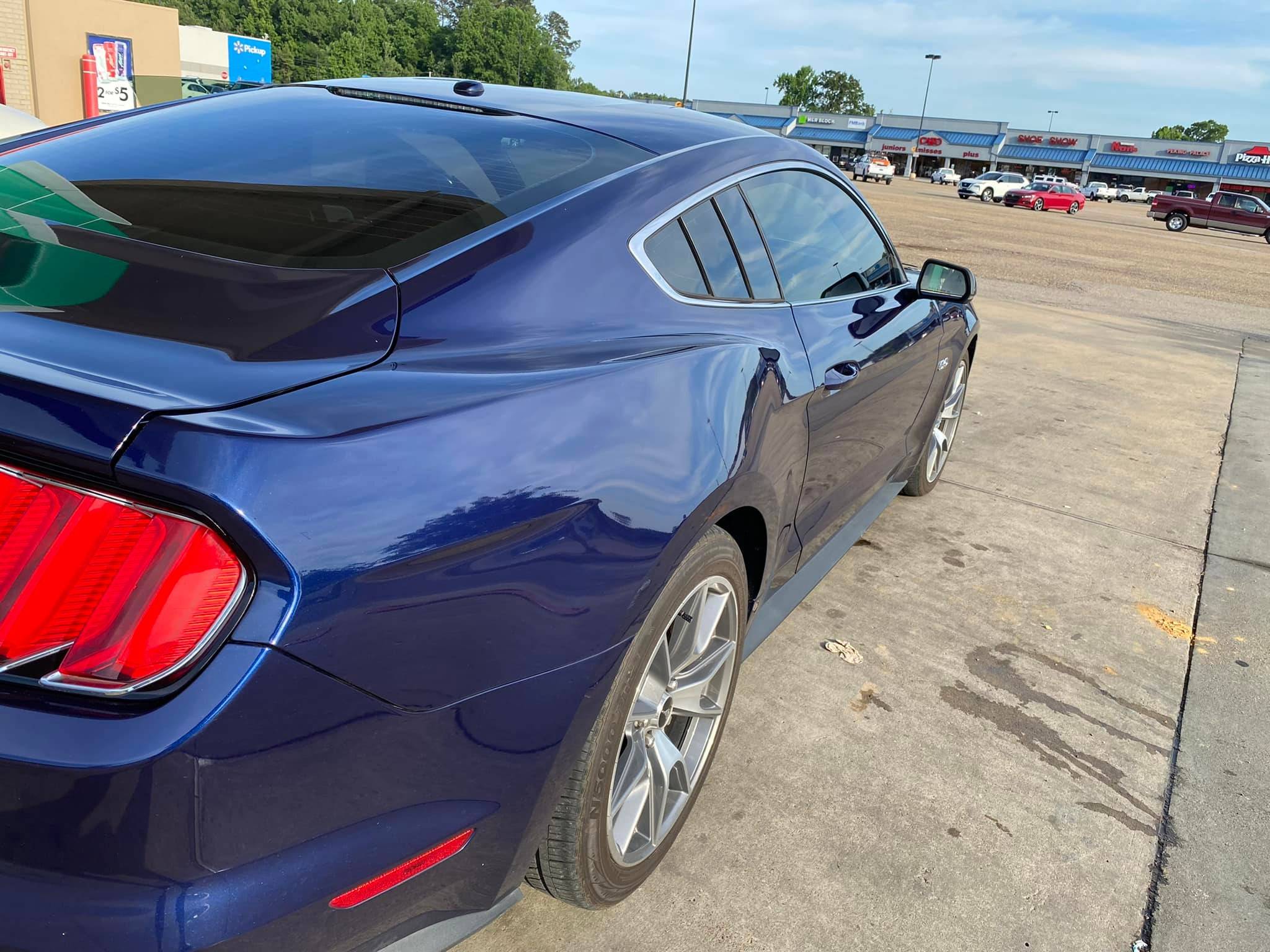

would have been nice if ford had a "retro package" option for the cars and you could have gotten it from the factory as a package with other chrome bits. honestly that was one of the things that drew me to the 50th LE, so many great little cues from the original 60's era mustangs and the 'murdered out' look has been done to death - when the factories start doing it it's time to let it go, time for the pendulum to swing back the other way a bit. start making these gorgeous cars look elegant vs angry
