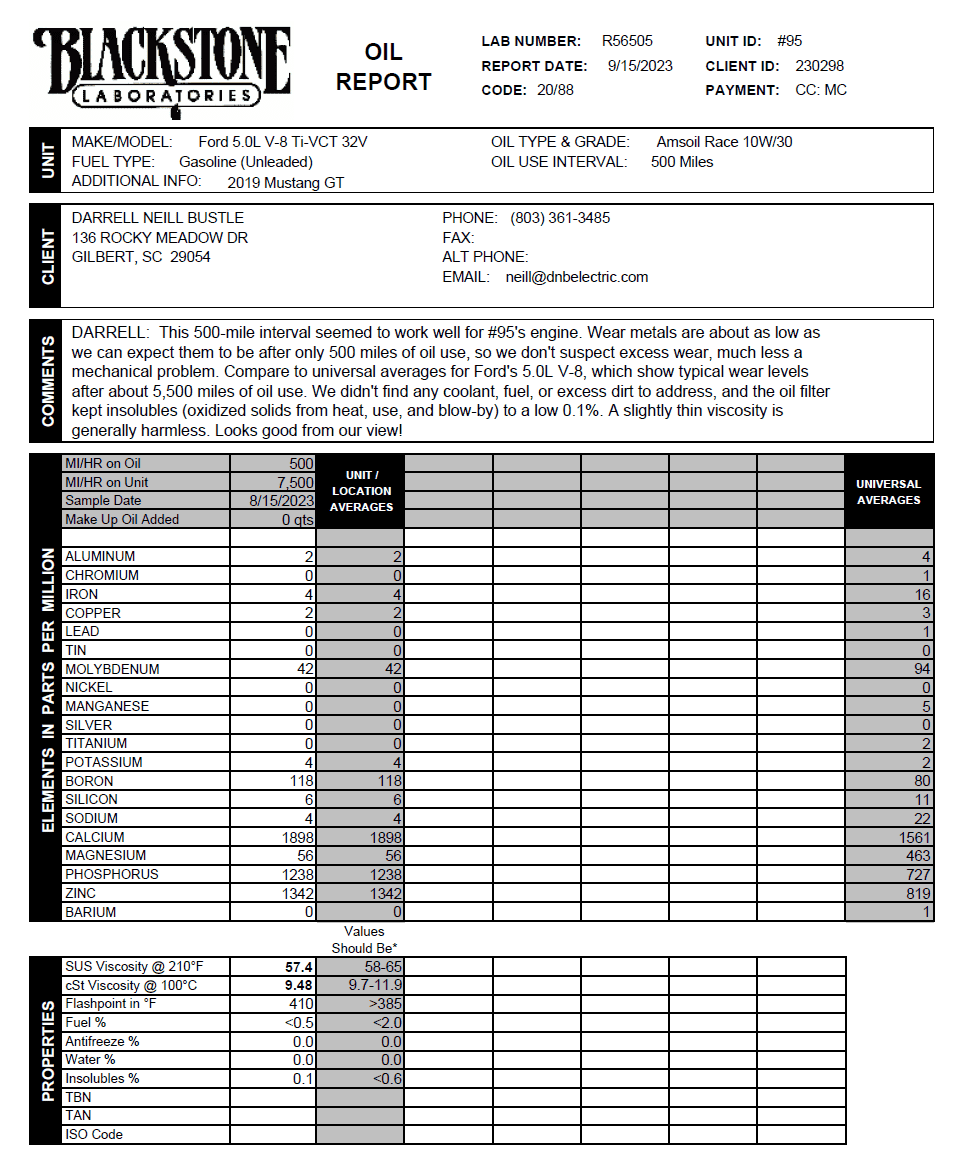

I use Motul 660 in the brakes change it out about every 6 months with a little of it blead off and replaced at each track event prep.
As for engine oil I use 10w30 Amsoil race oil and only swap it when the computer tells me to. That monitor does not go by miles it uses some kind of algorithm and it ends up being about 500 track miles. I have had a lab test the oil after letting it go to the oil light comes on and they say I am good to go.
As for the MT82 and the rear end they have Amsoil in them that went in last summer during our month off from NASA events so I plan to replace it at one year and have it tested to see if that interval is ok.
There are all kinds of change intervals suggested out there but I like real data to support the idea, so that why I went with the longer duration and test plan.
I run the same oil and have never had issues, it seems to take the abuse and still maintains its integrity.
