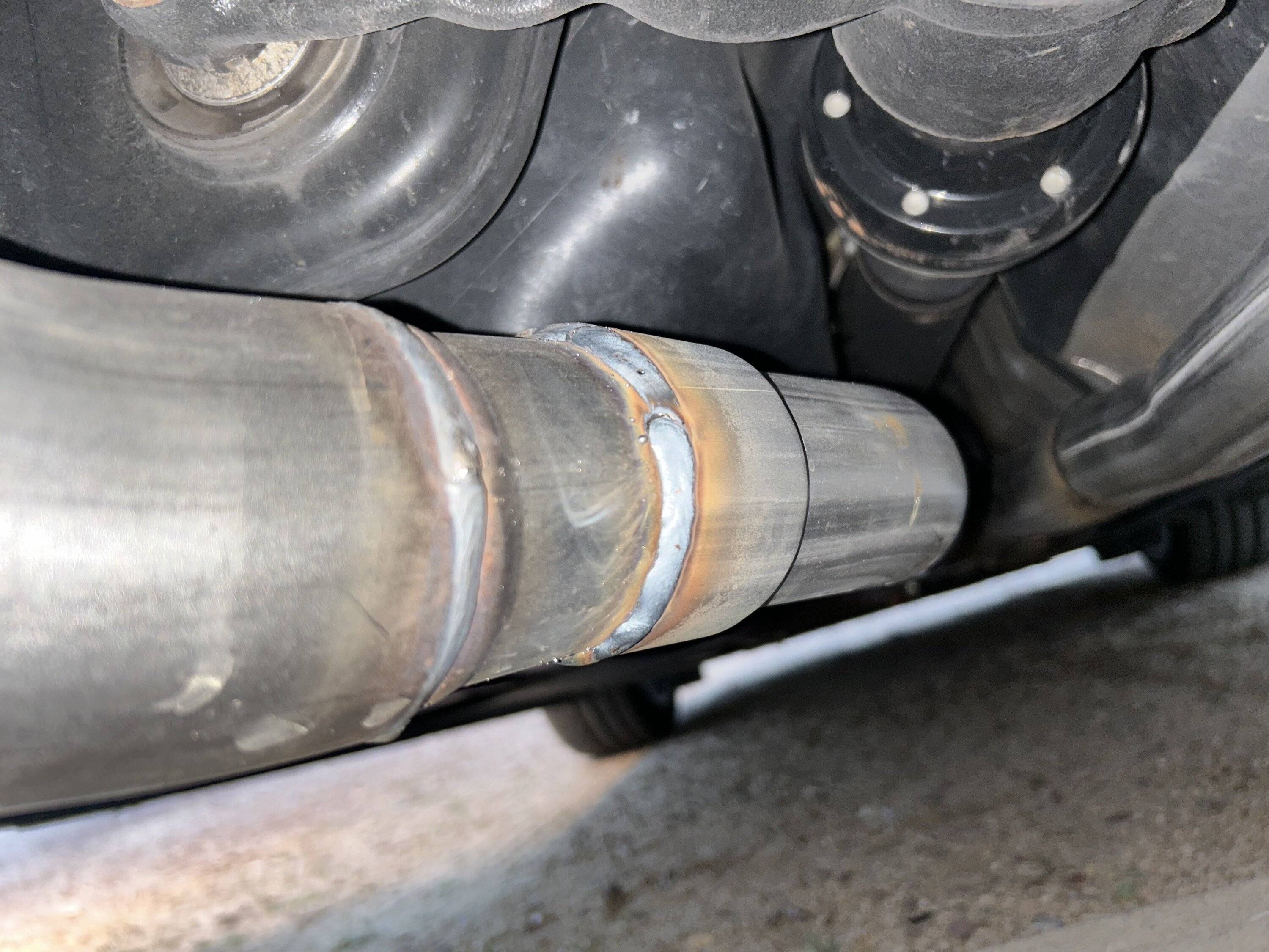

Now what I had the exhaust shop do was a bit different. I had them put in a freshly cut pipe to make up the difference between the Outlaws and the X pipe and we didn’t use the old exhaust piping. The pipe slipped over the outlaws and into the Xpipe. Instead of clamping that pipe on, I had them welded it on. I don’t know if that, had anything to do with the fact that it’s not droning as much as some folks say it does, and how the pipe was fitted on, but I’m very happy with the product. I still have stock manifolds and cats and I doubt that I’ll do a set of catless headers with this exhaust though.

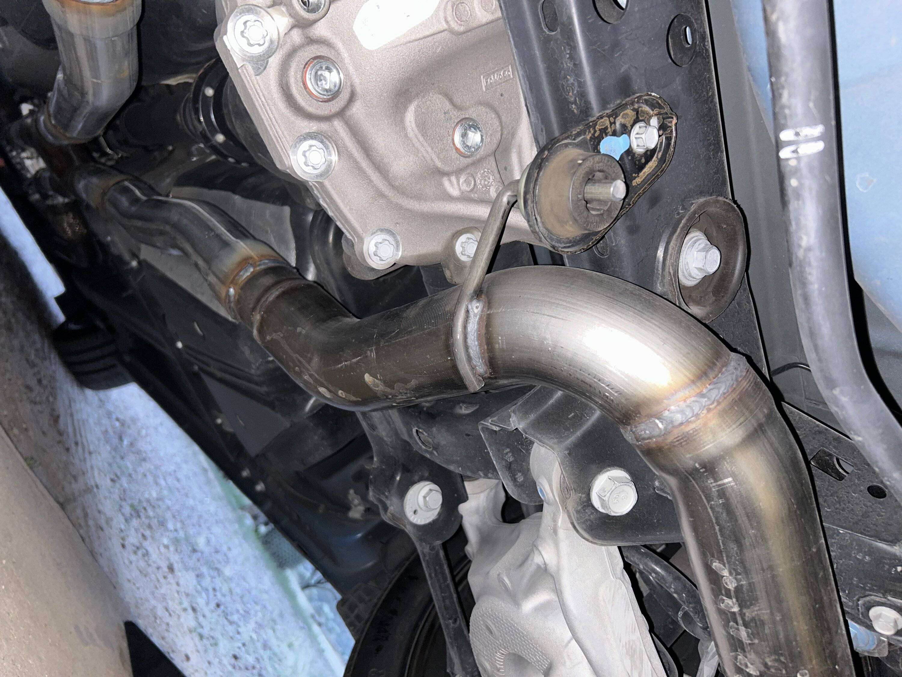

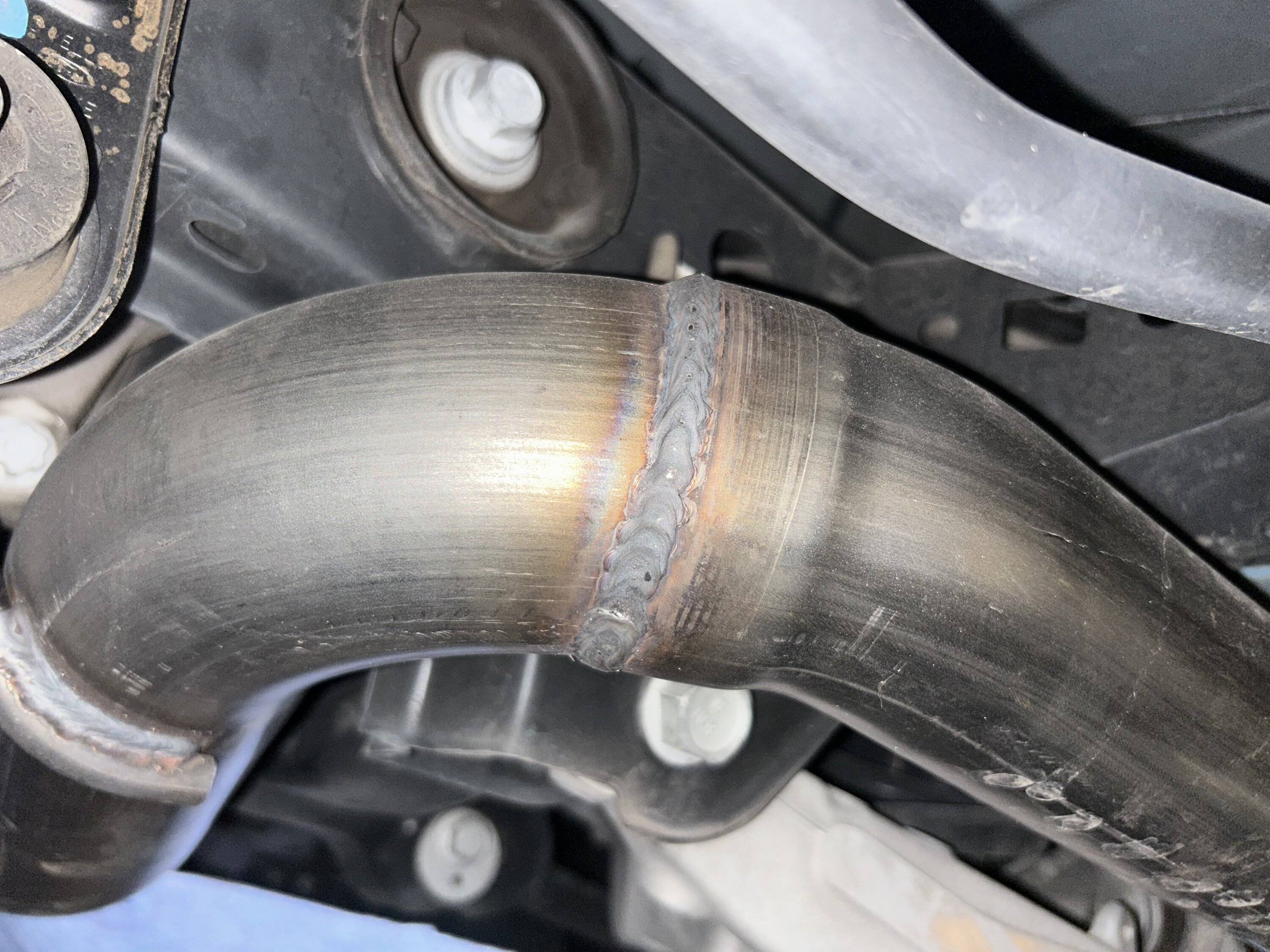

So here are the pics. As you can see is an over and in. Over the Outlaw and into the X Pipe. I am thinking that even with clamps you might get some rattling that will add to drone. This fix takes out any rattling caused by inserting the old exhaust pipe and just using clamps to hold it in place.
Pic 1 The over and insert pipe
Pic 2 Over the Outlaw
Pic 3 Into the X pipe

The welds look really good. Most muffler shops don’t run good beads like that and end up leaving leaks in the system. Did the installer tack weld everything in place and then remove the system and weld it?

He mounted it, braced it and welded it while on the vehicle. It’s a local small shop with a lot of talent. The owner was the one who did it. Anyone in Tucson who reads this it’s Bochos exhaust and Custom off 12th street. I’ll see if the wife is down to record tomorrow. I’ll do a cold start and a couple of fly bys and also an interior while on the highway. šŸ‘šŸ¼
