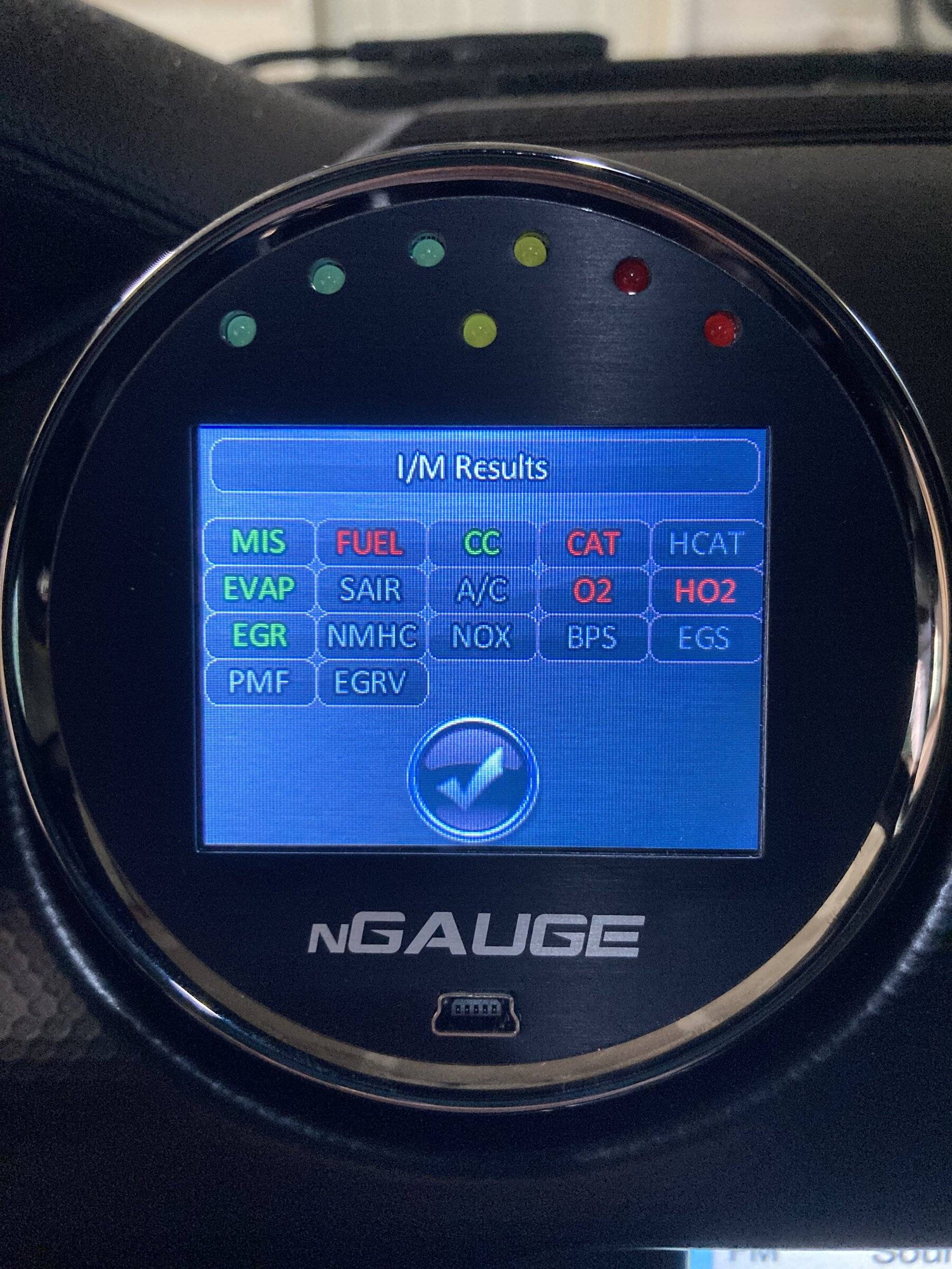

right now I’m running a ngauge. Idk if it checks ready codes or not

Ok I just tried and had o2 , o2 heater and catalyst not ready. So I guess I’m gonna flash back to stock and try again

I have Ngauge This is from few days ago
Fuel takes a little bit too and I believe requires more than 1/4 of a tank, but yeah you're going to have hell with the CAT and O2\HO2 without going to stock. Some people get lucky and some don't. I didn't see if you had long tubes or not.

Yea the fuel came on about 10 minutes in to the drive.
