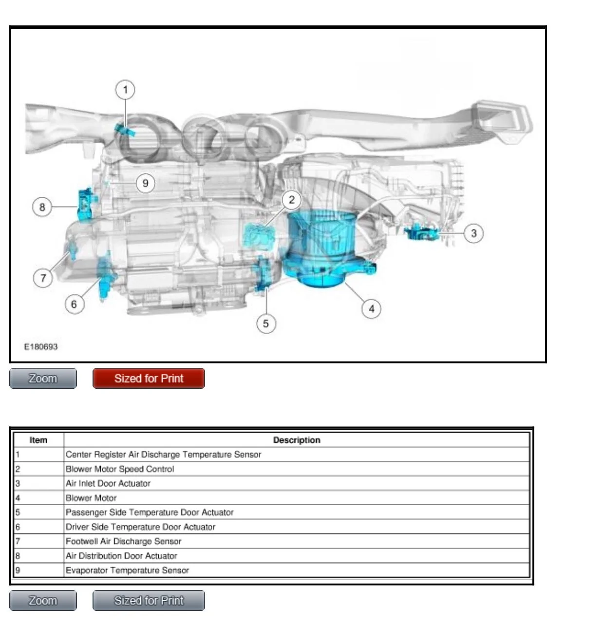

“IF” one side is “COLD” and the other is “HOT / WARM” it is NOT necessarily the evaporator.
I’m not there to measure each sides temperature.
Example:
If the driver side is 80° and and the passenger side is 75° sure it could be an evaporator or low charge, bad compressor etc. The evaporator is on the right side, so it’s natural for that side to be slightly cooler.
“IF” both side are “HOT / WARM” it can be a evaporator, module, low Freon, compressor, clutch, pressure switch, electrical etc.
Just because it’s blowing warm doesn’t mean it’s the evaporator or the same problem as it was before.
All I’m telling you is that if one side is “COLD” and the other is “HOT / WARM” it’s a blend door actuator.
Each side (driver and passenger) have its own blend door actuator for temp control.
Jeff.
I didn’t say I was right.
I’m simply explaining that the evaporator is not in control of each side individually. The blend door is what controls each side individually.
I also clearly stated that if one side is hot the other cold it’s an actuator or other issues not the evaporator.
If both sides are hot / warm within a few degrees of each other then yes “possibly a evaporator or Low Freon charge etc.
Blend door actuators are a very common problem.

If you’re getting cold air on one side and warm on the other it’s is NOT the evaporator. It’s a blend Door actuator.
To replace an actuator the dash does not need to be removed. Whoever told you that if one side is colder than the other that the evaporator is bad is a dumbass.
You did actually say that, definitively...and in caps.
The symptom of different temperatures per zone has been the leading symptom when the evaporator has failed. I haven’t seen anyone report any blend door/mixer as part of the fix. I have the repair order on mine and it was not on there. Scott - based on your diagram, I feel even stronger that only part of the evaporator is getting chilled...and to what degree likely depends on the amount of charge in the system.
For this car - different temperatures from the zones has commonly been an indication of a loss of refrigerant in the system...and that has commonly been the evaporator.

Hey bud. Just thought I’d provide the diagnosis from Ford (took my baby in today). Evaporator Core....like I said. Have a nice night.
