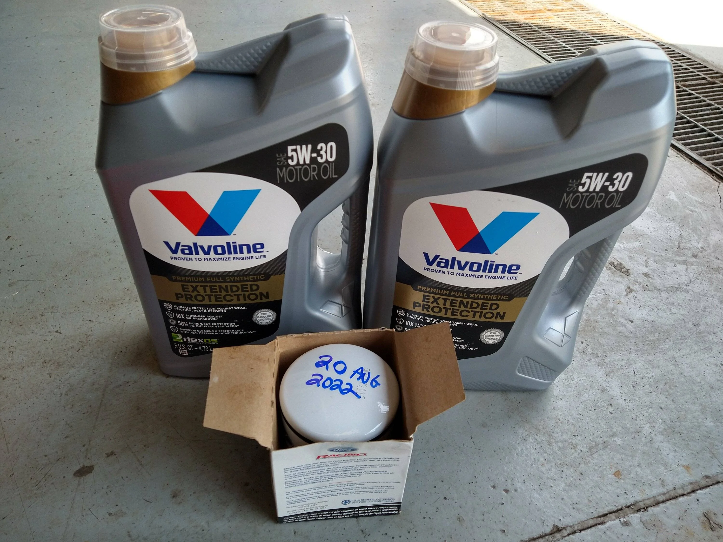

Just did my 4th Oil Change on the Bullitt. I've been using the Ford Performance (802) Filter, and various oils all 5W30.
OC 1 - 2000 miles Jan 21 w/ Ford Spec Semi Synthetic (50% oil life)
OC 2 - 7000 miles July 21 w/ Ford Spec Semi Synthetic (40% oil life)
OC 3 - 11000 miles Nov 21 w/ Pennzoil Platinum Synthetic (40% oil life)
OC 4 - 17125 miles Aug 22 w/ Valvoline EXT PERF Full Synthetic (20% oil life)
By FAR, the Valvoline is the best oil for my motor. The motor was immediately smoother, virtually ZERO 3K clatter from the VVT, and NO BBQ tic. I will say that I did NOT like the look of the *Pennzoil as it came out. Seemed watery, and had an odd sheen and look to it. I was never happy with how the motor sounded with it.

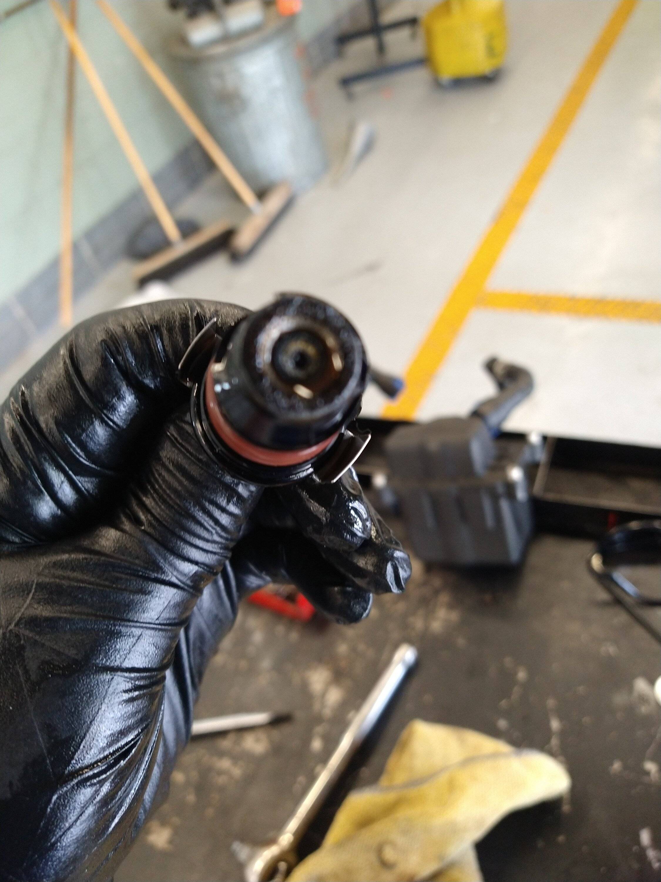

As for how much blow by in the FORD Performance Catch can, there was maybe 4 tablespoons, and I realized I forgot to check it at the 11K change, so that was how much it caught from 7K to 17K.
The Magnetic/Billet drain plug had VERY LITTLE metallic paste.
OK, time for a Sunday Romp!
Minimal blow by, between 7K & 17K Healthy motor!

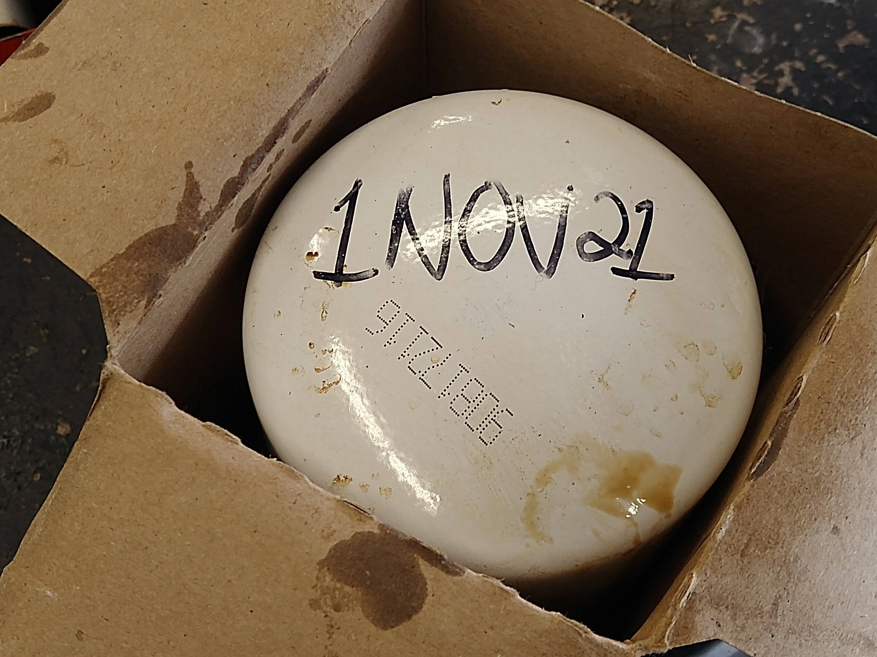

I always date the oil filter and take a pic, need to start putting mileage too, but I always remember after installing..... lol

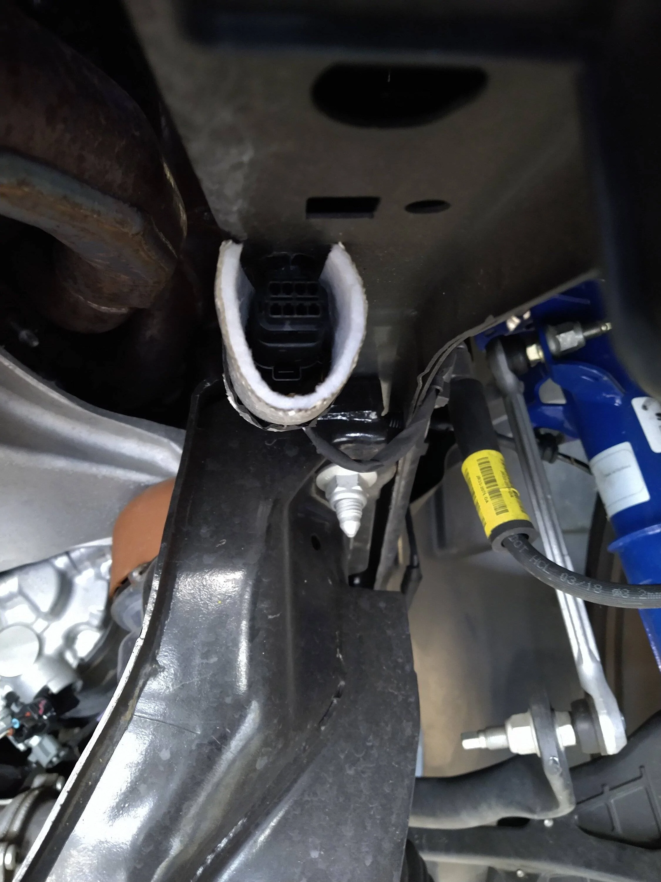

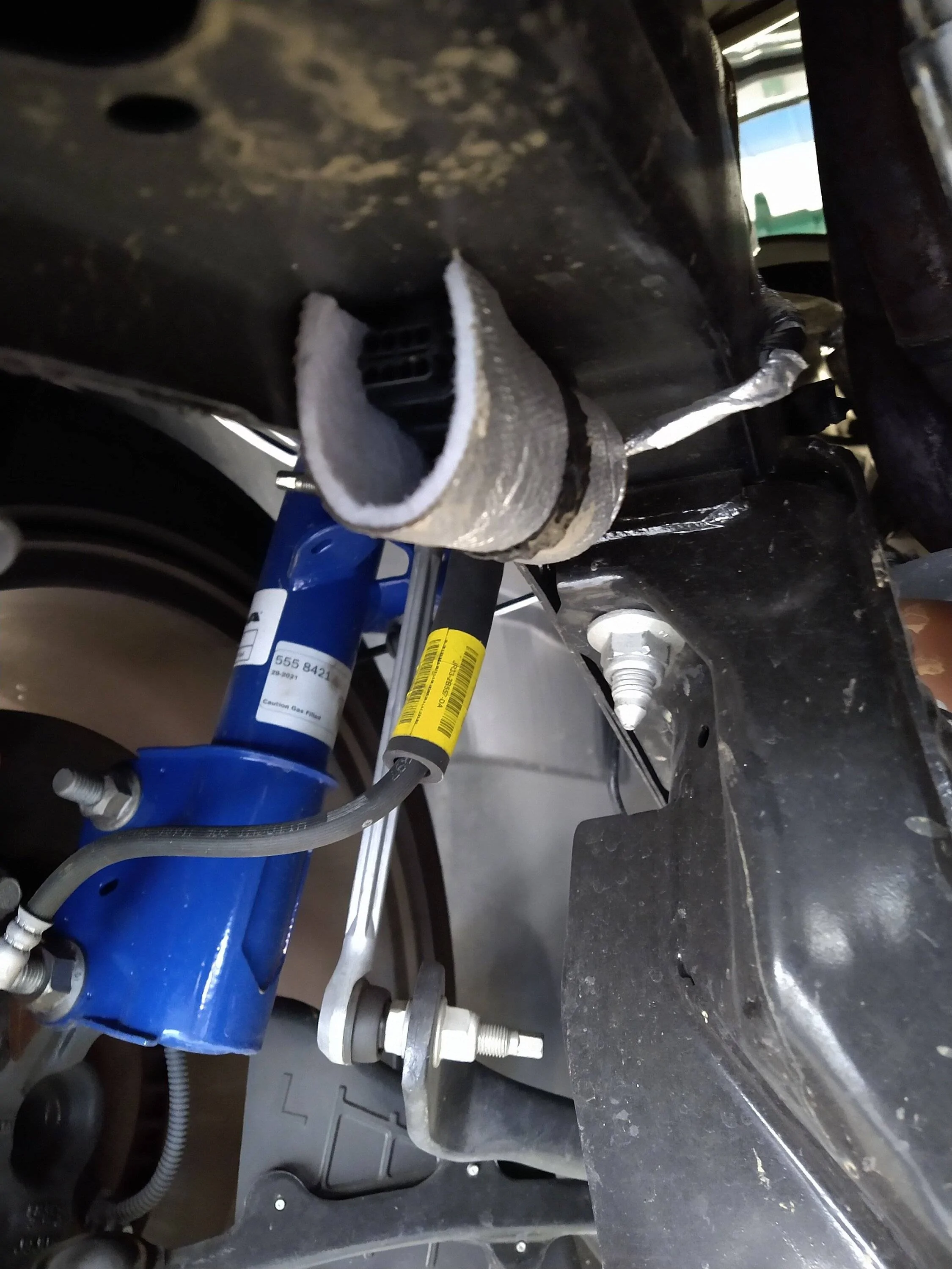

I noticed these terminated plugs up by the front frame, near the downpipes. One on both sides, anyone know what these are for?

Thats really weird. Let me check some of my pics, could be a magneride level sensor hookup.

Yeah man, Im 95 percent sure thats the connection for magneride level sensors.
I combed through my build thread, and despite all my work in those areas, I dont have a full pic of the sender itself, lmfao!!!
This tells the story some.

That makes sense. easier to have one wiring harness on the car. I wish that the MR was independently adjustable and selectable from the drive modes like the steering and exhaust. If it was, I would have bought a car with the MR.

Well it is for your My setting. But besides one mode, yeah kinda lame. My custom mode is track steering, track dampening, and sport exhaust. Cause my full 3" catless, twin x pipe, 1 7/8" ARH, Borla Atak is deafening, lmfao!

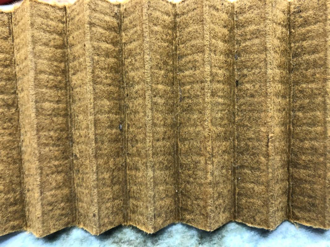

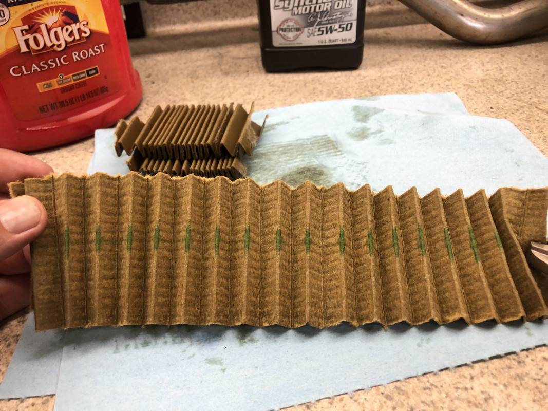

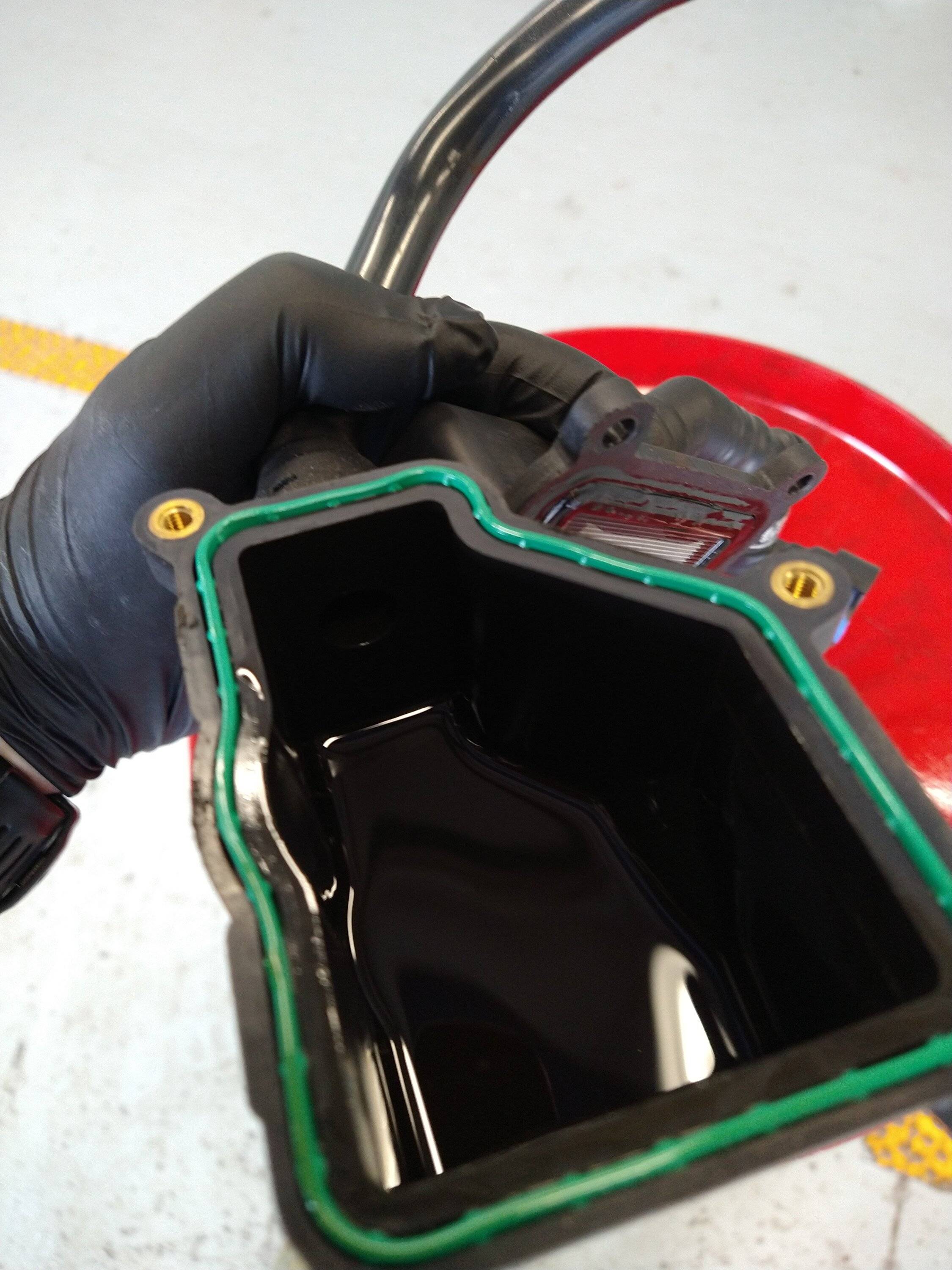

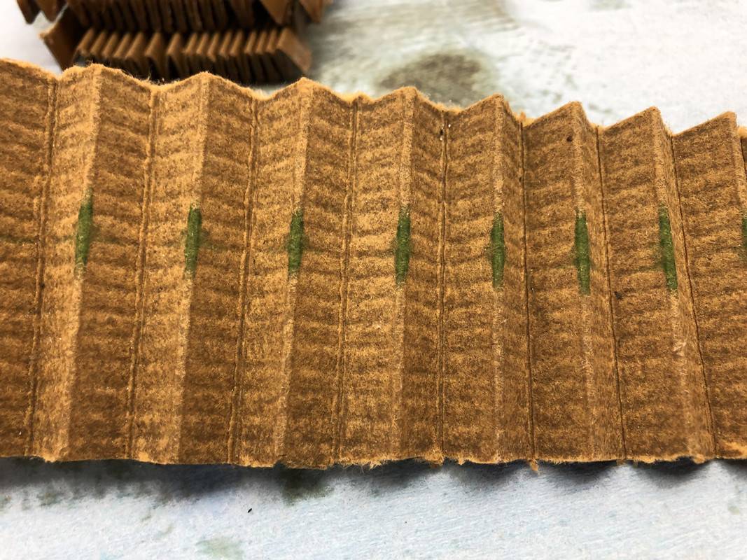

Good info and data being you have used a few different oils during the short life of your car.
That said, what you have is certainly subjective (car runs "smoother" -- no way to measure that).

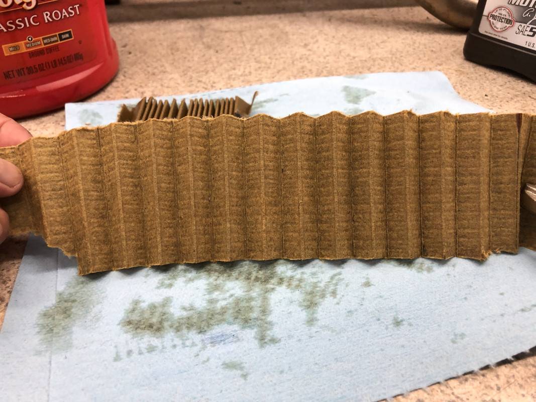

I would suggest you buy a oil filter opener and inspect for metal on every oil change. That way you will have a better way to measure what is going on.
Obviously sending a sample off for analysis is the best choice, but im too impatient for that.
