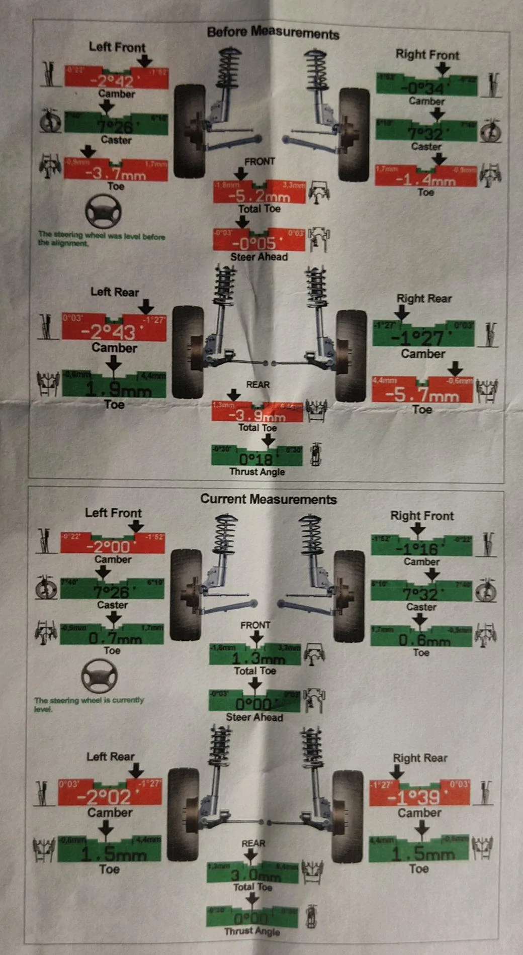

I never did post my tracking results - I've given up trying to thumbnail this, the forum software keeps removing the link.

My car passed has just passed the MOT but had an advisory on the left hand front upper control arm, so the Dealer ordered me a new one under warranty, the question is, will the dealer just replace the part, or will it need a geometry check as well. The car is lowered and has wheel spacers, and I've had it set up properly by a specialist as the tyres were wearing badly, to the tune of ÂŁ165, so I'm a little worried that the geometry might get set incorrectly i.e. set back to standard, if the dealer has to do it ?
