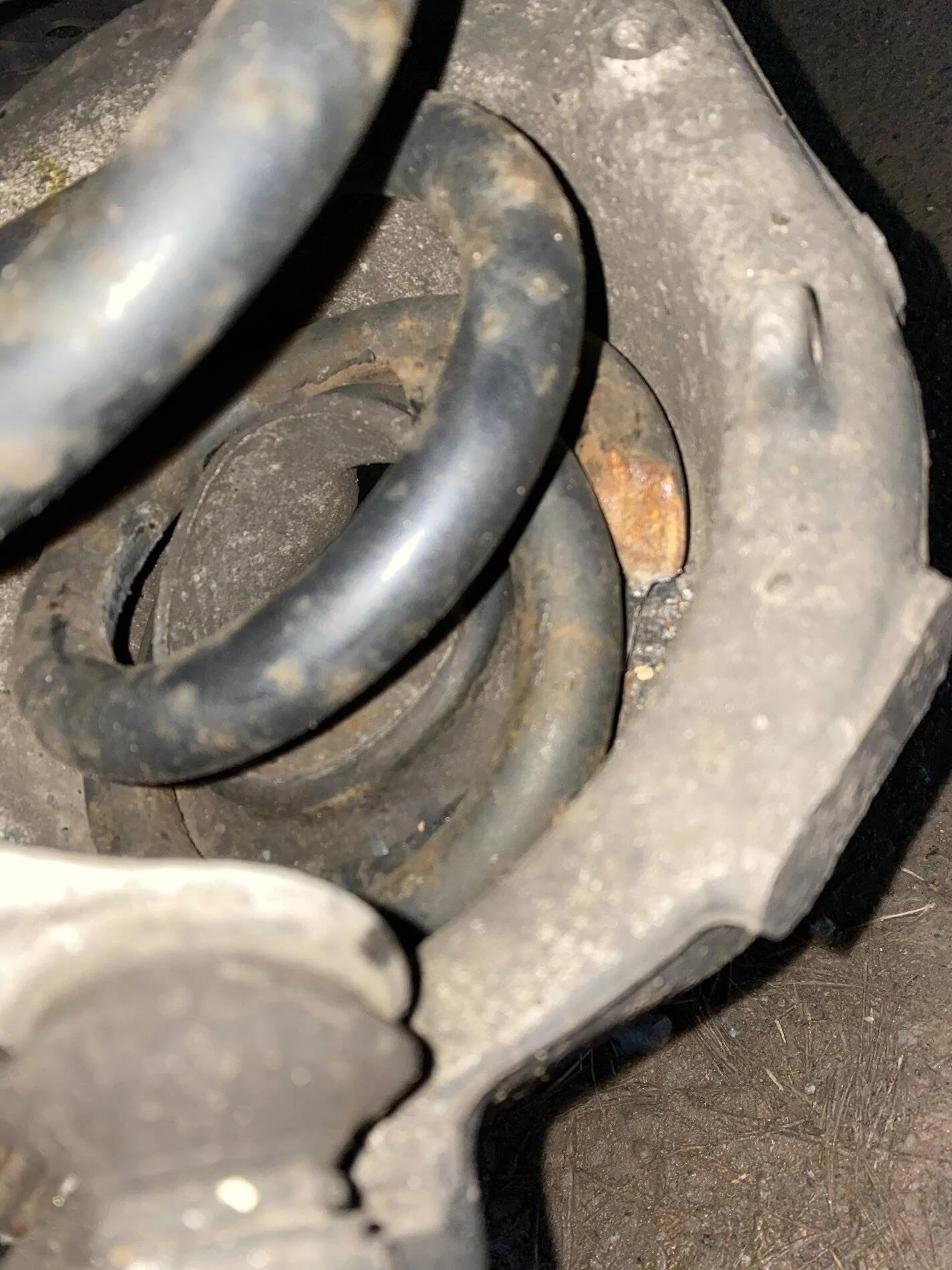

gets better
i just jacked it up to snap a pic to send to eibach to see if i could see it or not
here is was the ford service department and 3 garages managed to miss when i told them there was a clunking when i went over pot holes.

Shocking. For what it's worth, a strongly worded email for Ford HQ might be worth your time. They have been known to offer £150 in vouchers for less terrible offences.
Doesn't have to be used for their services either, I spent mine on parts (upper grille and hood struts). Or you could get a new set of springs for that!

Incidentally that broken spring would not be visible from underneath on a ramp I suspect - not an excuse but maybe a reason ?
