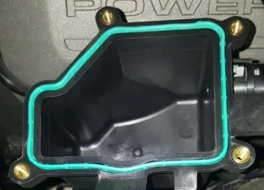

So giving some thought to this after 3,254 spirited daily driving miles, I would check the results of both ford performance catch cans.
Driver side catch can, no sign of oil vaper residue.
Passenger side catch can, approximately 41.5 ml = 1.40 oz

anymore updates on how much oil is being collected in the driver side catch can

Driver side is pointless unless you're boosted. You might have a little in the driver side if you constantly are at high RPM and track regularly, but doubtful. Passenger side is where you'll see the collection.
