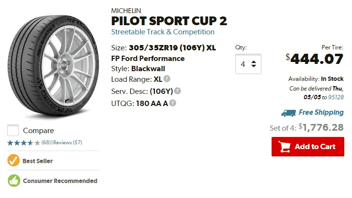

Ordered a square wheel setup (19x11 ET52 Apex wheels w/ 25mm spacer up front).
I think I also plan on running the Ford Performance lowering springs (which I understand lower very little).
I know that no one has mentioned rub with 305/30/19, but I noticed that the tire size 305/35/19 originally designated for Ford Performance is significantly cheaper right now on Tire Rack (like $75 bucks per wheel!).
Anyone have any idea whether I might expect rub up front with the 305/35?

I seriously doubt it. Check the section width and tread width specs. I think you’ll have enough clearance.
The lowering springs are great, and I’d also recommend getting the FP sway bars done at the same time. Those two together will greatly reduce body roll in turns.
You’ll have zero issues with rub if you go with a 305/35 square setup. Keep in mind though, the compound and composition of the cup 2’s is a little different between the 305 and 295’s. Likely not drastic, but there’s a reason the 295’s have always cost more than the 305’s.

The Michelin Pilot Sport Cup 2 FP tires you shared in 305/35/19 last a bit longer and are a bit less grippy than the standard Michelin Pilot Sport Cup 2 tires in 305/30/19 and 315/30/19 that came on the GT350R. I've been using those FP tires on my car the last 6 track days. They have been great but they're now spent.
