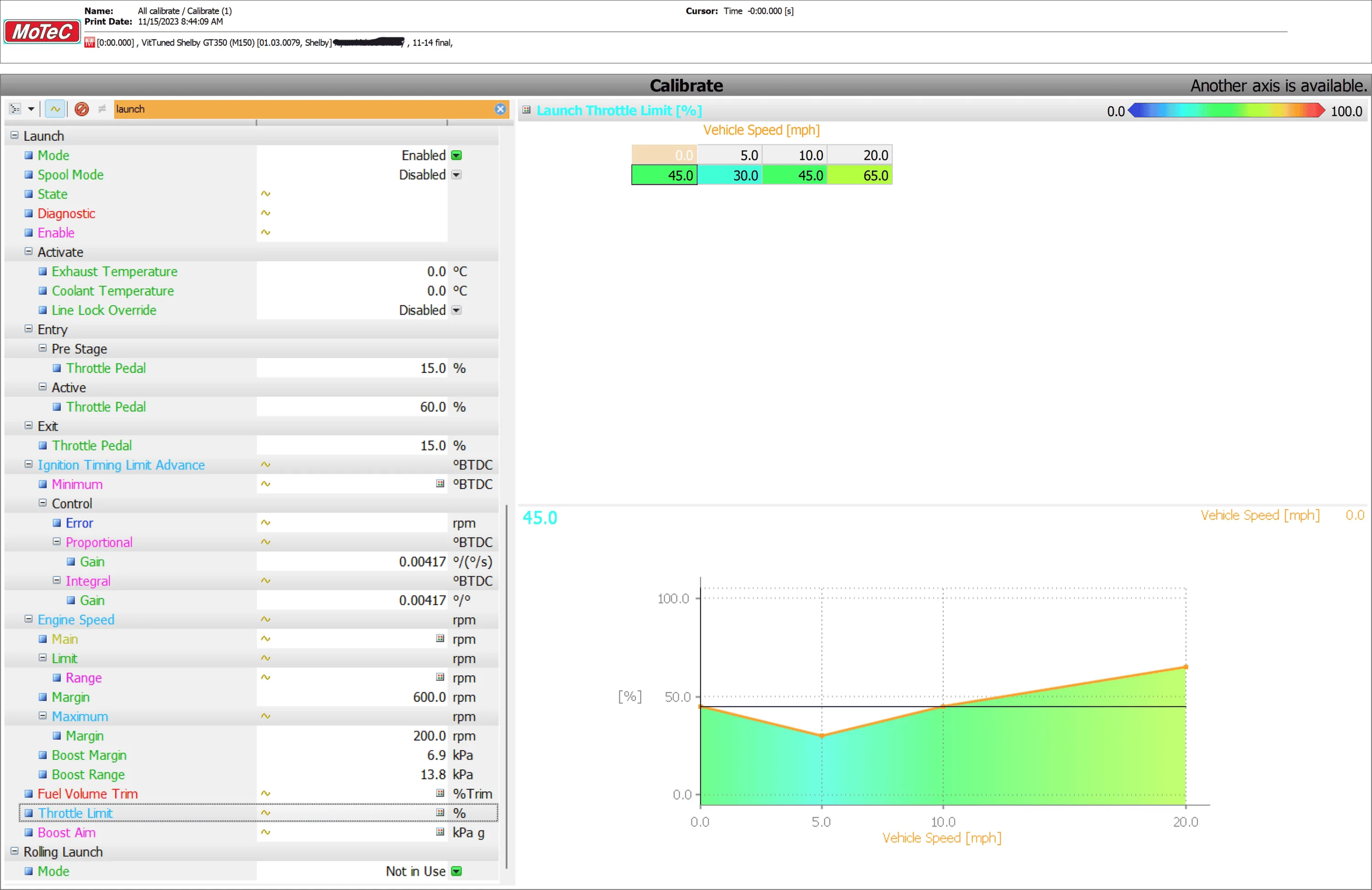

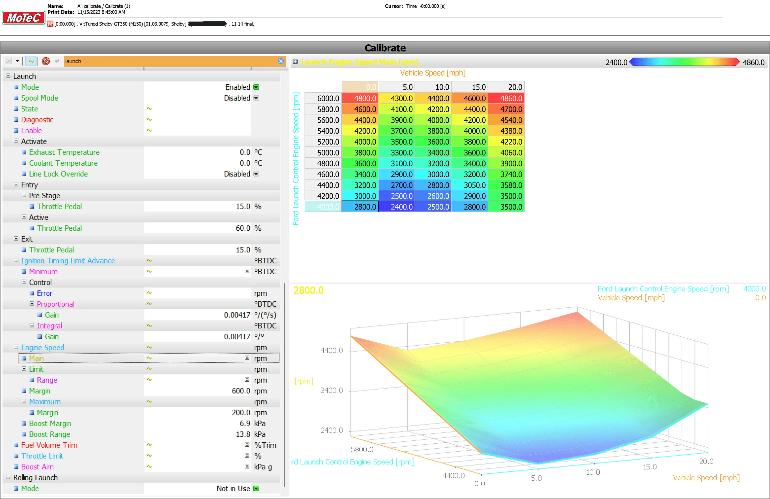

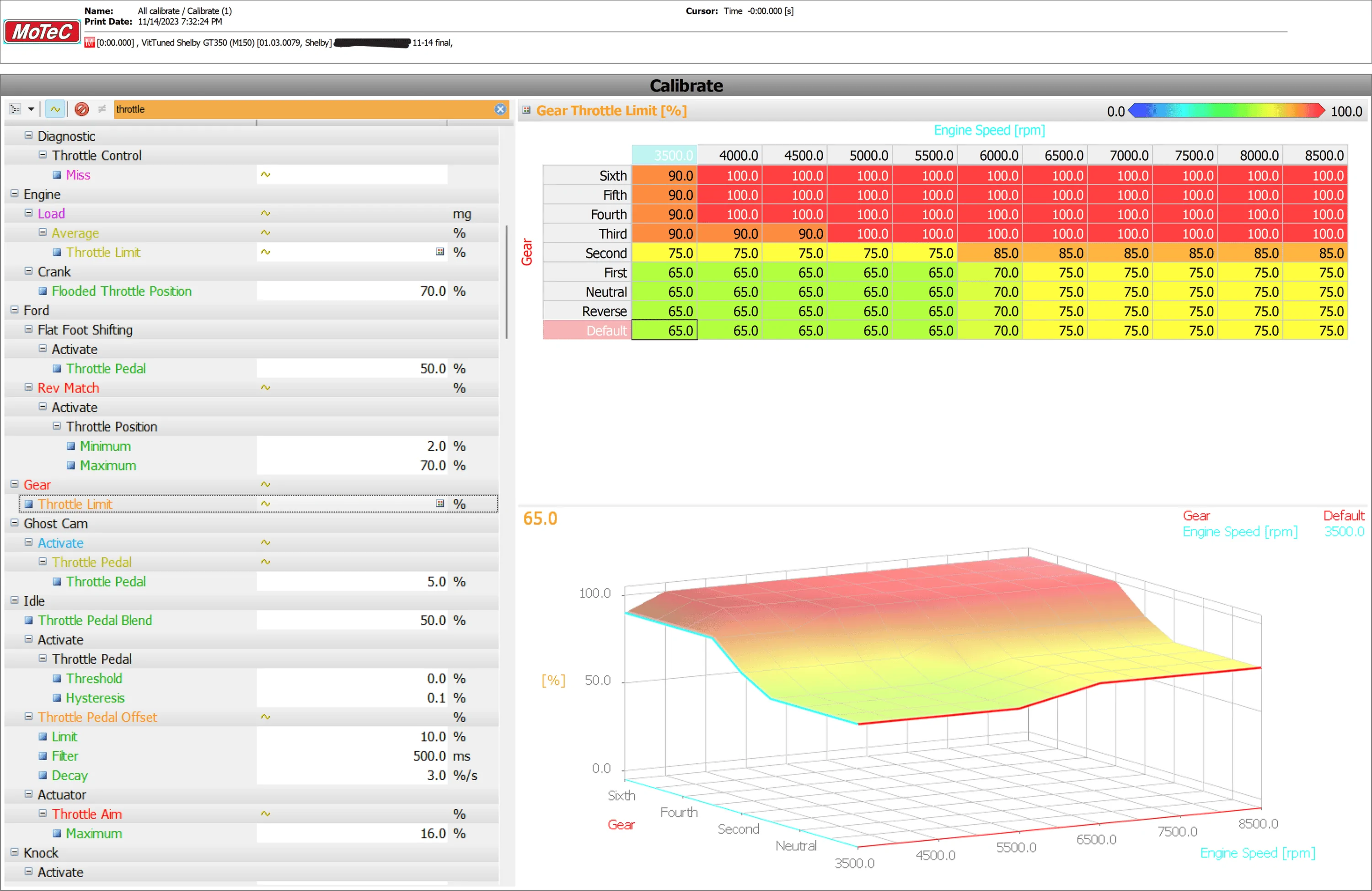

MOTEC employs what many stand alone's term a "3 Step" where you can set the first two stages as everyone is familiar. Using the FORD architecture, you activate the launch control that holds the motor at the desired/set rpm and after a post launch metric is triggered, it transitions back to the "normal" tuning functions.
A 3rd step is employed where you can limit both RPM by speed and throttle angle (which in turn limits torque production). As you can see from the base/initial settings, you can tune in an initial hit, a dip and then a controlled ramp out of the dig, (rather than just an initial hit and then spin city immediately following). It's a nifty aid for the driver rather than having to feather the accelerator and/or the clutch (for 3 Peddle Club), the driver can focus attention on other elements of the run.

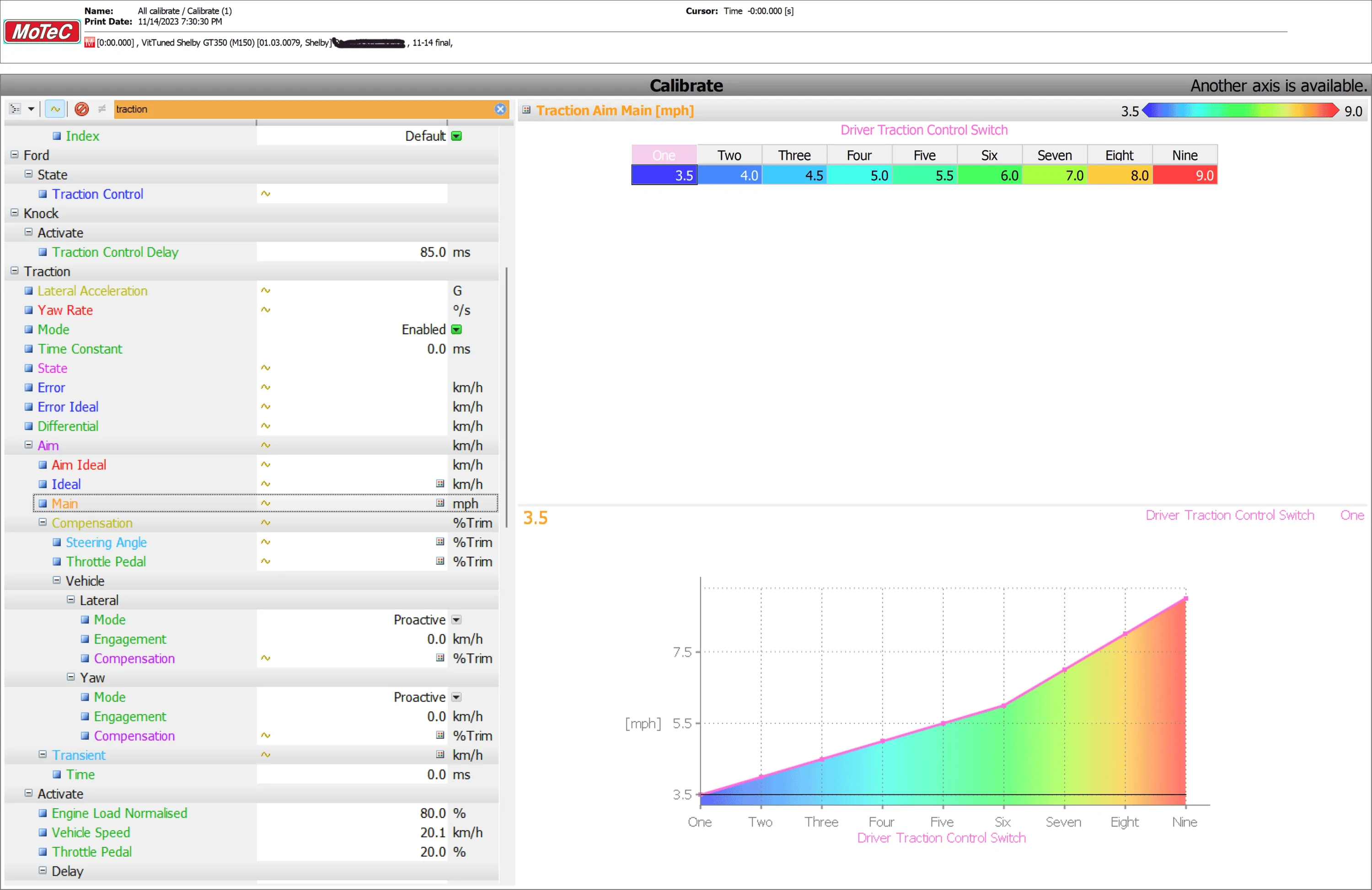

The traction control strategies are simply light years ahead of what Ford employed. In fairness to Ford, can't be sure how much attorneys were involved from a risk perspective, but Ford simply created a bandaid traction control, which isn't just dangerous, it's so bad that most people attempt to turn it off (which isn't even simple, the only way you can TOTALLY remove all elements of the Ford system is to disconnect the dyno plug and deal with a MIL). With motec, my traction control toggle TOTALLY removes any/all traction (no holding it down and even then having remnants of advance track hanging around). Then by mode it can adjust the wheel slip by first using timing, then if that's not enough it can adjust the throttle, then if that's not enough it can cut engine ignition (which is largely what Ford does). Not only is the MOTEC strategy more sophisticated, it's PROACTIVE (meaning the settings and tables are already setup to keep you in the middle of the fairway to begin). Ford is reactive, it waits for you to get into trouble and then by the time you're way over torqued and spinning it totally shuts down the party. Making it behave unexpectedly, which is why most guys just turn it off. The MOTEC setup is BEAUTIFUL. And I can make changes ON THE FLY. No retune or long reflashes. I can literally adjust the traction control settings in a few seconds if the conditions aren't optimal or are better than tabled. I can switch from one traction slip aim to another seamlessly.
