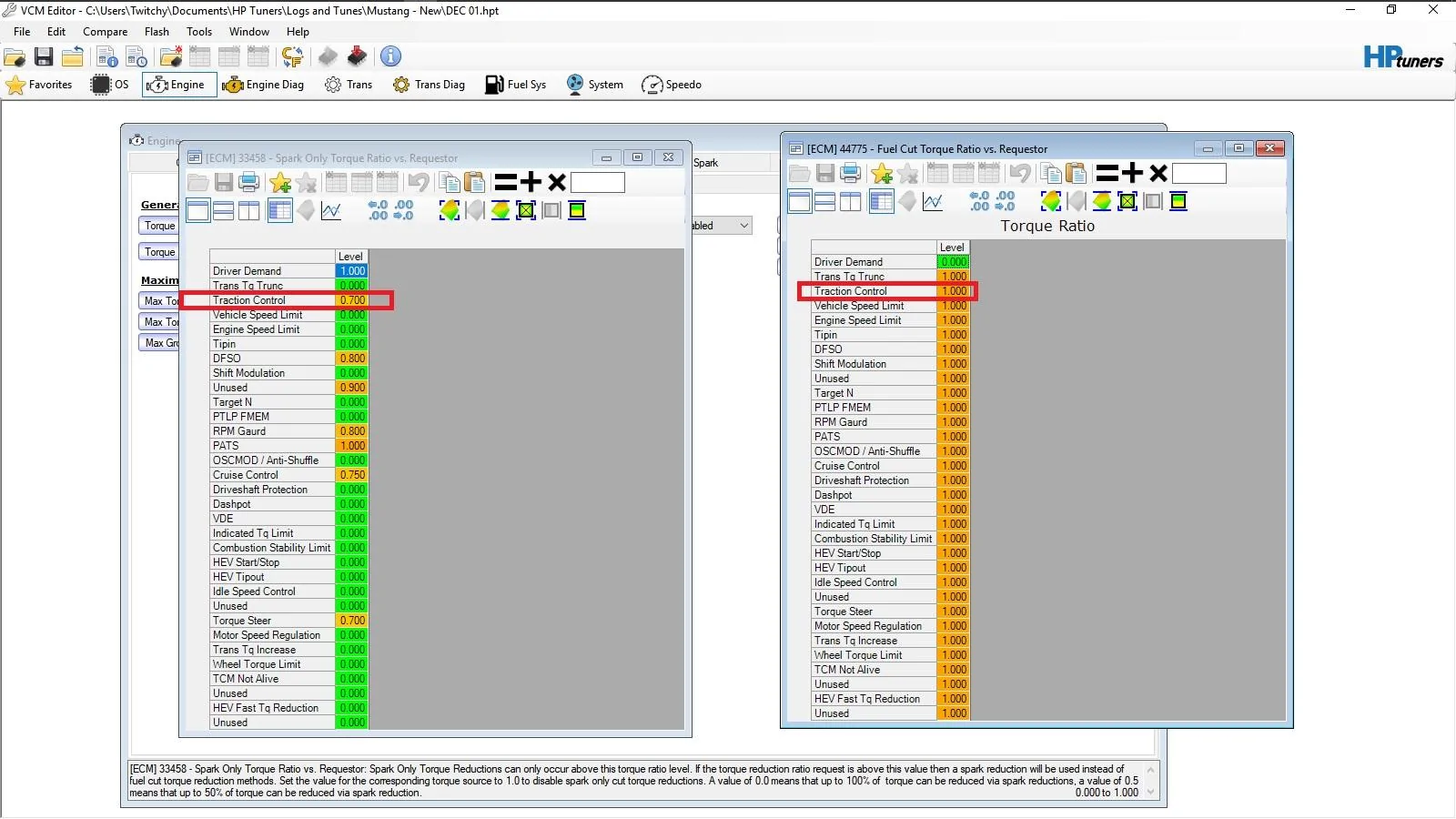

Yes, our cars have the ability to change how much Fuel or Spark is "cut" when a traction control event happens and it can be modified. I'm not 100% sure of it being the proper way to do it. I wonder if you could pull that fuse (#62?) to see if you are still experiencing the same issue.
You can bring it up. They will want a datalog of you trying to recreate what you feel when you say that it "pulls power". They might point you in a completely different direction, based on the logs. Trust your tuner.

XPiggy customs here in Australia have made a switch that allows you to put the car into what we might call “dyno mode”.
It basically intercepts the wiring that runs to the plug near the airbox and allow you to connect/disconnect the plug at will.
THIS will get rid of ALL the nannies as far as I’m aware.
The downside is that it renders ABS inactive whilst in use.
isedawishy
GTPPTT6REIGHTY
Jul 21, 2015
66
803
184
Fort Worth
2015 GT
Even with traction/stability disabled I was seeing it kick on during shifts while data logging. I ended up wiring up a switch/relay to terminate the wire in the engine bay, just like what Burkey mentioned.
I don't have the issue any longer. For a short term solution you can unplug the connector, but I wanted something I could control from inside the car.
