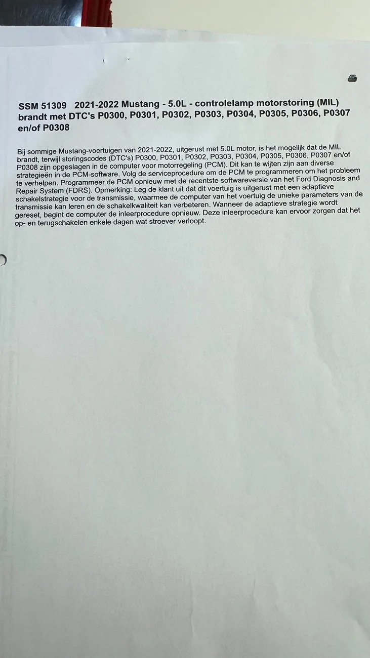

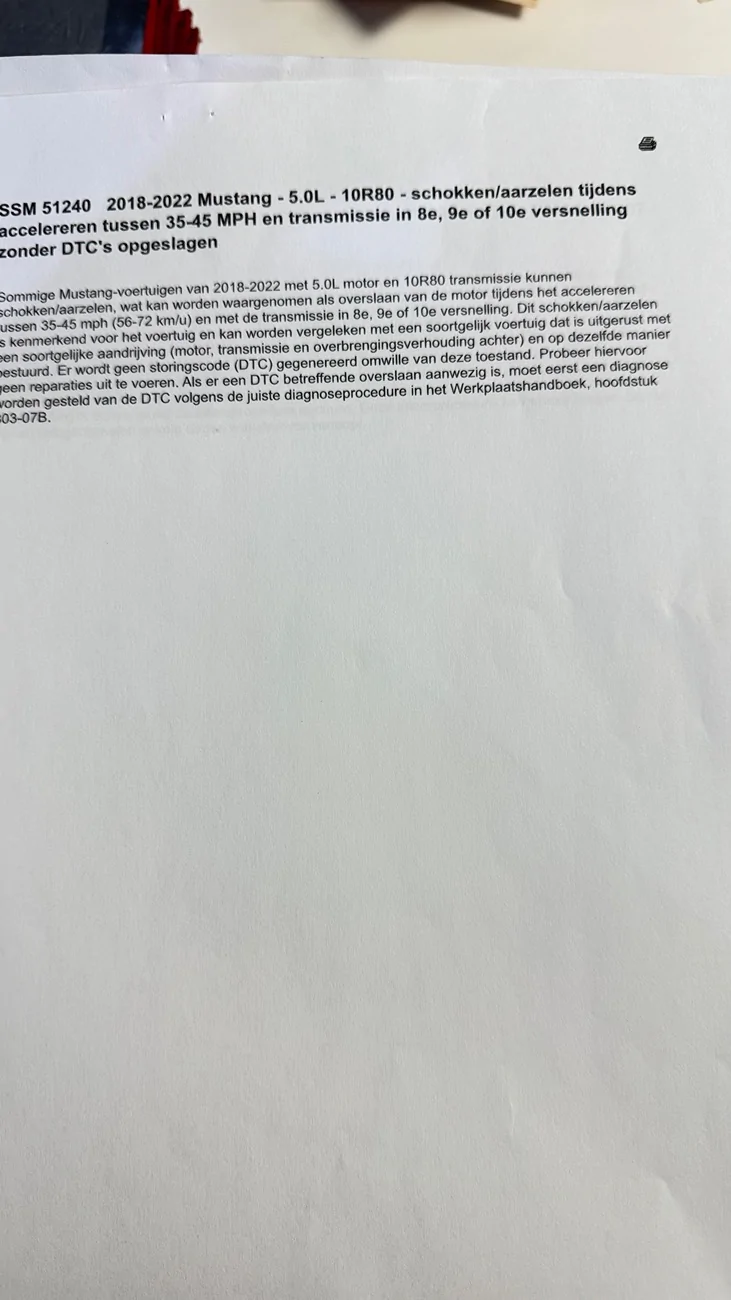

Believe it or not, i have had more or less the same issue, hesitation hill up during low rpm (load), serveral misfires, no codes.
Ford gave me this report in Dutch, basically saying “accept it, live with it”. A respectable tuner fixed the issue afterwards, had apparently to do something with environmental limitations. US version GT 2021, 10 speed, premium fuel.
