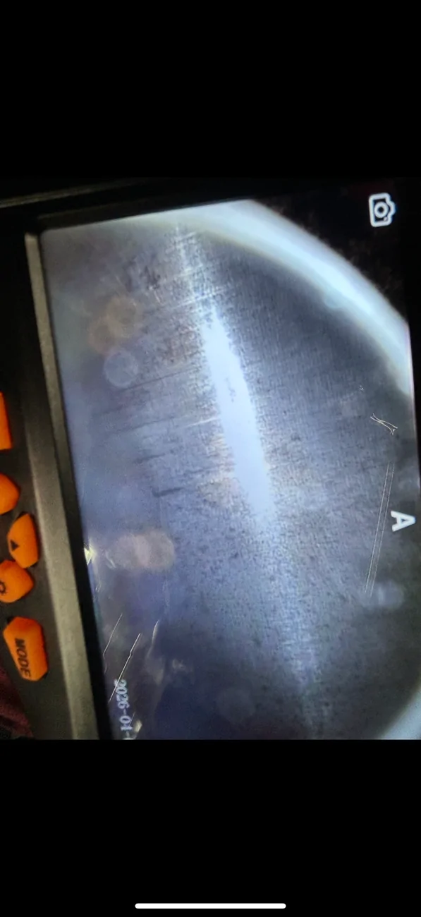

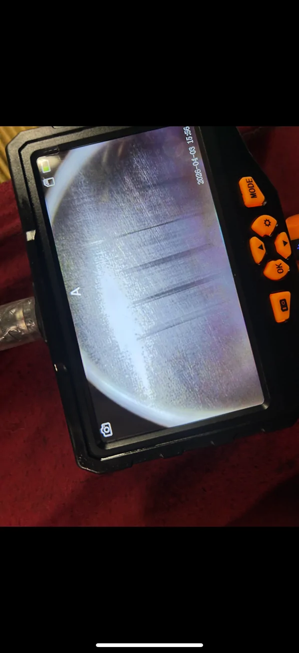

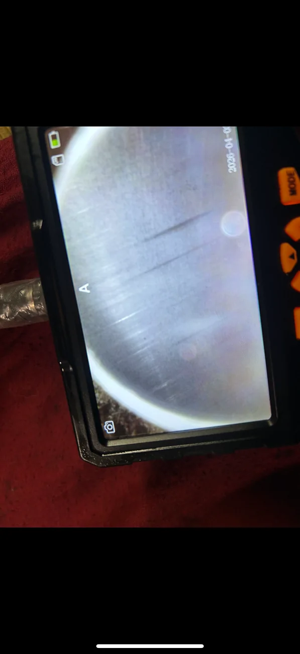

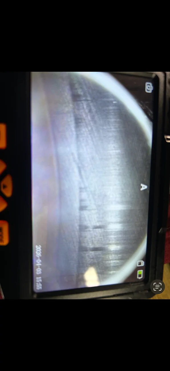

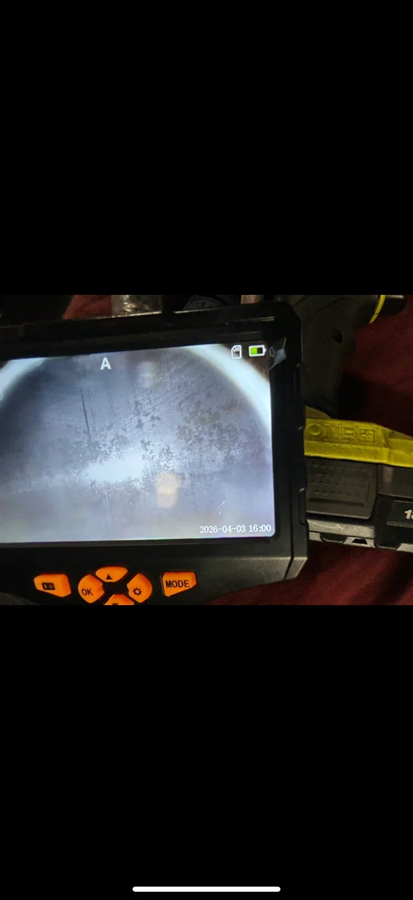

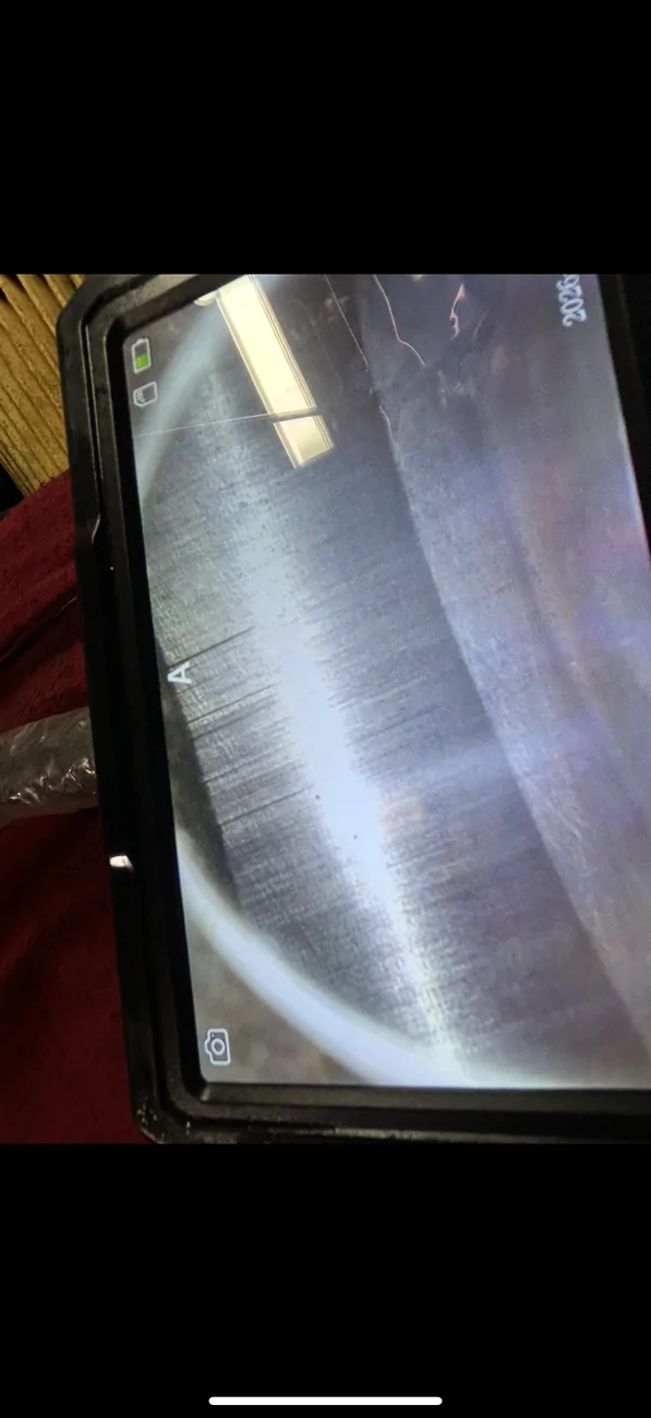

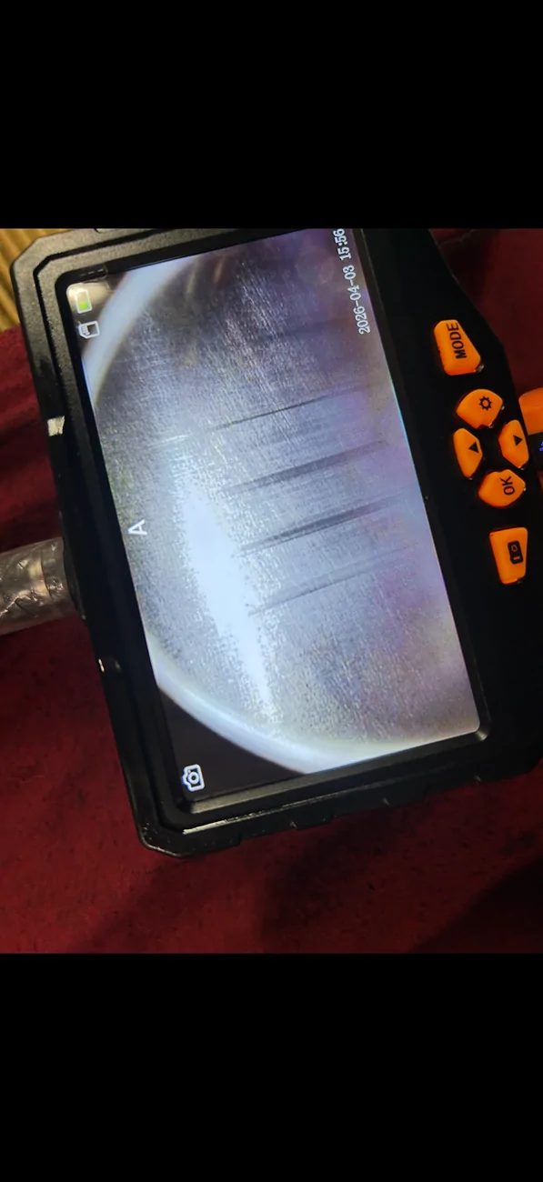

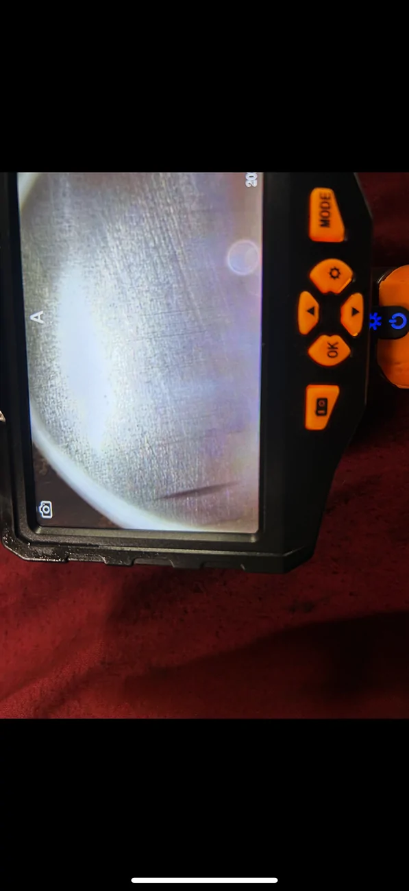

Update…
MY CAR HAS BEEN FIXED!!!
I went to GTR High Performance in Rancho Cucamonga. I finally found a mechanic, Ricardo, that was willing to actually give their time and work through the issue.
Not sure exactly what fixed the misfire as I did not do any AB testing. But here is a summary of things that was done.
1. Noticed the passenger side exhaust was loose and there was noticeable play. He fixed this.
2. Performed another crank relearn
3. Did a compression test results came back with a 10% variance… (210, 205, 210, 217, 217, 220, 220, 225)
4. Switched all spark plugs and the coil on the cylinder that gave a minor misfire
5. Checked the crank sensor
6. Borescoped the cylinders for documentation purposes to compare in the future
Thank you to everyone that helped me. Was starting to lose hope but this shop actually listened and tried to solve the problem. I recommend anyone in CA use this shop for any nuanced issues.
Still not sure whether to keep or sell the car. They did say we can monitor and if the cylinders start to show a 15%+ variance in compression, then think about selling. Their thoughts on the scoring was the same as others. Not ideal and can only get worse overtime.
As I understand, borescoping your cylinders is not a part of a routine check. How many of you have borescoped your cylinders and seen scoring similar to mine? Did the engine last for a while? Did the scoring eventually get worse?

Not sure what oil you use, but since you have scoring you should consider switching to driven dt50, or adding two bottles of ceratec to your oil to manage the scoring.
Scoring ?
How are you determining the difference between cylinder scoring and normal cylinder burnishing ?
