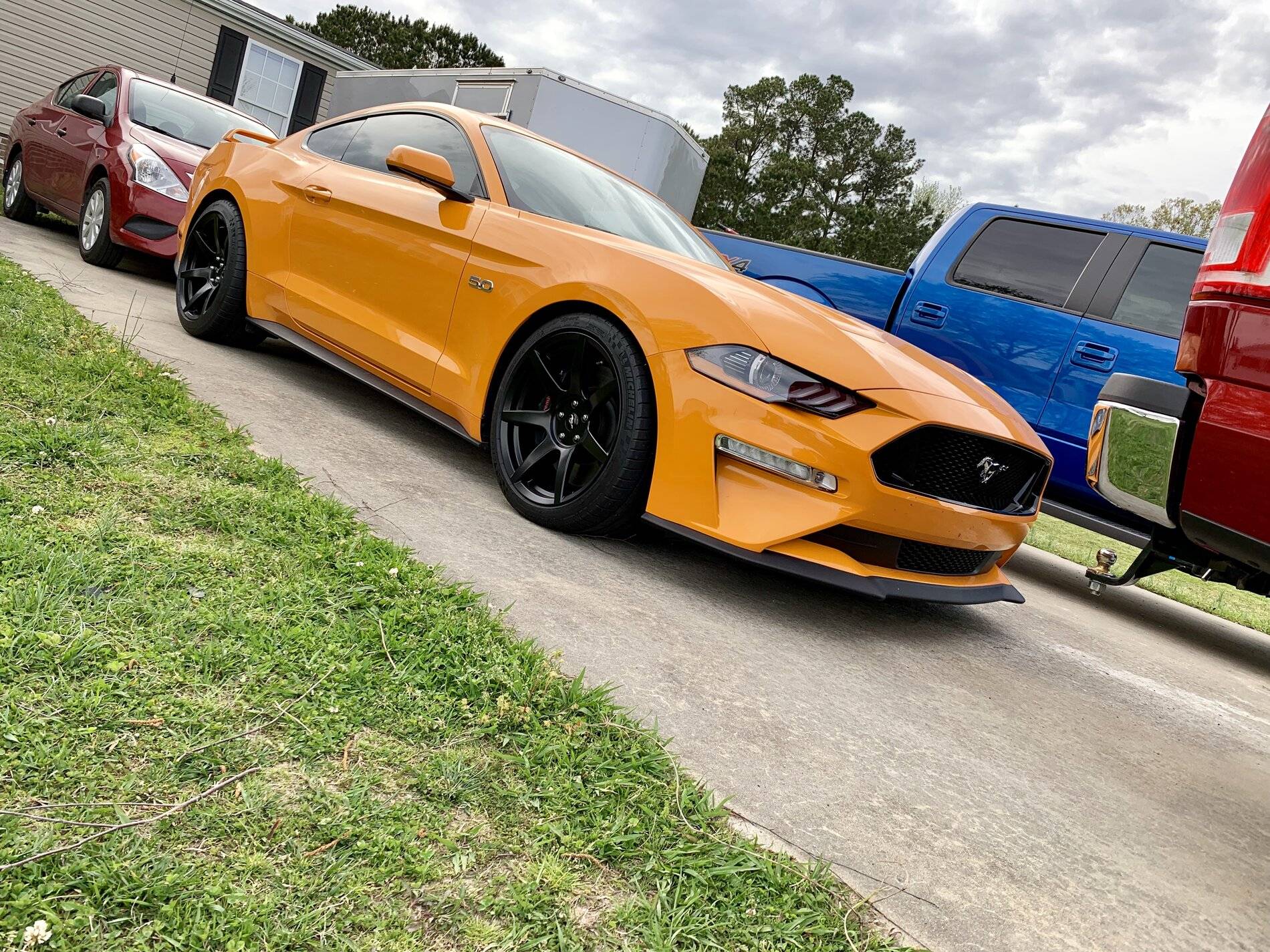

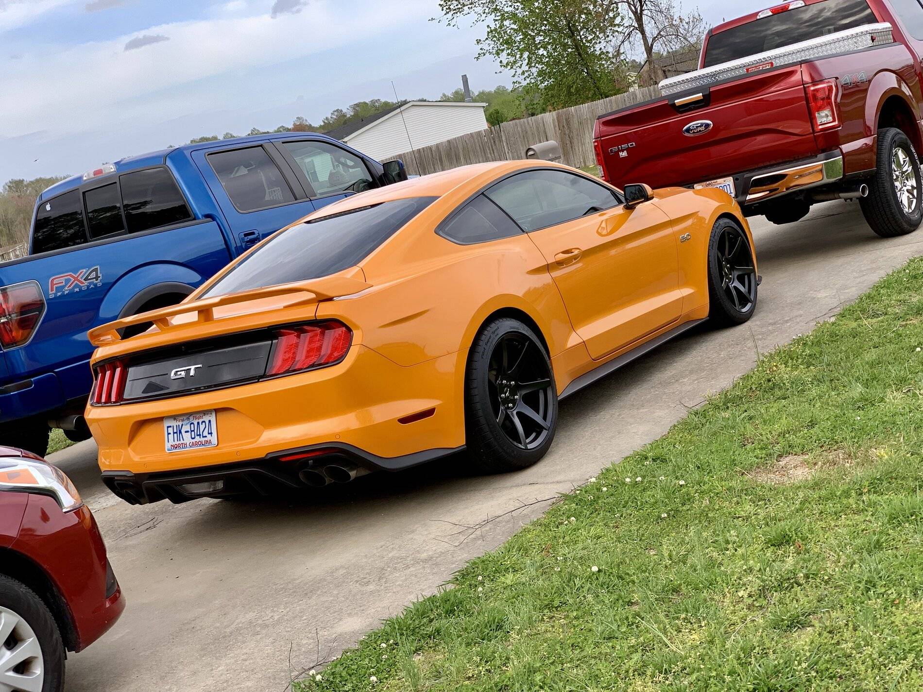

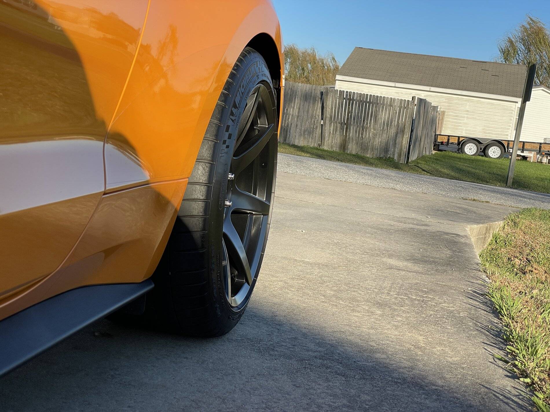

Square 19x10s, so 285/35 front and rear. No complaints, wheels are good quality and the satin black finish has held up well for the 4.5 years I've owned them.

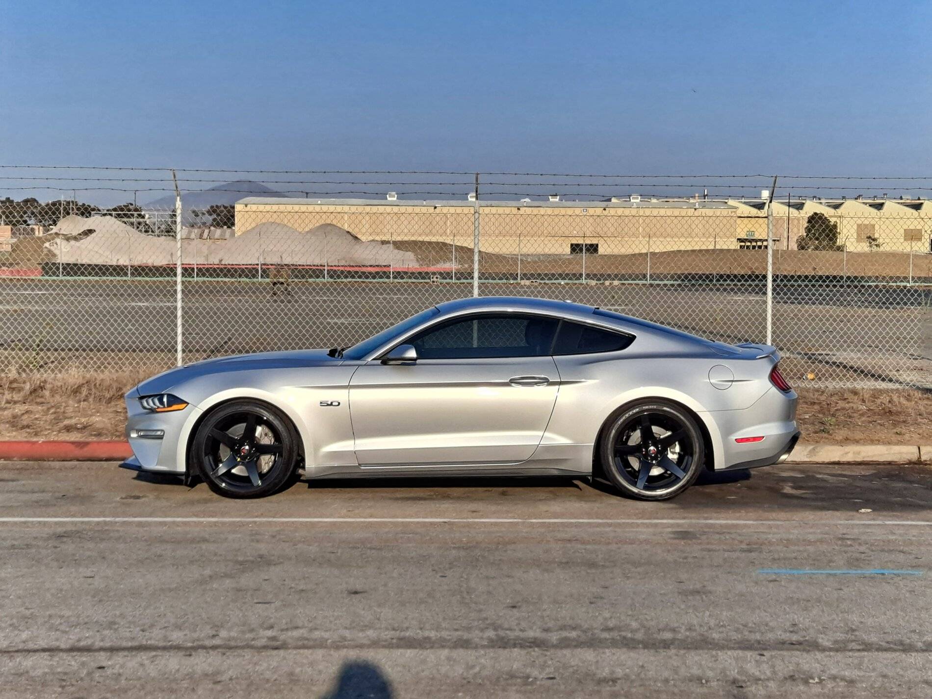

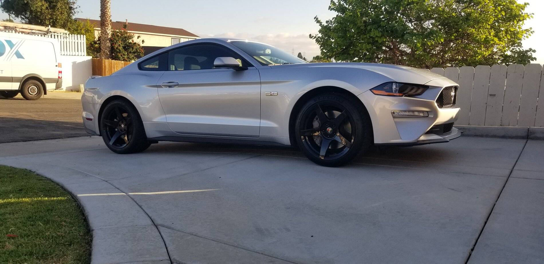

Bad lighting in first pic but 6gr 19x10 front on 275 40 19 mps4s and rear 19x11.5 on nto5r in 305 35 r19. Looking at 325 30 r19 mps4s or 345 30 19 mpss to replace reat tires. Car looks way better lowered on 1 inch springs

Sometimes I run a 5mm front spacer because I run more than typical front camber and have some extra fender clearance from that.

Not really. I think its marginal poke in the rear for stock alignments, but I'm running a bit of track camber back there so they fit really well.
On the front its really good for stock alignments. I actually run so much front camber I run an extra spacer on the front to get more flush.
