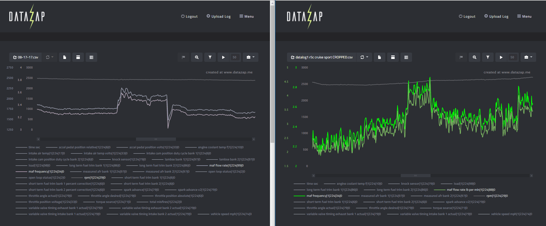

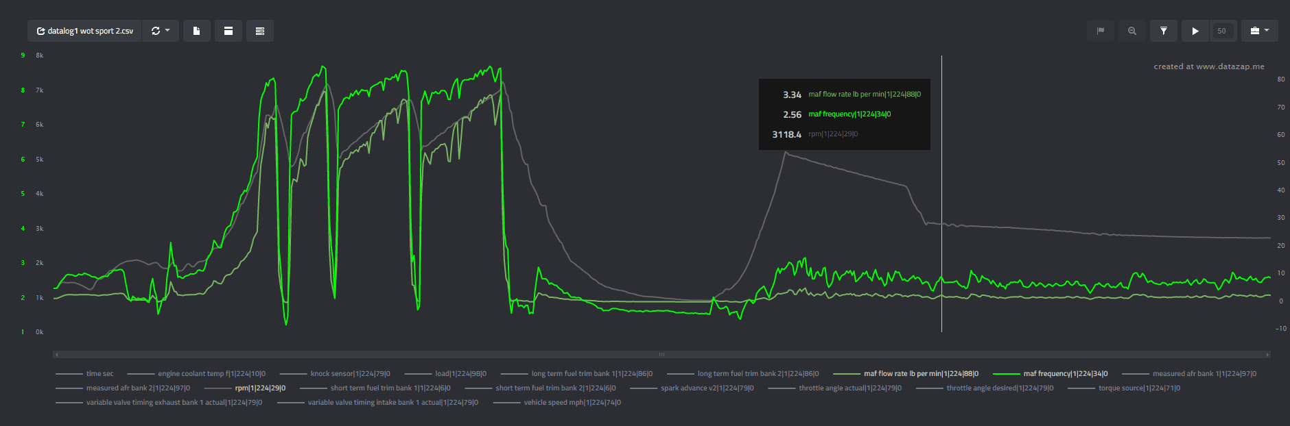

Your MAF frequency shouldn't be jumping around like this. Still very lean while cruising.
I compared a similar section to a car with a good MAF. The Frequency is Khz vs hertz so just multiply or divide by 1000. The Lb/min are the same. It will move around but jumping up and down 200 hertz is bad.
What could be done to correct this? Trying to determine whether a tune issue, or potentially a mechanical issue?

Check for damage to the Plug and wire harness.
Clean the sensor with some CRC mass airflow sensor cleaner. Spray the hot wire and let dry for a while. No need to rub it with a Qtip or anything. See if the frequency improves. If not replace it.
The frequency is a direct representation of airflow. So unless your engine has something causing some very ruff airflow this sensor is dirty or bad.
