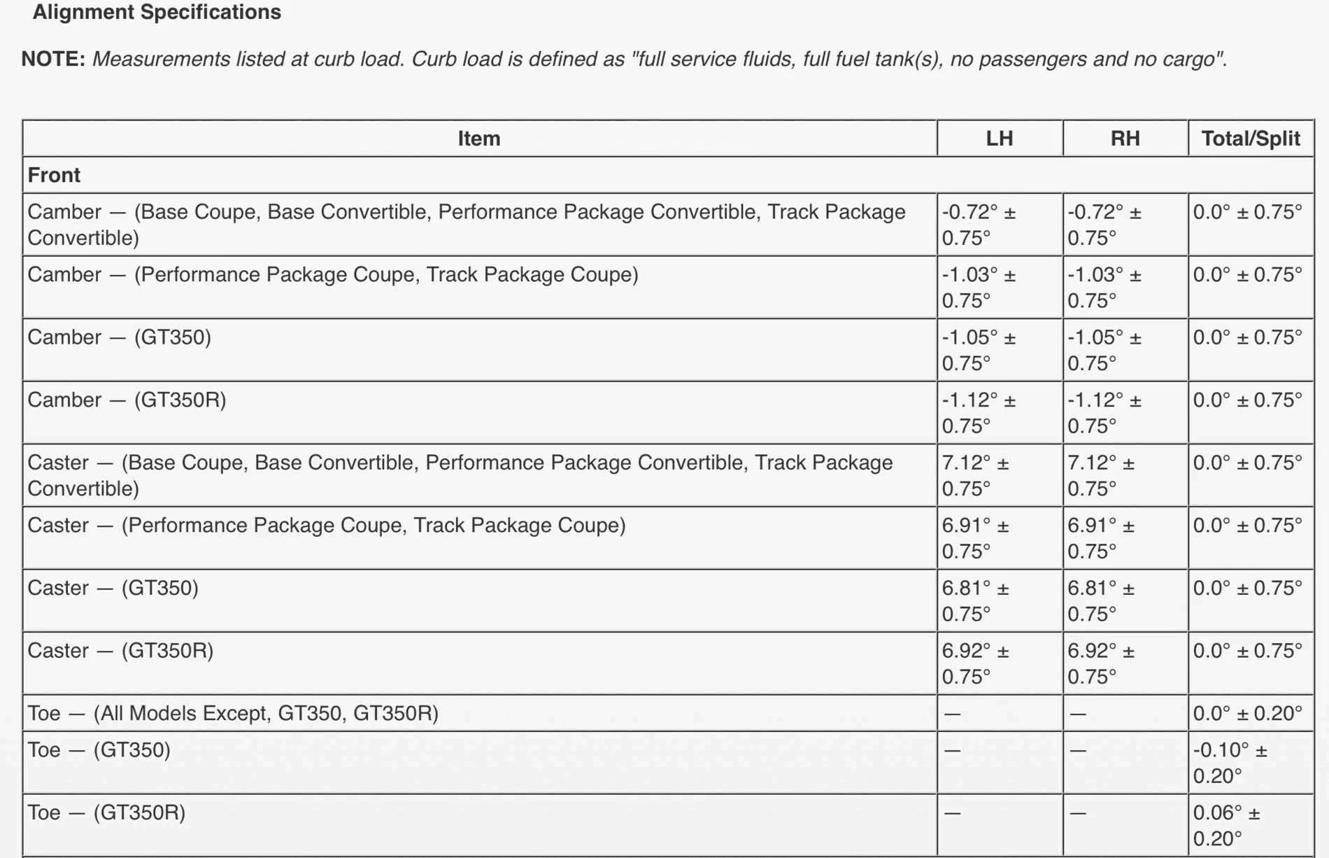

I'm pretty sure that Ford's preferred camber setting for a base car is closer to -0.7° front camber. There's a tolerance of 0.75° either side of that that'll still put the alignment readout "in the green", but for mostly straight-ahead driving and not too much in the way of enthusiastic cornering I'd shoot for -0.75° up to maybe -1.0°.
A little toe in is fine and may improve straight-ahead directional stability a bit. Ford's max toe in spec is +0.2° against a (somewhat questionable) preferred value of 0.0°.
