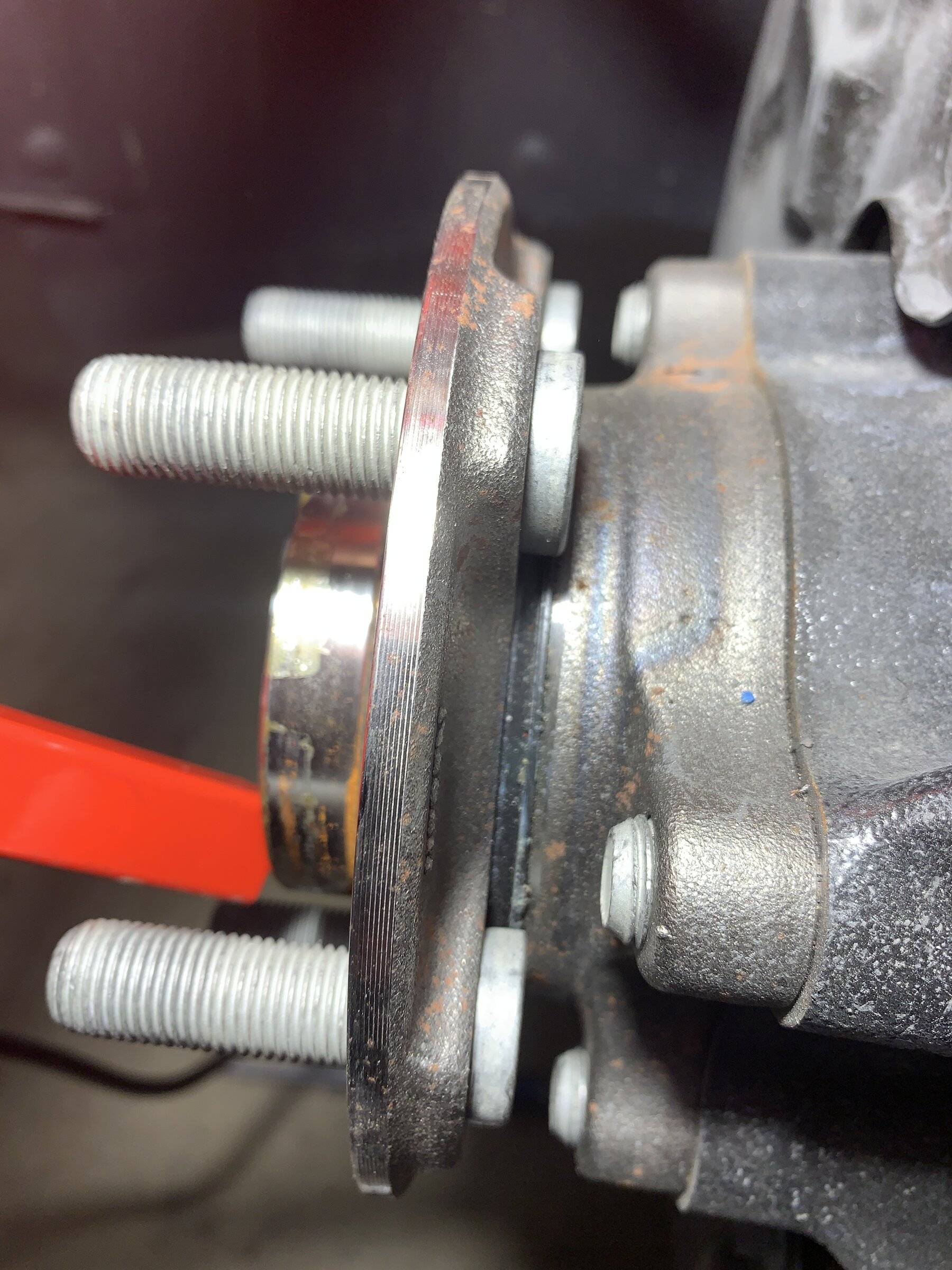

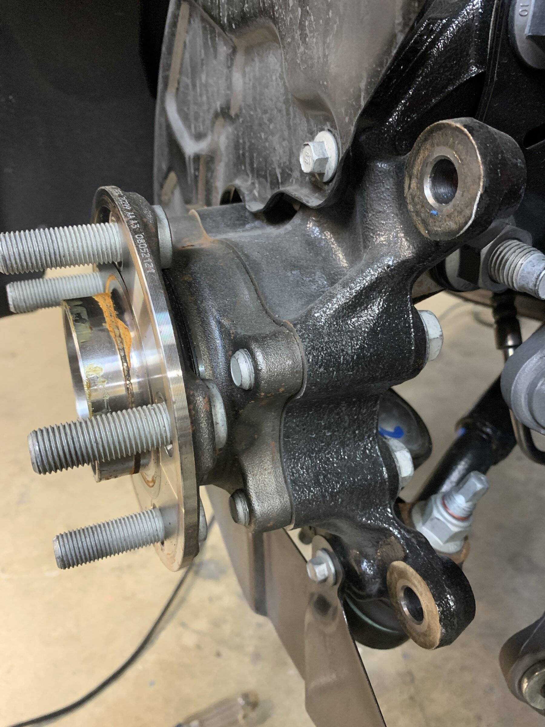

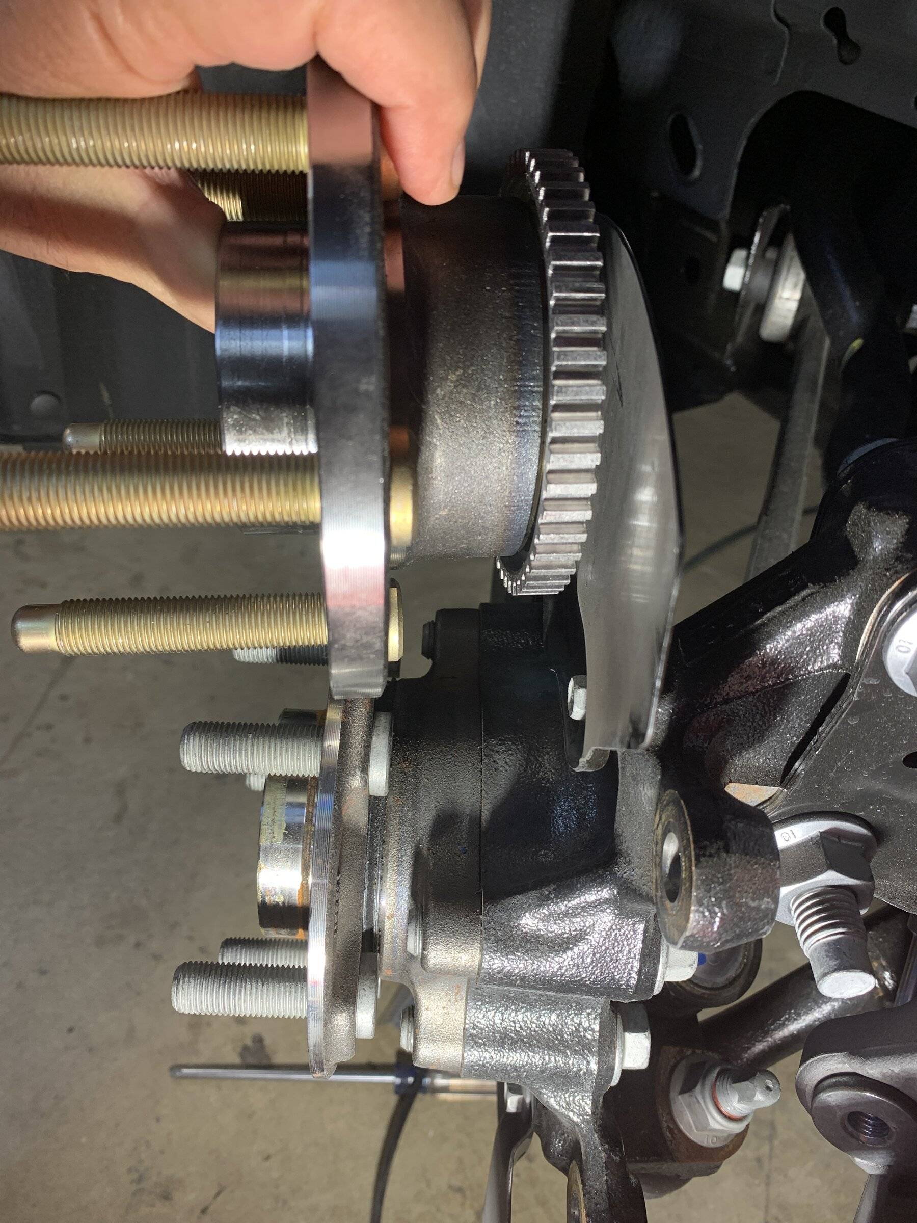

I have a 2021 GT Non-Magneride but it has the Magneride style front hub that Ford switched over to in 2021. My dilemma is this. I have a Ford Perf hub for earlier spindle steering knuckles, with the elusive ARP long studs.I was hoping to bolt them on but what a surprise when I pulled the wheel. I thought well, just put the long studs on the new magneride style hub but...look at the thickness difference between the plates the wheel bolts to. Do you think they are safe for track use with longer studs and wheel spacer/ sticky tires?
