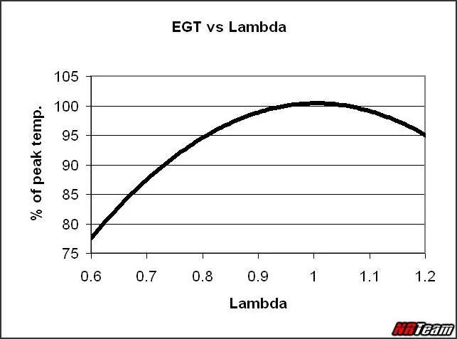

oesman
Feb 18, 2016
407
110
Houston, TX
Dmitry
2016 Mustang GT PP
Sounds like you need to lose the cats and turn off cat protection. It dumps fuel to cool down the cats since a rich mixture will be able to cool a lot better than a leaner mixture. In fact you'd have to go super lean for there to be enough air to cool down the exhaust.
