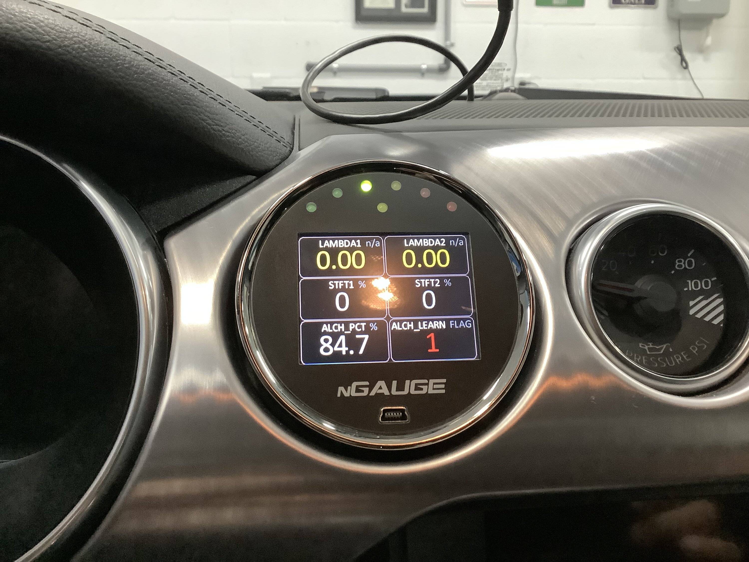

I don’t run a flex sensor, but that reading is for my flex tune. The way I understand it is, you can’t monitor it on the E85 race tune. That’s why I crosscheck my fuel.
Have you tried to see if you can select the Alch% signal from the nGauge menu?

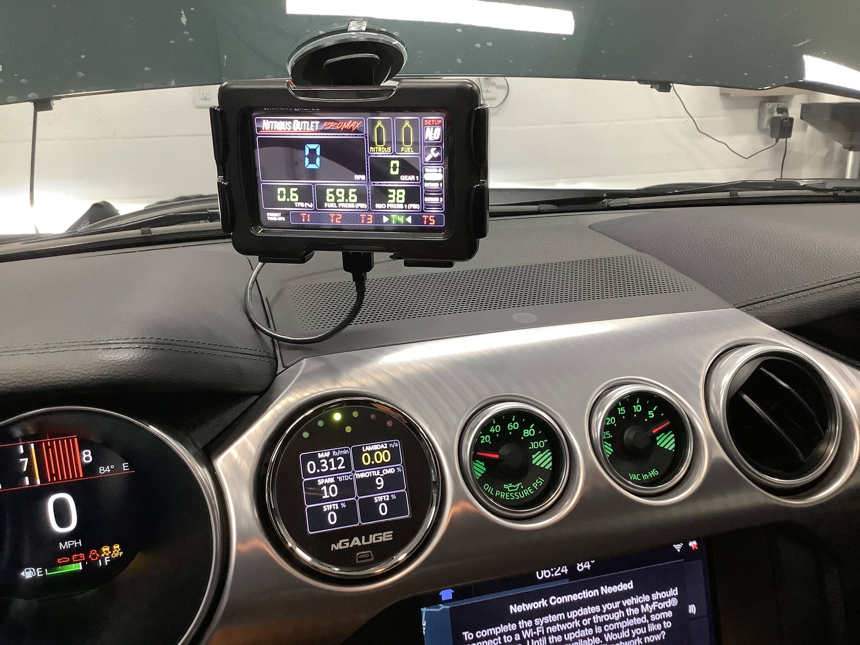

Here’s a pic of my screen after selecting MAF lb/min. signal to monitor when I was testing and logging information after installing a race air filter. Prior to this I had been monitoring Lambda 1 in that cell.

Ahh. I see. Its most likely because I have the E85 race tune being the reason I can't monitor. My N gauge doesn't even give me an option for Alch%. Thanks for the info.
