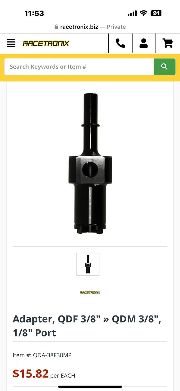

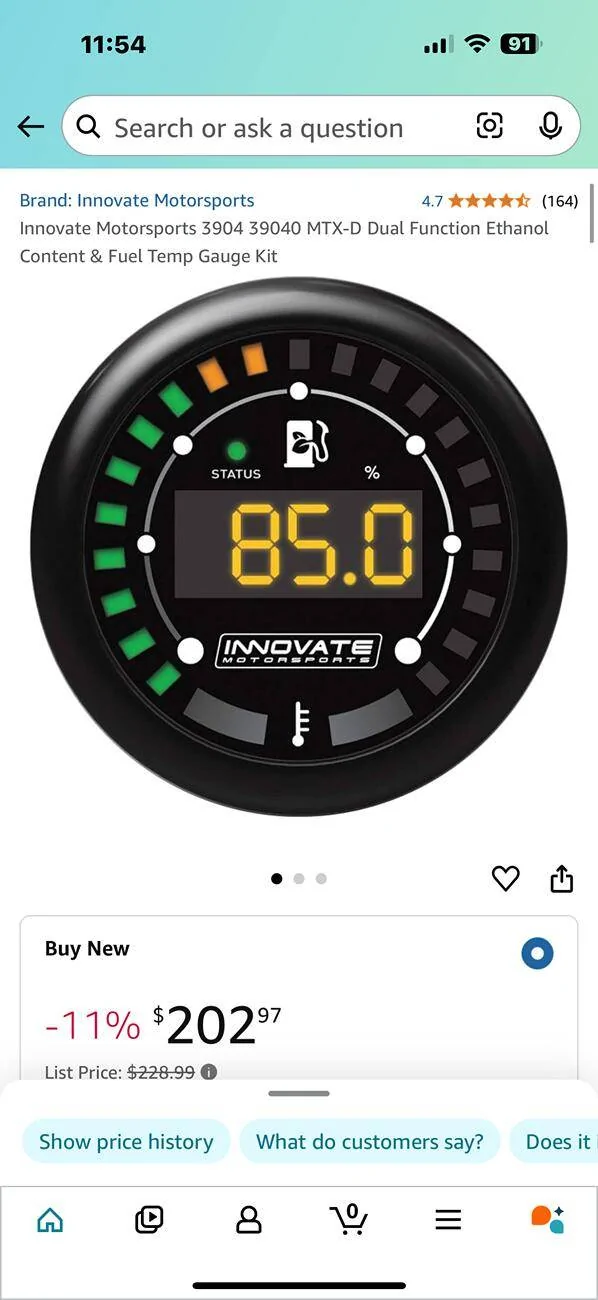

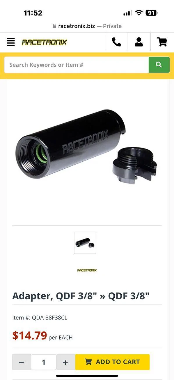

That is correct. You can use a kit like innovate Motorsports sensor and gauge and get some in line adapters from racetronix. I’ll drop some screen shots. Basically disconnect fuel line coming out of firewall and insert QDF to QDF adapter>E85 sensor>QDF to QDM adapter> factory fuel line going to rails. You will also need a 1/8 NPT plug for the QDM
QDF= quick disconnect female
QDM= quick disconnect male

I used this same gauge, tied it in on my return line under my car, works great. You can see changes almost immediately when filling up.
My uncle has the Fuel It setup on his new edge, also works great... I looked into it myself, I just like having the gauge personally and the fuel temp reading on the gauge is nice to have as well.
