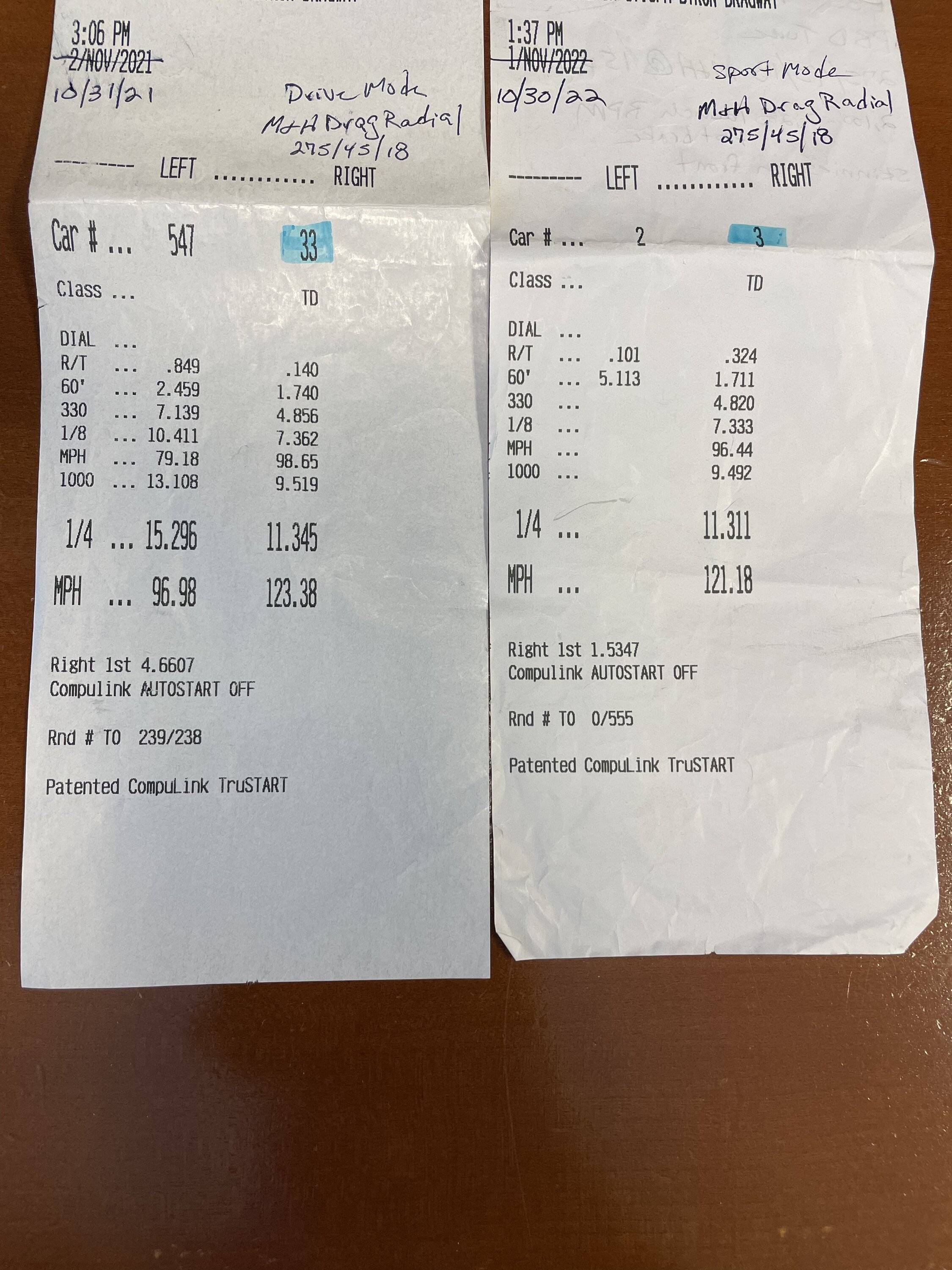

Ran the car last weekend. Trying to figure this out. Any help is appreciated. 2019 Mustang GT, A10, 3.55, Long tubes, hi-flow cats, JLT intake. Factory active exhaust. M&H 275/45/18 drag radial
10/31/2021
1.74 60’
11.34 et
123.3 mph
I made the following changes this year before running the car again:
Added 18x5 front runners
Steeda x-pipe
BMR vertical links
BMR Cradle Lock Out
BMR Minimal Drop Drag Springs
10/30/2022
1.711 60’
11.31 et
121.2 mph
Et improved slightly. Mph dropped by 2 mph. With the additions I thought I would pick up 1 - 2 tenths and maybe a mph.
Any ideas on why the car would slow down? Weather conditions were similar with the exception of higher humidity. Last year ran in 43% humidity, this year about 70% humidity.

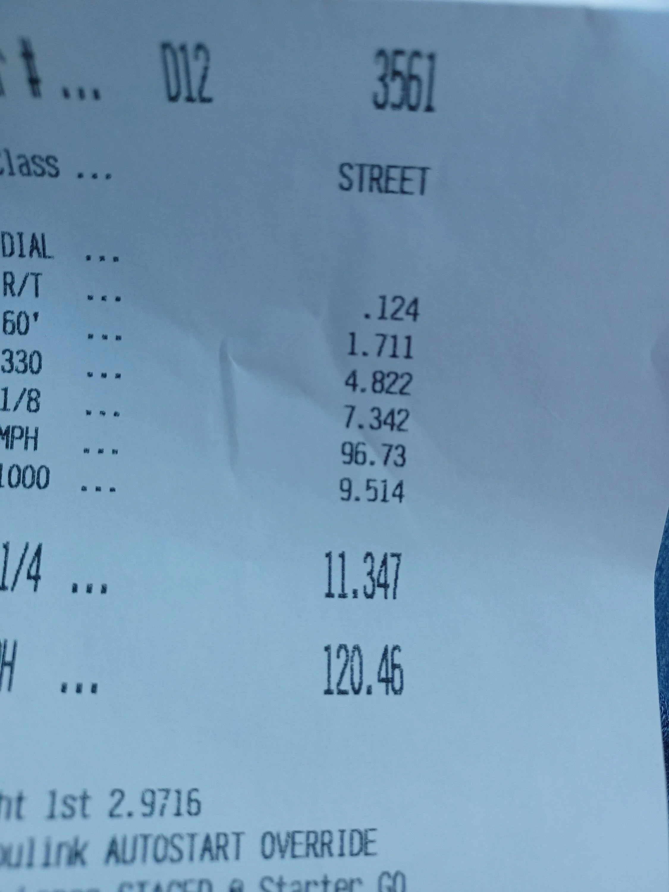

I think the reason the 60ft is better is due to front tire size.They may be a little taller which will increase roll out and give a better 60ft.Dont think the x pipe will give you much also.

Those are great numbers for running on gas. I have a similar set-up on E85 and ran a best of 11.18 at 126mph. The main thing is you improved your ET. I wouldn’t worry to much about MPH. I made 51 passes this summer and the MPH won’t always be your best ET….to many factors to consider. You’re headed in the right direction…..give yourself time to get a bigger sample size(more passes). Nice work👍

Thanks WoodburnGT and qtrmiler2 for the feedback. Here is a pic of the time slips for comparison purposes.
