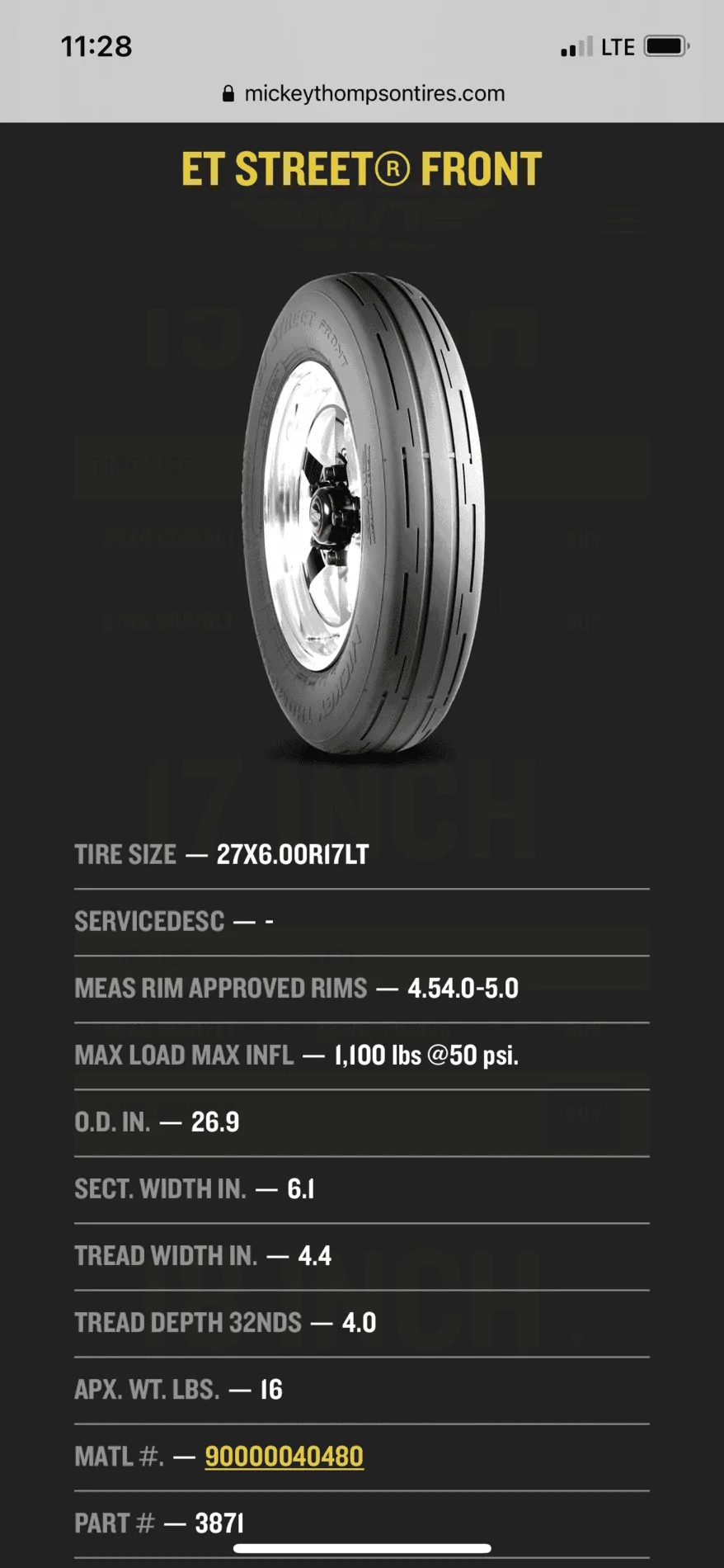

Anyone running these on the fronts, would like to hear some reviews on them. They will be on Weld Laguna 17X5. Car will see occasional track but mostly Hwy pulls. Also have BMR minimal drop springs I’m looking at 27X6 or should I go 26X6. Any feed back on these will be much appreciated.

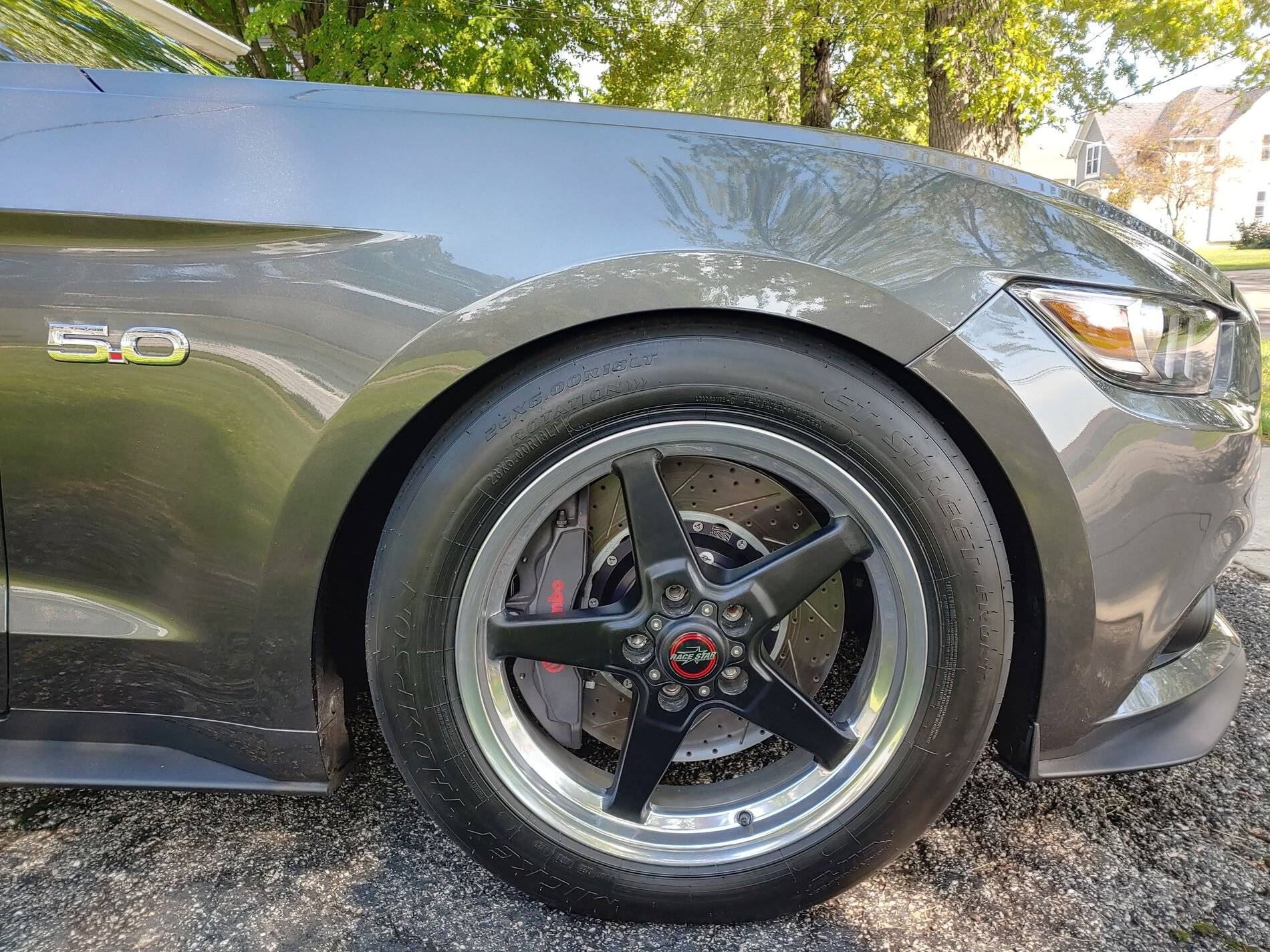

I have them in the 28” x 6” size for 18” rims. I think they recently came out with that size. It is a radial but the tread pattern is not suited for wet roads like the SR series would be. They are a couple pounds lighter though. I’m running BMR drag springs.
