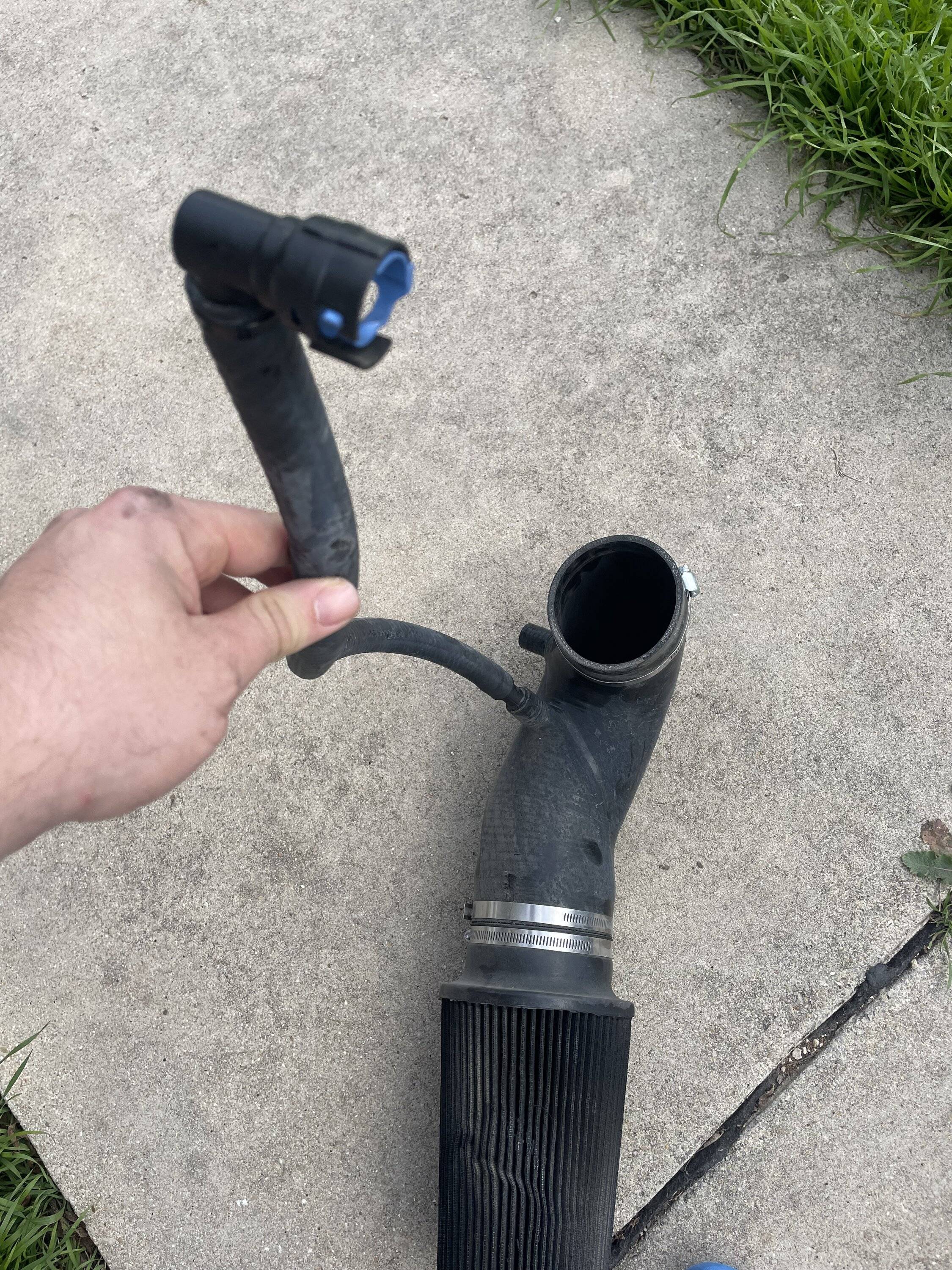

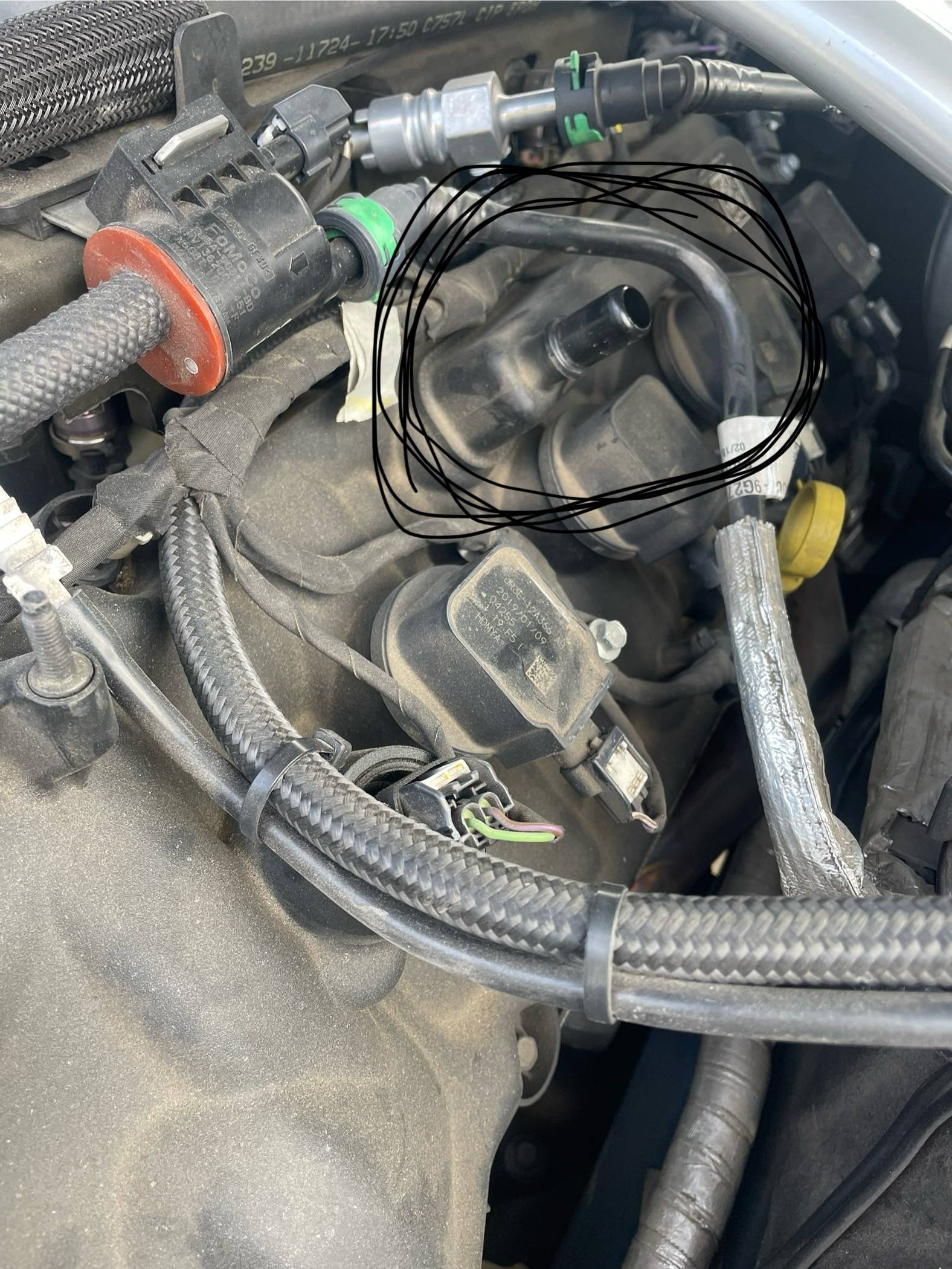

Hello everyone,
I am looking to change out the air filter on my ESS G3 supercharger on my Gen 3 coyote, I am going with the short filter that comes straight out of the supercharger (no tubing) I didn’t like that the filter was routed to the wheel well and it was getting filthy.
I already got the filter out , my question is what do I do with the Heater hose 5/8” that was running from the intake to the engine. Do I re route it somewhere else or do I plug the hole where it was with something?
thanks.

You need to run a Breather catch can from each of the valve cover ports, and block/cap the port on the intake Manifold. DO NOT cap the valve cover breather ports.

Sure thing. Just understand though, that when using the breathers on a forced induction setup, the filters will eventually get saturated with oil and can make a mess in the engine bay. A Vented catch can setup is a better solution, but obviously more expensive

The simple solution would be to put a breather filter directly on the drivers side valve cover port. If you have your passenger side catch can plumbed to the OEM connection behind the throttle body, then the drivers side port is the "intake" portion of the PCV system, so you want that air to still be filtered before it goes into the crankcase.
