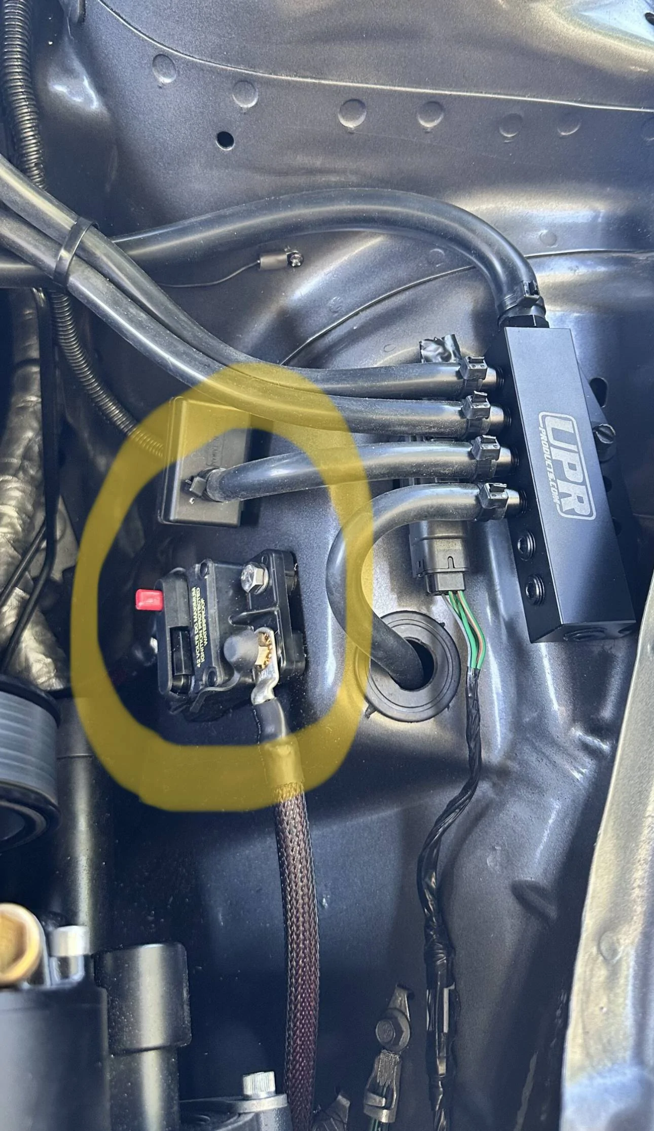

Are you talking about this?What is that ground lug next to the vacuum block for?
Yes sir!Are you talking about this?

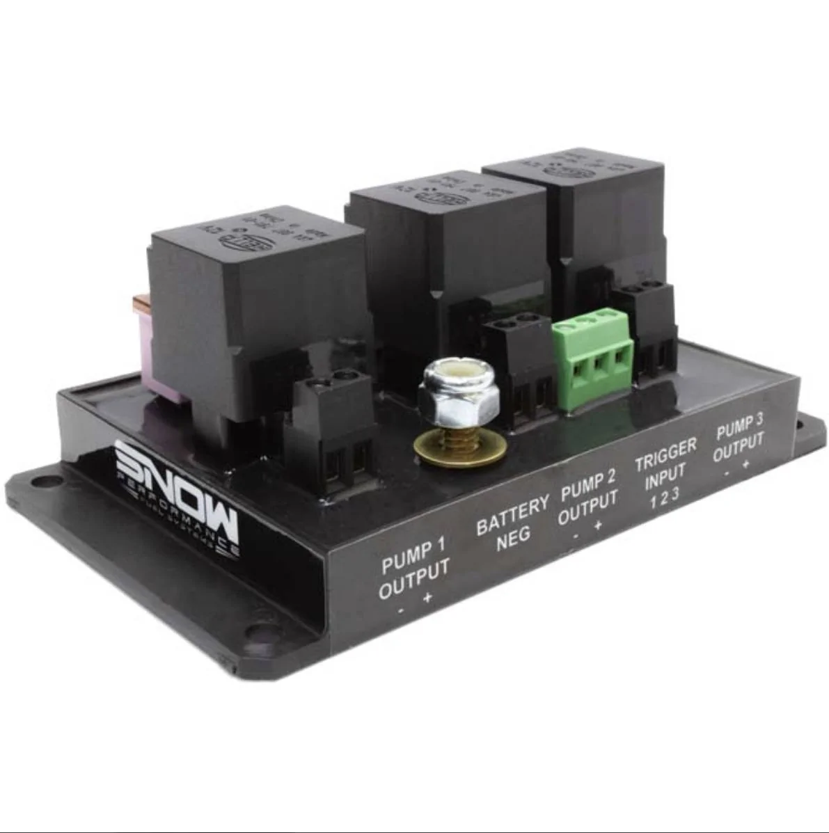

That is my 150 amp circuit breaker that goes to my Snow multi pump relay module that then runs my triple hellcat fuel pumps!Yes sir!
