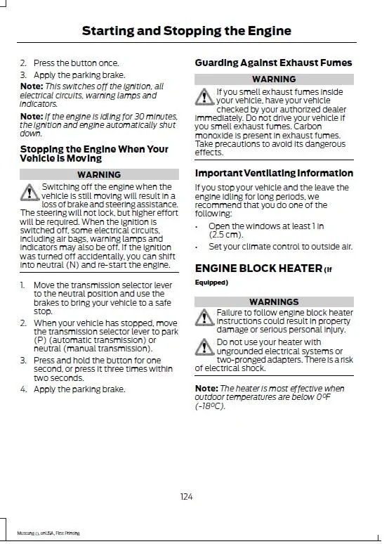

Did you not see the page from the manual that DevineStrike posted? Go back a page in this thread. Find the picture and read the section called "Stopping the Engine When Your Vehicle is moving."
Yes, I read that page. Step one is to stop the car. Hence the confusion.

Alright, who's got a new Ford with push button that's willing to take one for the team?? Would you mind just getting her up to about 60 and then pushing your engine start/stop button for us? That would be swell.
OK, we just tried this with my wife's Focus ST. Driving along, it took a button press of ~ 1 second (just tapping the button did nothing), but the engine does turn off. We still had steering and brakes and were able to pull over safely.
After coming to a stop, setting the parking brake and pushing the button again, the engine restarted, probably because my wife had the clutch pedal depressed.
Did it again, and after stopping the engine, pushed the button again while the car was still rolling with the clutch pedal depressed. The engine restarted and we drove on normally.
So I guess that I read to much into the info from the manual about this, and I believe my comments about an intermediate state to have been incorrect.
We did this wile driving at ~ 25mph on an empty access road. Sorry, wasn't willing to do it at 60mph. lol
